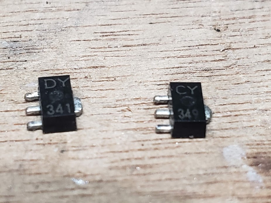

mnhiphop101 Member Joined 2011 2019-11-02 7:47 pm #1 2019-11-02 7:47 pm #1 looking for the part # for these. I pulled them from a kx1200.1. Attachments 20191102_144021.jpg 120.6 KB · Views: 81 PapaZBill Member Joined 2013 2019-11-02 8:24 pm #2 2019-11-02 8:24 pm #2 Transistor marked CY - ktc4373 Transistor marked DY - KTA1661 T twilliar Member Joined 2019 2019-11-02 9:38 pm #3 2019-11-02 9:38 pm #3 Isn't the DY also a 2SA1201 PNP? Last edited: 2019-11-02 9:43 pm You must log in or register to reply here. Share: Facebook X (Twitter) LinkedIn Reddit Pinterest Tumblr WhatsApp Email Link
