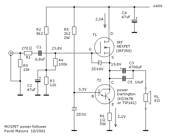

does any one know how cud i build a driver stage to power pavel marcura's 17w mosfet amp with even higher input capz.....
im running my music of the computer.... do i still need the drive stage?
here are the schematics
