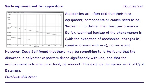

D.Self himself has published data about distortion changes in mylar caps in the Linear Audio Volume 1. After they had run in over night the distortion droped in half. Polypropylens did not show that effect. The distortion reduction was semi permanent. After some 90 days off duty the distortion came back somewhat but the cap needed less time the second round to drop again in distortion.

I assume you got your Linear Audio Vol. 1. It has a bit on capacitor burn it. I didn't know you considered that a volatile topic. (But I am not sure if D. Self is fat! sp!)
There are just some issues I though were usually recognized such as, tubes age, electrolytic capacitors dry out, wax paper capacitors are subject to humidity as are some plastic ones, iron is magnetic, electrets fade with time. etc.

The new paradigm, "bate" and switch. Doug's numbers are at 9V AC across the capacitor. In an RIAA network you would rarely be over .1V AC and since the distortion goes as the square of the voltage we are back at -140dB numbers.
Who's theory? At best 10's of micro-degrees and considering the encapsulation, it would take hours or even days to equilibrate the humidity. The parallel resistance is listed at 30G Ohms or so so the ESR would be the major heat source. With RF caps resonated in 1M Watt transmitters heat might matter. The numbers are easily computed here and there is no way .00001 C temp rise drives out water.
Also it's not like Doug is doing an HTOL on these, they sit at normal room conditions and relax back a little. You guys could soak one under water and see what happens.

BTW my smoking gun on this is the high DA of Mylar. The voltage coefficient of capacitance could be getting changed by the AC voltage stress. Dupont has lot of info on Mylar on line.
EDIT - Anyone who reads that paper will never use Mylar capacitors again.
