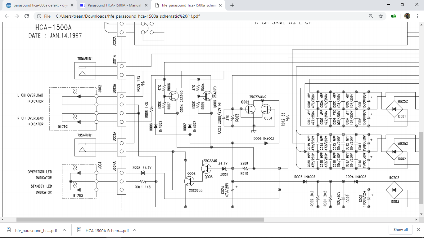

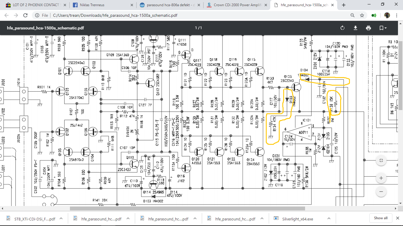

I been trying to study the schematic on a hca-1500,
its look similar to mine.
It seems to have the same input and o/p but just less output transistors.
so I will try to use this,
and as you see in orange and red marks,
that the sense emitter resistor of the over current protection.
if im not mistaken.

found the problem With q005 was defekt, after replacement it Works good and no over current problem 🙂
