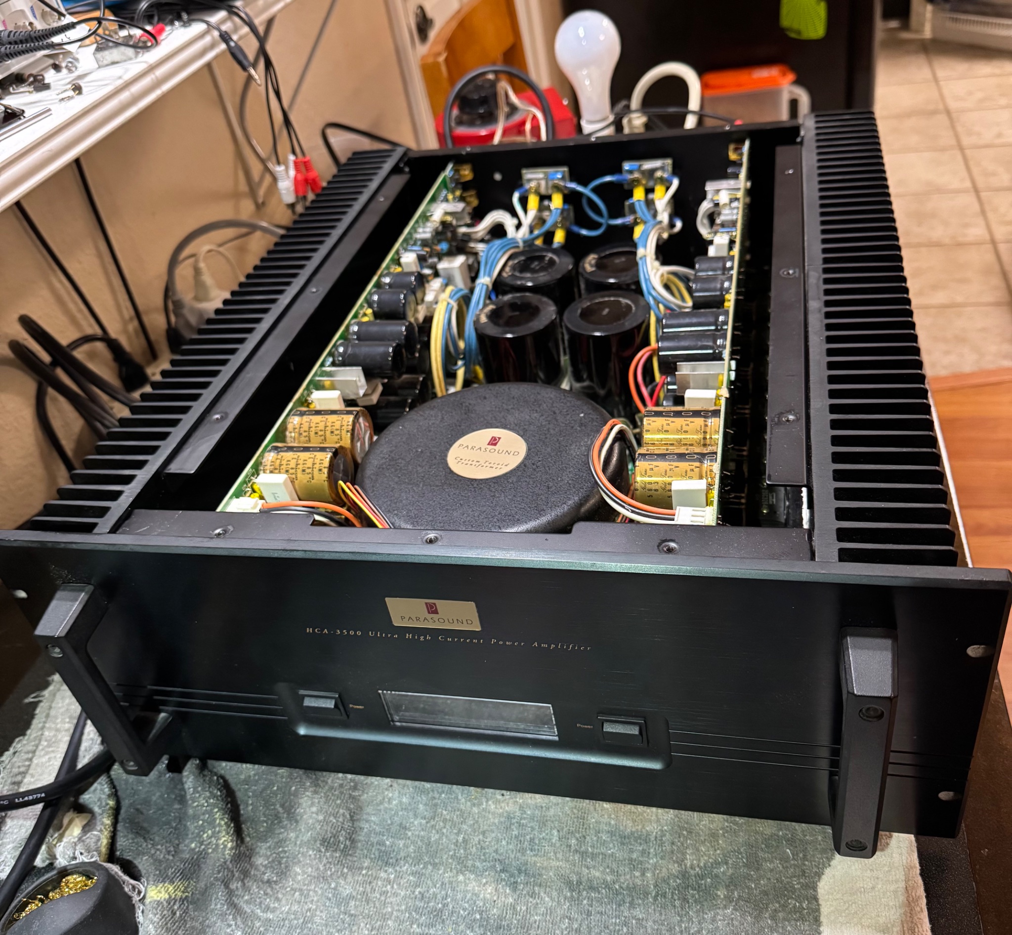

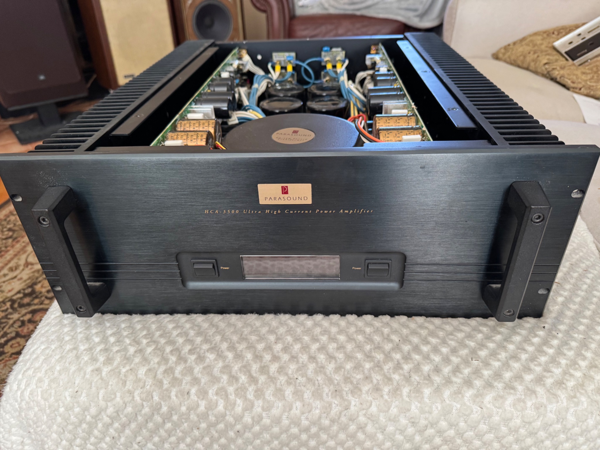

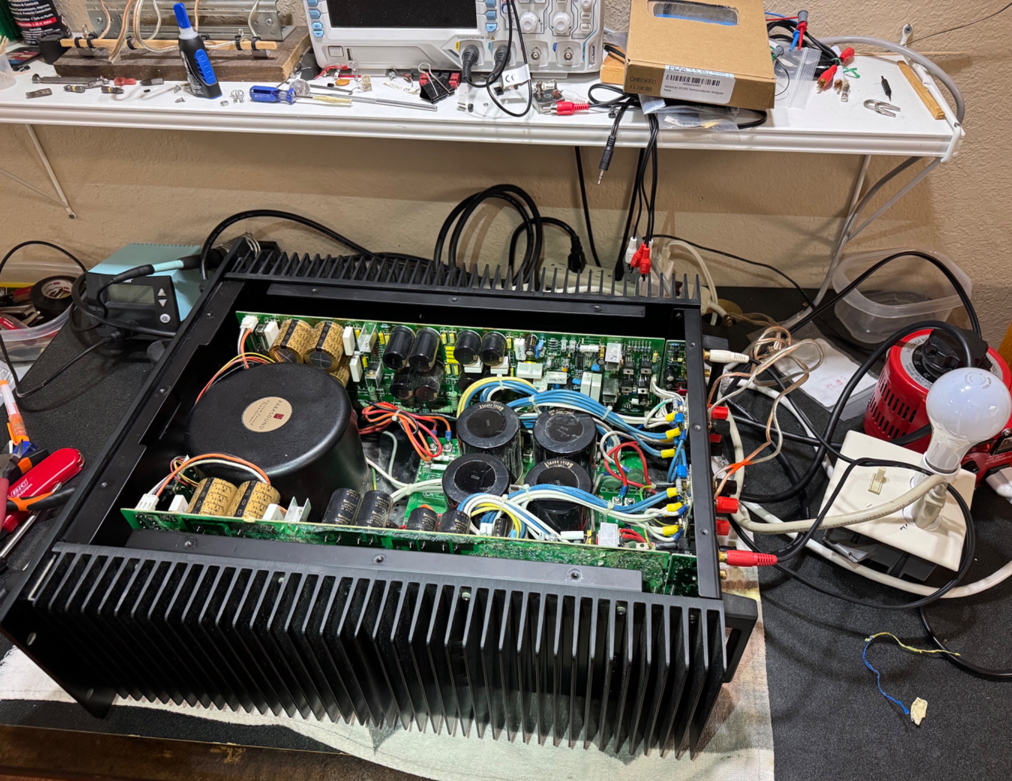

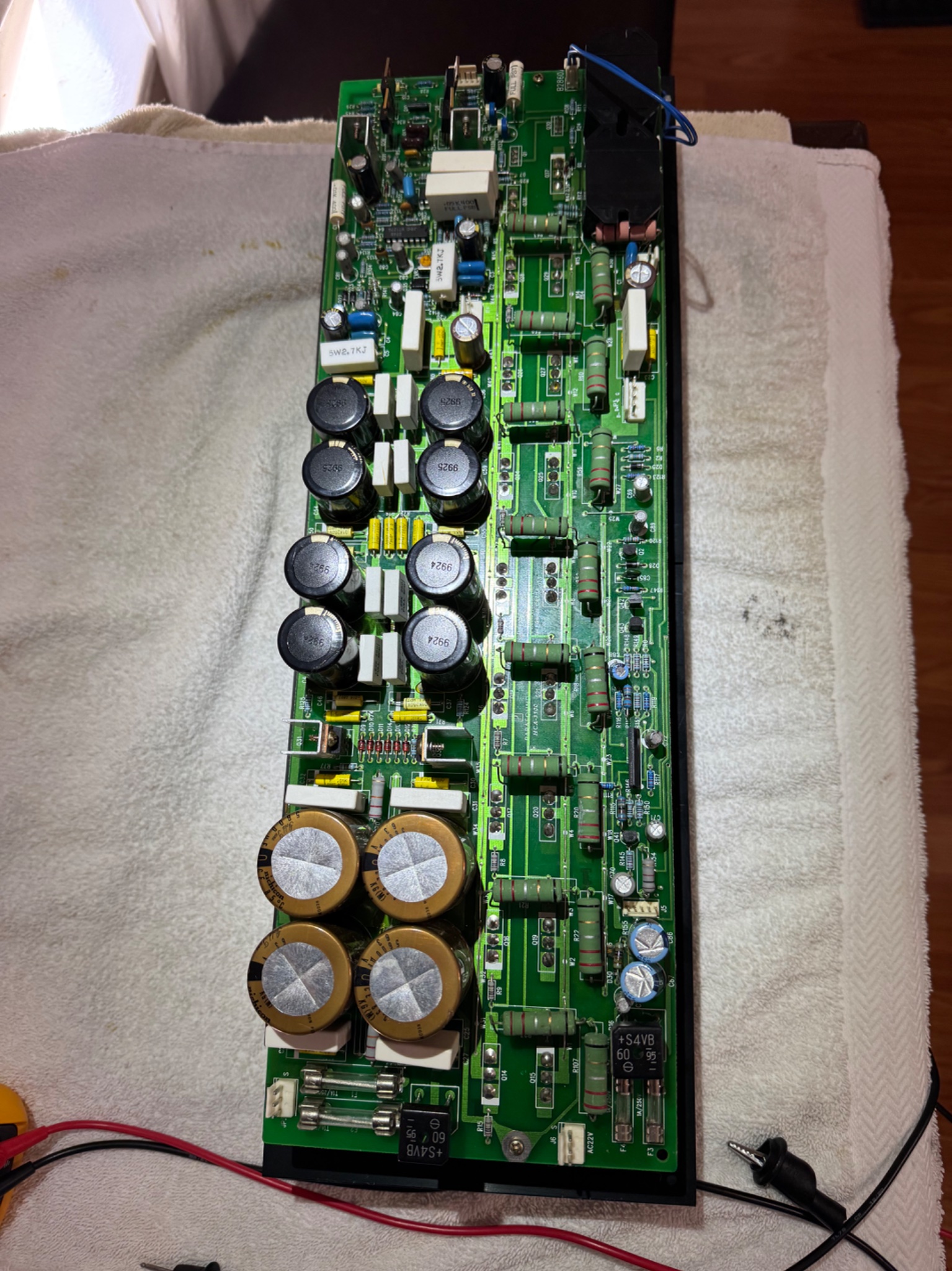

New to diyaudio and my first post, thanks in advance for any help and advice. I just picked up a Parasound HCA-3500 amp with L channel out and was hoping for an easy fix. After doing some research and basic troubleshooting, I discovered all of the Sanken 2SC3264/2SA1295 outputs (MT-200) are testing blown in circuit. It looks like there are no longer new replacement outputs available and only a small number of working ones are out there on the used market if you can find them. Did not know this when I took it on as a repair project.
I removed 2 of the 2SA1295’s and one tested bad and the other good, though both tested bad in circuit, so probably need to remove and test all to truly know the extent of the damage to the outputs.
I am not sure if this is a restore I would want to take on considering the discontinued output transistors/lack of good sub and the complexity of the design, and I am just a vintage restoration hobbyists with a couple dozen or so repairs/restorations under my belt and not a trained technician. I am thinking of passing this amp on to more qualified hands but just wanted to check with the group first if anyone has experience with this type of amp with output transistor issues and advice on my predicament?

Of course this is just the first issue, if I decide to take this project on then I have to figure out what on the driver board blew them out to begin with.
If one output is blown on a channel, al the outputs go and are replaced with a matched set. Also the drivers, always go one stage back from the last blown one.

All sixteen output devices are blown ? - unbelievable
I know, I need to unsolder them to confirm, when removing the first couple of 2SA1295’s in line after the Q38 transistor (2SK1530), the first one was shorted on all legs and the second one tested fine. I will need to unsolder and number them to keep them matched to assess how many have been shorted. I am hoping maybe the first one in line shorted and the relay did its job to protect the rest of them?

When the output section is stressed past it's collective SOA, one or more may fail short. The other polarity is now subjected to a direct short to the opposite supply and the voltage amp section does it's best to maintain zero DC offset by doing what? Turning the other polarity on as hard as it can, so you have transistors fighting a wire to the opposite supply.
Do you think this is good for those transistors in any way? Generally the transistors that didn't outright fail then have their characteristics changed, and some may fail short later. The driver transistors were also operated well beyond their limits. They suffer the same changes and may fail at a later date also.

It's good to figure out what you're in for first. I doubt strongly the sound will change, but you may have to compensate the amplifier for HF stability again. Any time you change output or driver transistor numbers on any amplifier, you need to check HF stability. I can't speak to those capacitors shorting. I generally measure capacitors using an HP LCR meter. If DA is high, or capacitance is low, out they go.

BTW, D35 zener 30v reads in both directions and R46 smoked a little when I was running it on dim bulb for just a min before finding shorted outputs, but the L channel never came out of protection or lit the bulb, so assume outputs were shorted already when I got it. But based on your last posts, all of those transistors tracing back from the shorted output may have been compromised and should be replaced. I am feeling more comfortable with this restoration, I would rather error on the side of caution and replace suspect caps, transistors and diodes since they are usually relatively cheap.

Yes, always replace one stage past the last dead part. If you have a BJT differential pair, you need to replace those with a closely matched pair. During a failure you often get a large DC offset, that reverse biases one input transistor junction and damages it very often. I designed a jig for that decades ago and later gave it to this community. Several PCBs have been designed for it. It is a beta matcher and matches transistors exactly, easy to use and not an expensive thing to build.
