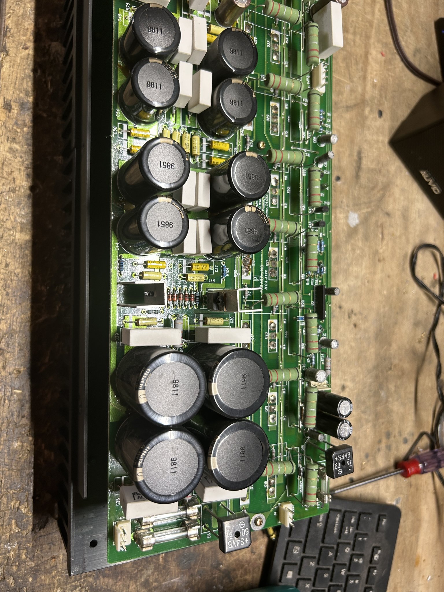

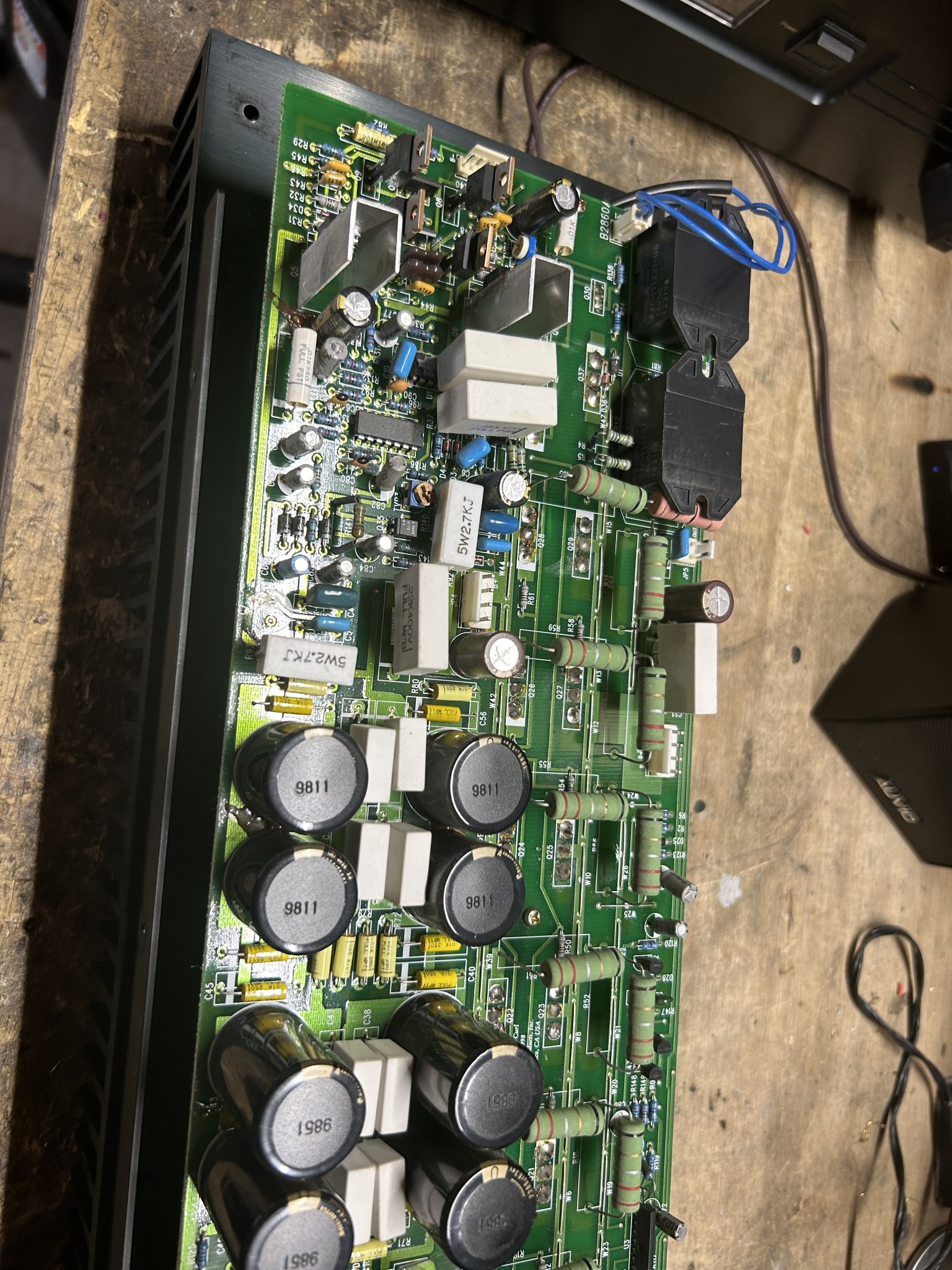

Yes. Back to 3mV. Give or take .5mv.
With signal i set the left channel to match the right at 14.6mV. Should I go ahead and just bump this up to 20mv?
The only equipment I have to play a 1khz sine wave is from my computer directly into the RCAs. I don’t know if that is sufficient enough.
Alignment: TVR1 (idle bias) = ~4mV (+/-1mV) DC across R51 (or any of the .22Ω emitter resistors) with top cover on. Increase idle bias to ~20mV (+/-2mV) if dynamic bias circuit disabled. TVR3 (dynamic bias) with a signal applied for ~20mV (+/-2mV) DC with top cover on.

I was looking at how easy it would be to recap it and I know how to unplug the heatsink and board completely… but there is only a 1 inch gap between the heat sink and board. Can the aluminum block where the mosfets mount be detached from the actual heat sink?
That would make it very easy to recap and make changes.

I did start making a part list to replace all the electrolytic caps and a few resistors recommended by Big Sky Audio. Most of the upgrades appear to be easy part swaps; I’m just confused about a few notes but I think I’m going to start a separate thread to document the recap and ask some questions about the mods and parts I couldn’t find. A lot of capacitors are removed on the upgrade list but aren’t replaced.
C7, C8, C12, and C13 are already Rubycon Black Gate so I’ll probably leave those in.

The bias adjustment instructions are correct. TVR1 sets idle bias. Leave TVR2 alone unless you cannot get 3-4mV with TVR1. TVR2 is more of a coarse adjustment. If you have to adjust it, be very careful and only a slight amount.
TVR3 sets the auto dynamic bias. Just a low amplitude audio signal is needed to trigger it. The dynamic bias circuit reduces amplifier high bias to conserve energy and reduce heat for extended periods when no music is playing.
Keep the Black Gates and do not replace them. Upgrade sheet does state that they may already be BGs.
