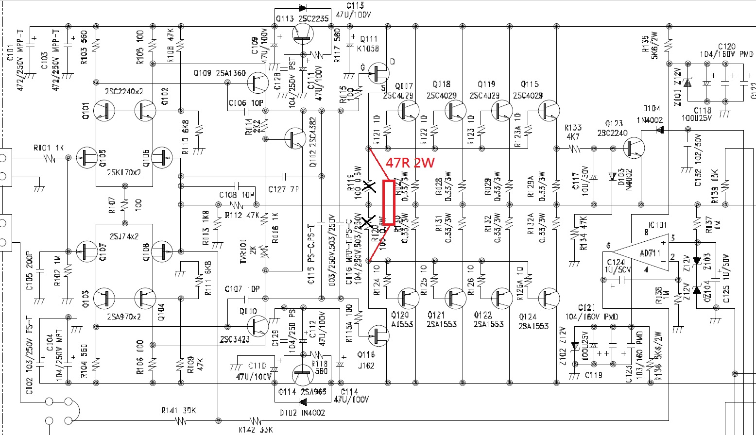

I have a HCA-1500 with bad left channel ... shorted output drivers ... so it's time to go ahead and do a recap at the same time. I'm having a shop do it, but wondering if there are commonly accepted devices that are worth considering an upgrade.
The power supply specs on the Parasound site are 60,000uF (Nichicon), but my unit must be later in the production line, as it has a higher rating of 80,000uF (Elna).
I notice that Wima film caps seem popular, sometimes in place of electrolytics, so I'm wondering how this decision is typically made.

Any body done a rebuild of their HCA1500a? I have bulging power caps. The amp is working fine but I'm thinking of going through the all the electrolytics or building a class d?
This amp's circuit design is good. Upgrade with normal recap, replace resistor is OK.
If we change a higher driver current, you will have a more warm, dynamic and punch bass performance. To do that, remove two 100R resistors R119,R120 and replace a 47R 2W connect between two driver transistors. After mod reset bias.
