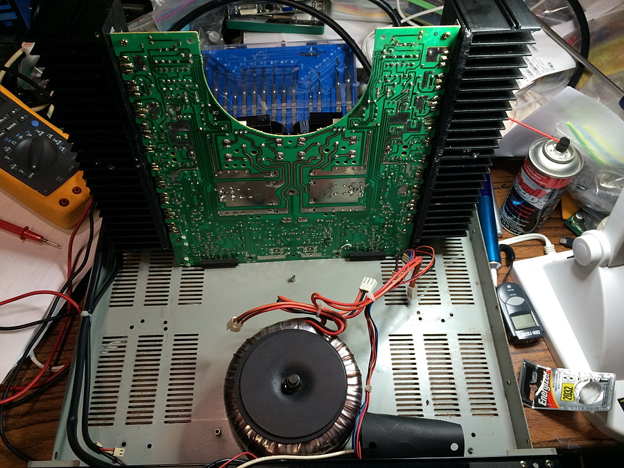

I should read owner's manuals more often... The recommended ventilation requirement without a fan is: If you are not using a fan, allow at least six inches on each side and above the amplifier, and do not close off the front with a cabinet door or panel. Or use fans.
Mr. Curl, I had good fun getting this amp up and running again and it really blew me away when I put it in my main system. I am using the Parasound C/PT600 for a preamp for now and am looking to replace it with PHP-850 or one of the PLD-xxxx.
I found a few 12V dc muffin fans in my collection of stuff that I may put to use. Ultimately, I want to locate the amp remotely in my basement where it stays nice and cool. I need longer interconnects for that though and to build a shelf.

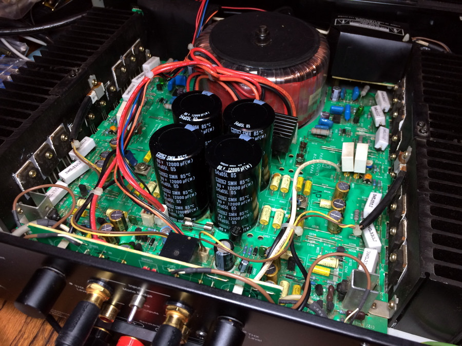

I just got one used and out of the box it was great - then I re-capped with matched capacitors+ - .01 percent, as I do. Then by-pass with .5uf polystyrenes. Well, what a piece of gear this amp is, air, imaging, neutrality, dynamics, on good material (musically, not engineering wise - I think it is the ultimate best buy. I've listened to some expensive new stuff lately (which I could never afford by the way), and real amps not Class d, and this amp is easily in their league. John is a master, we know that, but like Pass he does it for the the people who need affordable as well. Thank the stars for democratic audio designers!
