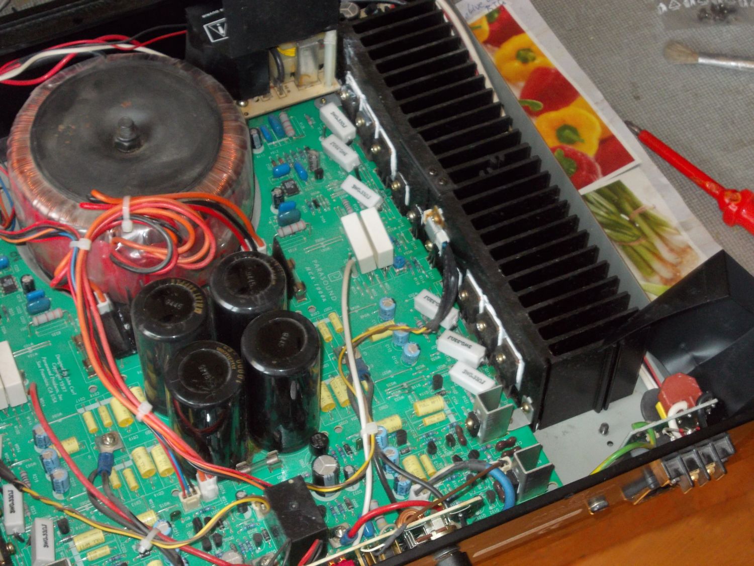

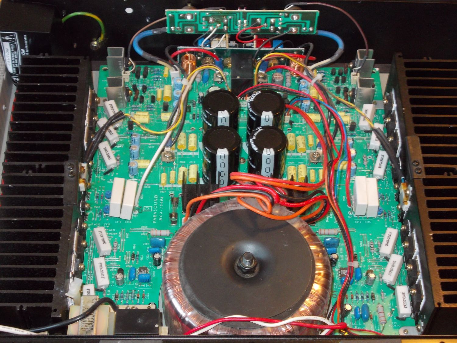

got a hca 1000a...........led lghts up, but did not want to start.
the psu electrolytics looked " bulged ", not very beautiful........
changed these , now new epcos (siemens) inside.
works without problems.
