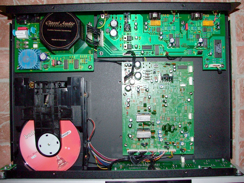

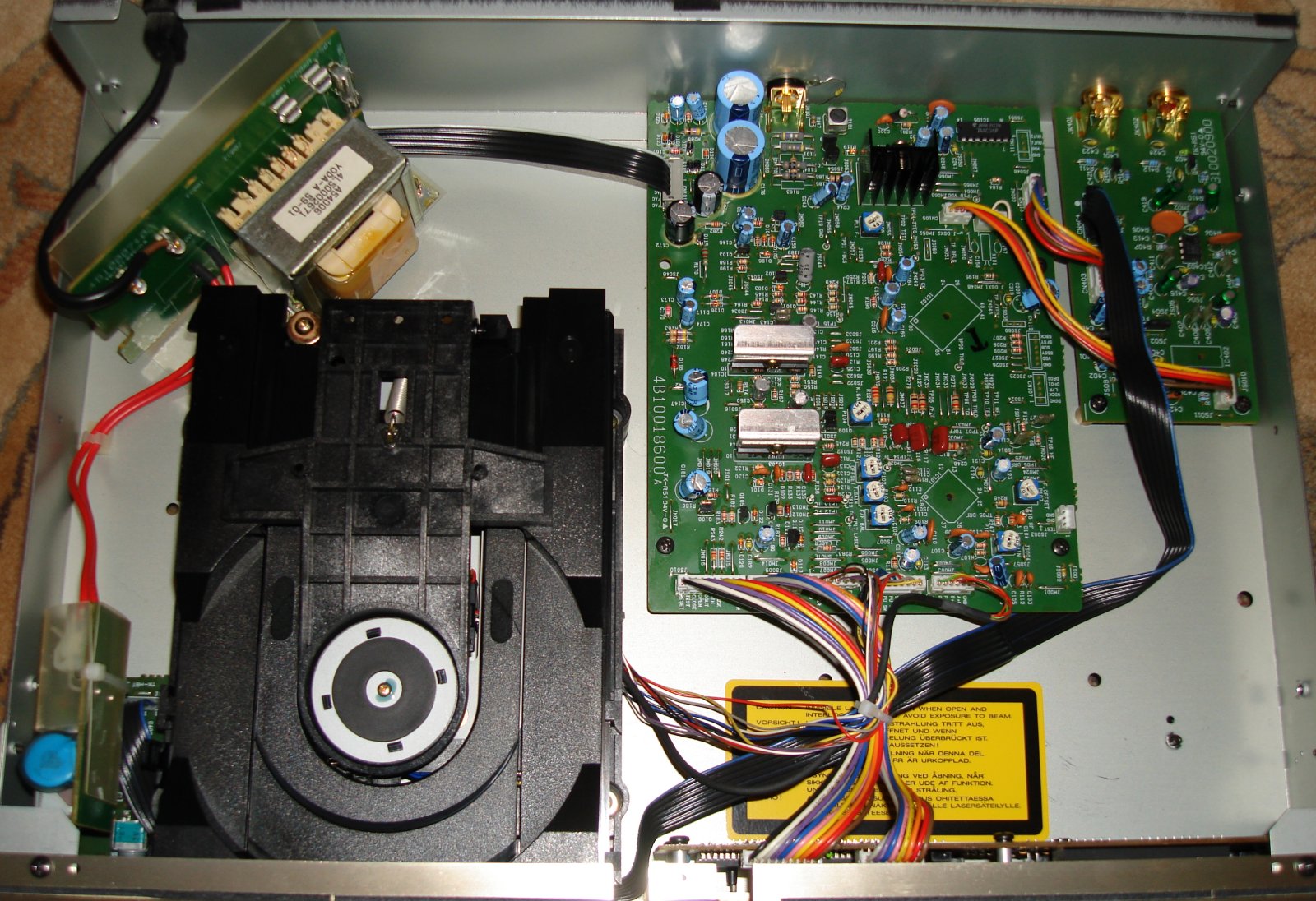

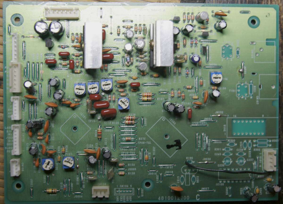

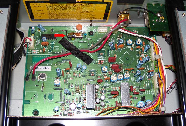

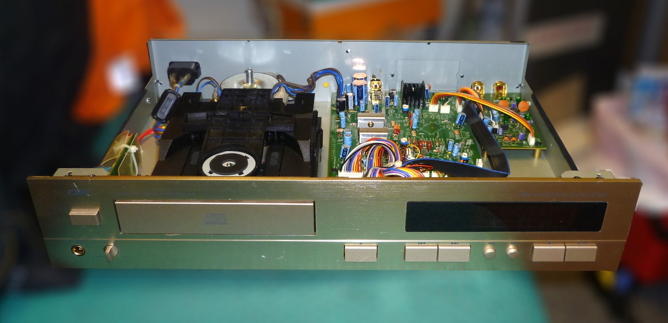

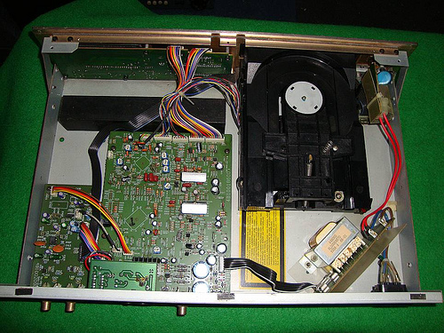

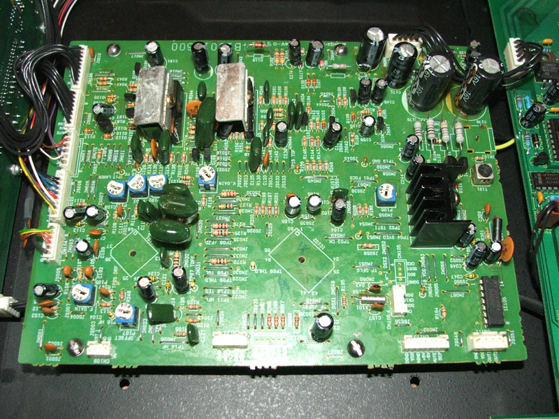

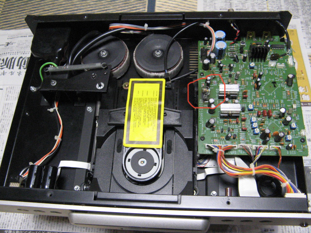

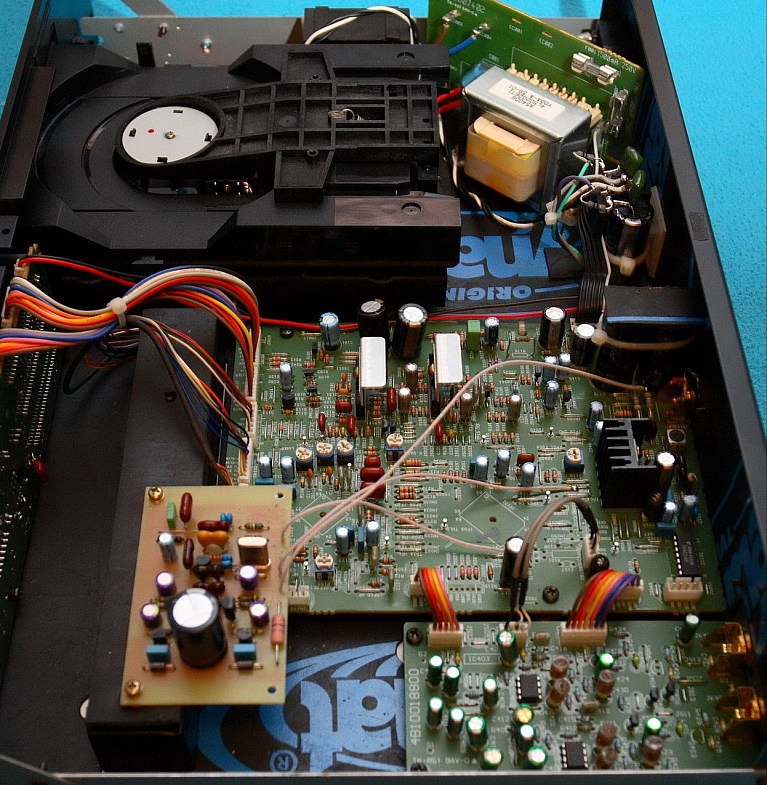

I am looking to a service manual of those associated CD Player model, where the here showed servo/pcm decoder PCB from Sanyo Optronics is in use:
Only schematic diagram of this PCB I have found by post #7 and #8 about
http://www.diyaudio.com/forums/digital-source/163081-cec-tl51x-cd-transport.html
There are a lot of other brands, where this PCB is in use. I have attached some pics and listed some examples by post #5 about
http://www.diyaudio.com/forums/digi...a-classe-cdp-3-roksan-caspian-main-board.html
The there mentioned models (Sharp CD S600X and CEC 780CD/880CD), from that I have found service manuals, are helpful, but not perfect. Therefore I want to have a service manual of those cd player device or hifi system, for which this PCB originally was developed and used. The following identifier numbers are to read:
1) on the PCB: "TK-T71 94V-O" and "4B10012700C"
2) on the associated schematic: Sanyo Optronics CO., LTD
My experience has shown, that there are more detailed adjustment and troubleshooting instructions.
Who know the associated model ?

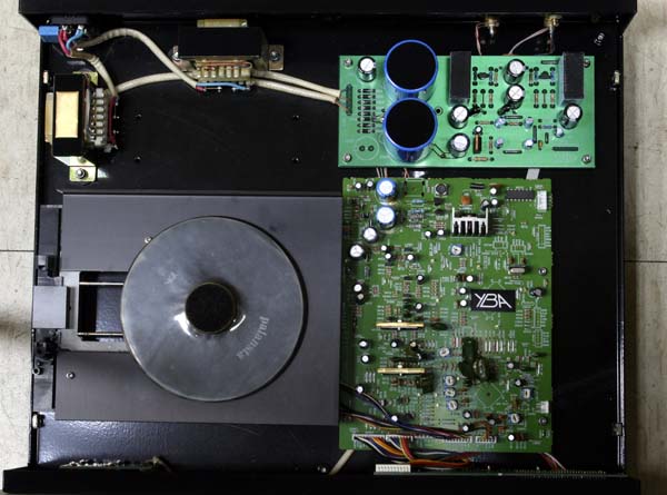

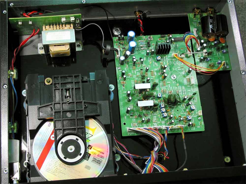

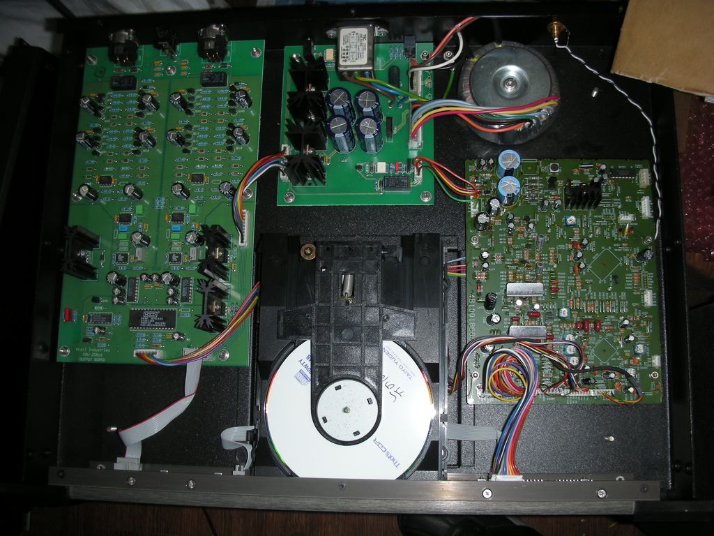

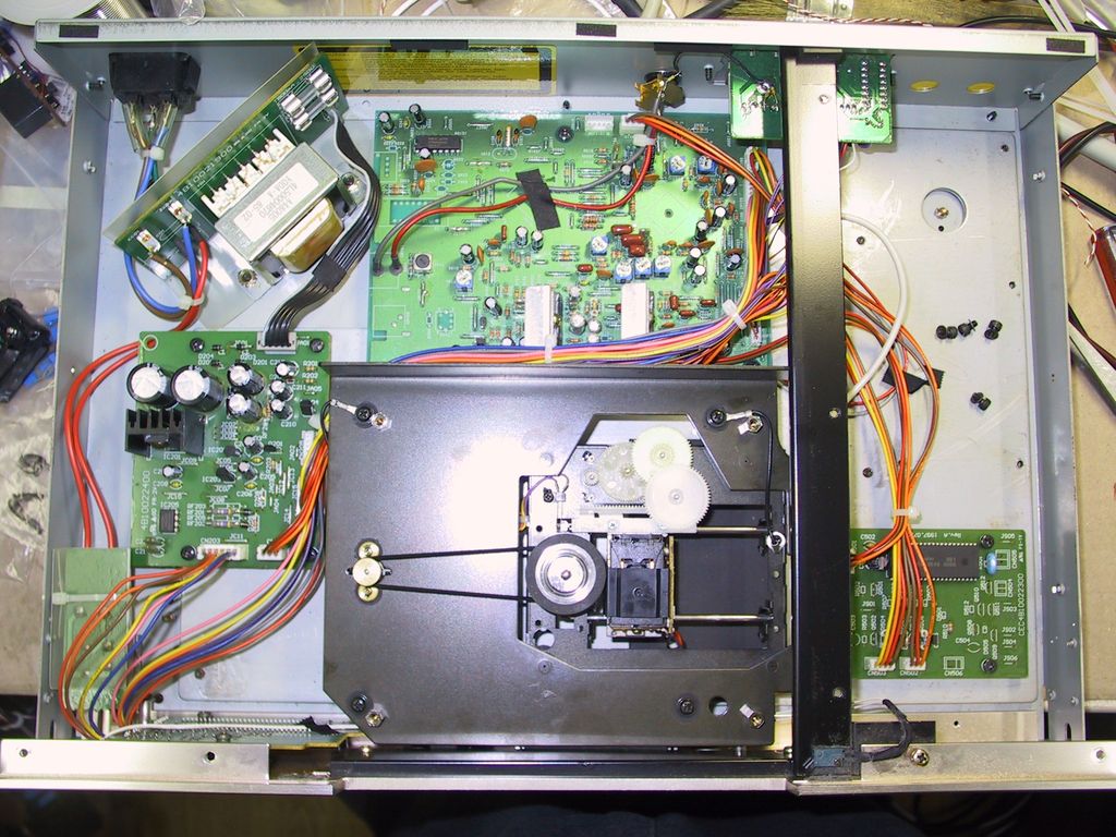

Now I have found several important informations:
Fringe - May 1999
Thus the smallest model for this servo PCB with detailled adjustment instructions in the service manual is the CD-2100 (CD2100) from CEC.
for schematic and tweaking advices go to
https://sites.google.com/a/lvsystem.ru/lab/praktika/audio/upgrage-cec-2100
https://sites.google.com/a/lvsystem.ru/lab/praktika/audio/upgrage-cec-2100/dorabotka-master-klok
https://sites.google.com/a/lvsystem.ru/lab/praktika/audio/upgrage-cec-2100/modernizacia-pitania
https://sites.google.com/a/lvsystem.ru/lab/praktika/audio/upgrage-cec-2100/regulirovka-mehanizma
and to post #18 about
http://www.diyaudio.com/forums/digi...-roksan-caspian-main-board-2.html#post2849624
Fringe - May 1999
Thank you very much. This service manual is the right thing for Sanyo's PCB "4B10018600" used in additional models:
a. Yba CD-2 delta (image post #7+1)
b. Classe CDP-3 (image post #7+1) about
c. CEC CD 2100+3100
d. Audiomecca Obsession
e. Krell KAV250CD MK-I
f. Roksan Caspian (M-Series 1)
g. Parasound C/BD2000
The mentioned PCB number "4B10012700C" ("4B10012700 C") by post #1 isn't correct.
This PCB version is in use by the belt drive CEC models "TL51X" and "TL5100X" (see attached pictures).
From which small cd player model I must have the service manual to this servo board (I have only the schematic without explanation of the adjustment procedure) ?? Or know anybody a download source of the service manual from this both CEC belt drive models?
I was working on one of these and contacted Parasound. They told me that it was lost in the move of factory and that they do not have it.
They also told me that a 5 CD unit C/DC-1500 used a very similar circuit to the C/DP-1000.
I really only needed the analogue section to restore the unit to factory original state after it had been "audiophiled" and it served the purpose.
