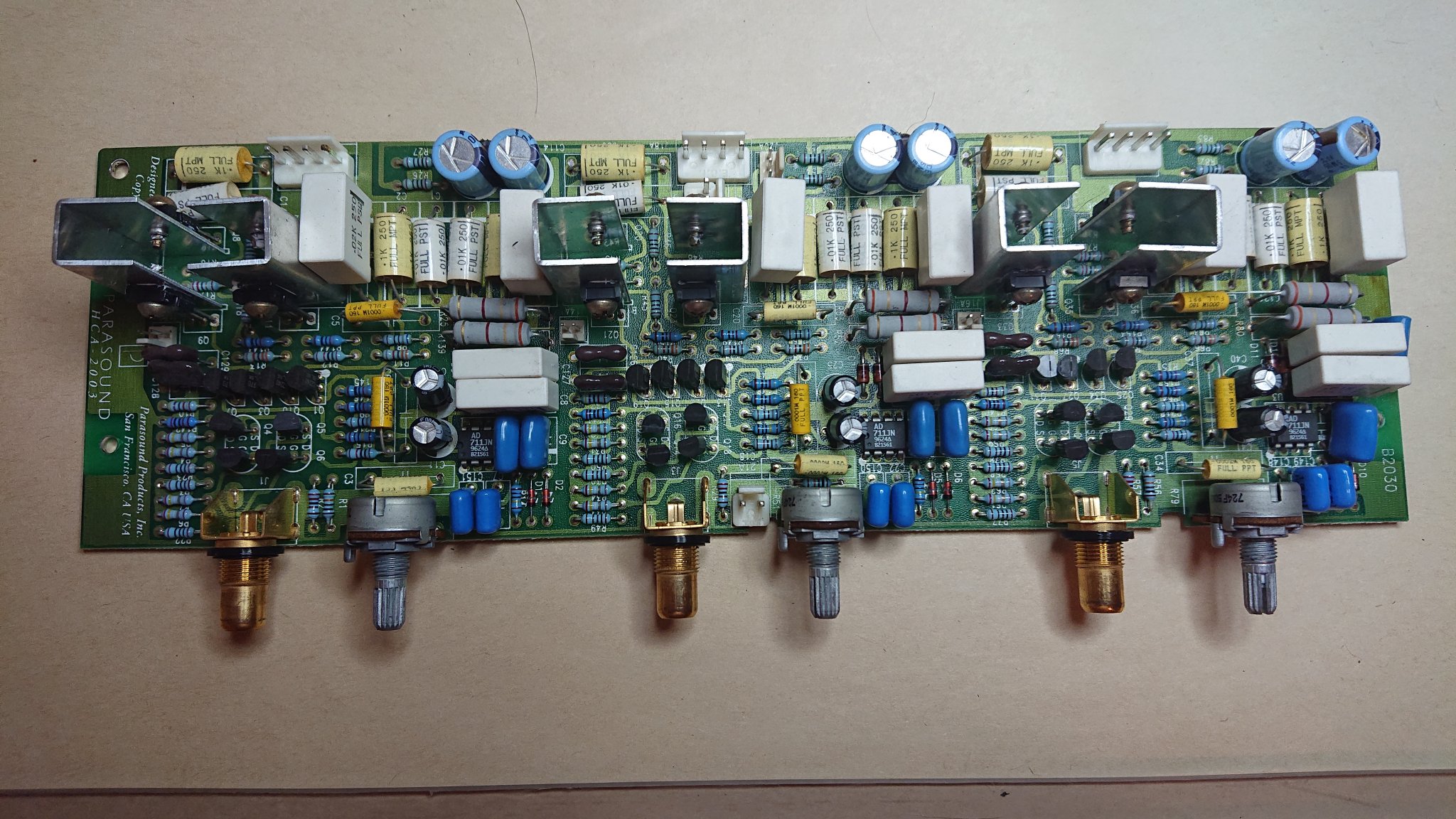

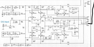

DEVICE: Parasound HCA-2003 circa 1998 three-channel amp
SYMPTOM: 10+ seconds after power-up with no input signal being provided (i.e., @ idle), one channel's output voltage (as read by a DVM on the outputs) slowly starts to go unstable, varying somewhat sinusoidally several millivolts positive then negative, growing in magnitude to in excess of a couple of volts. (This, of course, can cause voicecoil over excursion/damage to a connected speaker.)
ROOT CAUSE TARGET CIRCUIT BOARD: With 100% certainty (after experiments swapping interconnects to/from other channel's boards and/or power supplies), I've isolated the culprit to be the Inputs Board. See pic. The right hand one-third of that board is the specific at fault circuit.
ROOT CAUSE TARGET CIRCUIT/COMPONENT: I simply don't know. I've A-B-C's each and every component across the three identical circuits (for the three channels) using only an ohmmeter and voltmeter. Have found all NPN transistors functioning OK, all PNP transistors functioning OK, all diodes functioning OK, all resistors very similar in resistance, pots all very similar in min and max resistance, all pot's resistance vary smoothly and similarly with rotation, all capacitors ohm'ing out very similarly.
QUESTION 1: What am I not doing that I need to do to isolate and verify what component(s) out of spec?
QUESTION 2: What additional diagnostic devices (scope, signal generator...) might be needed?
QUESTION 3: What type of component (i.e., cap, diode, transistor...) would you suspect in light of the symptoms?

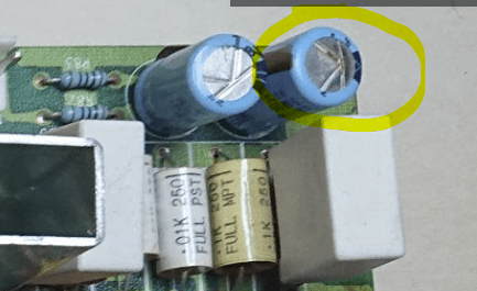

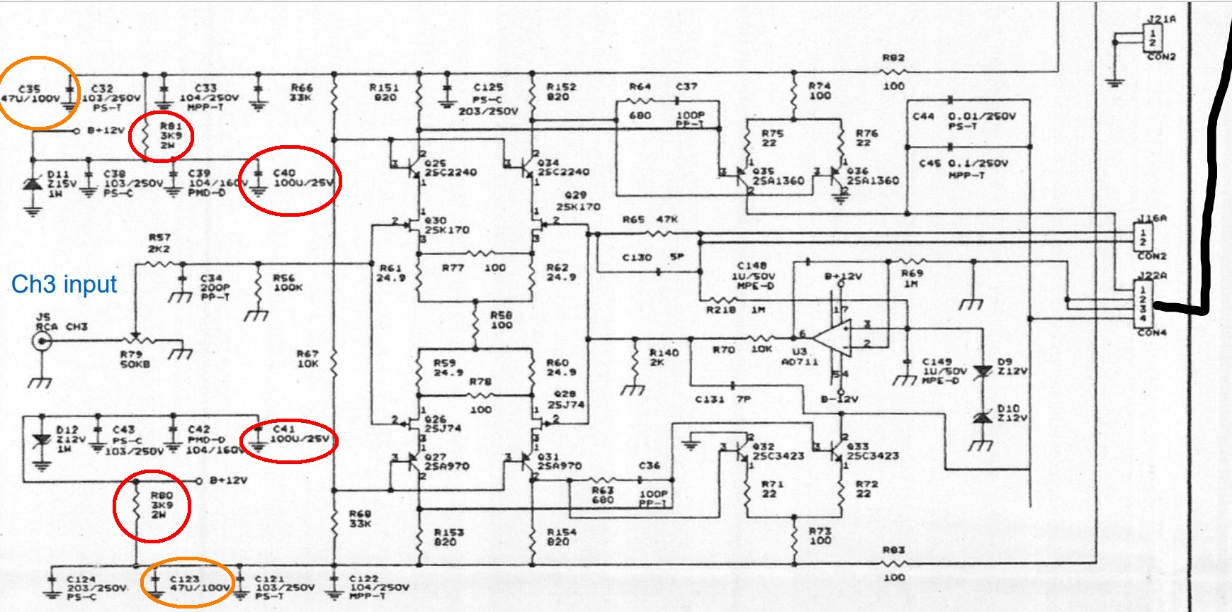

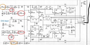

This would be the first thing I pull and test - the capacitor may not be bad, but certainly doesn't look good. as BSST mentioned, I would start with some cold spray on the transistors and see if you can replicate by cooling one of them and narrow the search even more. Then you will likely have to pull and test some parts to finally repair it.
Very good catch. I also saw that and replaced it. See (new) pic showing replacement cap in place. (What's under/around it is adhesive, not leaked electrolyte.) However, replacing it did nothing to the symptoms. I intend to change the neighboring cap, and the only two other electrolytic caps on that (section) of the board. Per the schemati, they are C35, C123, C40, and C41.This would be the first thing I pull and test - the capacitor may not be bad, but certainly doesn't look good. as BSST mentioned, I would start with some cold spray on the transistors and see if you can replicate by cooling one of them and narrow the search even more. Then you will likely have to pull and test some parts to finally repair it.

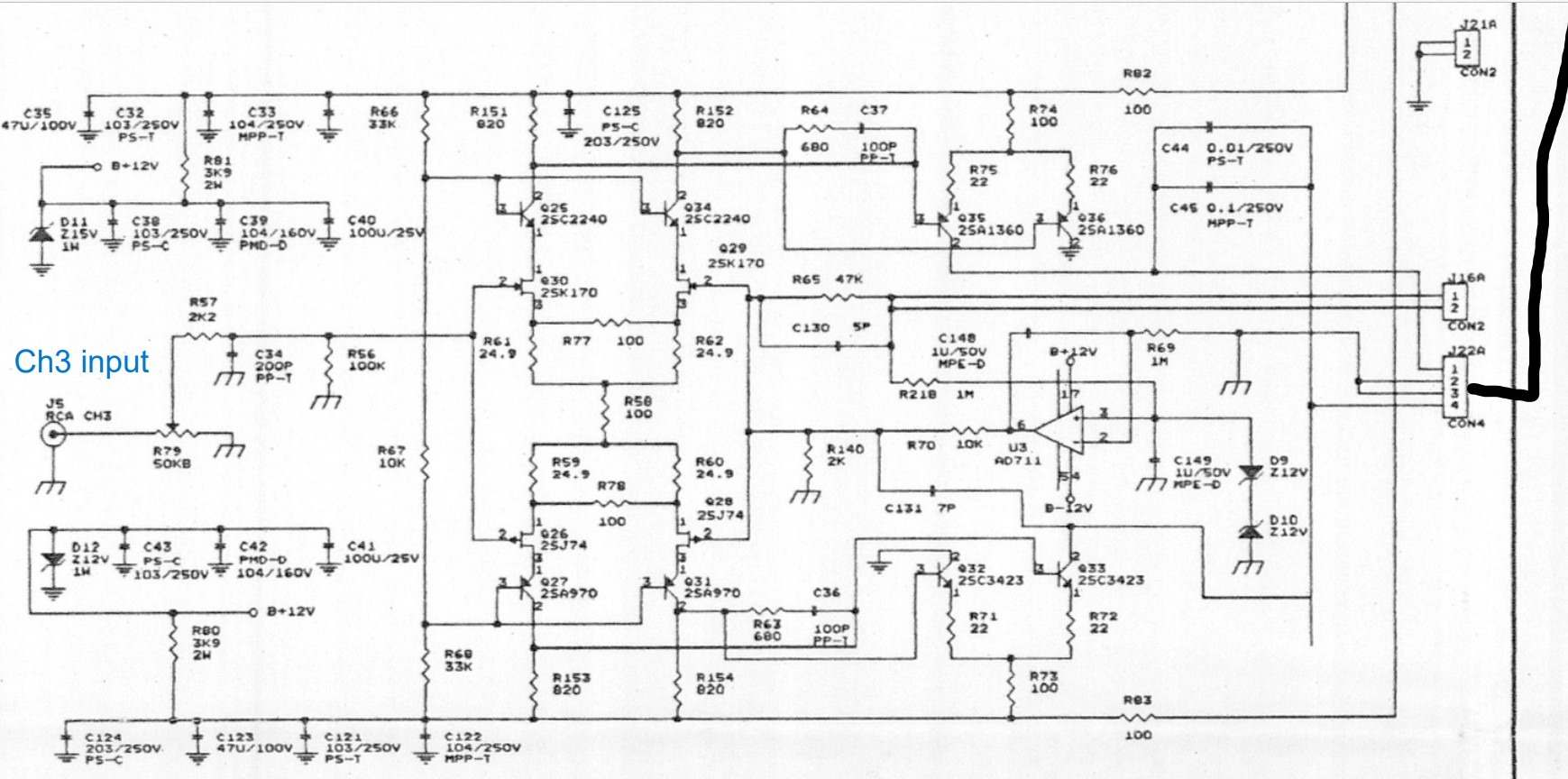

This amp features DC servo nulling of output. Because you describe slow (oscillatory?) behavior, I suspect the servo amp.
Would you monitor U3 pin 6 with your voltmeter and see if it mimics behavior of the amp output? If it does, I will have a couple further tests to suggest to identify the problem.

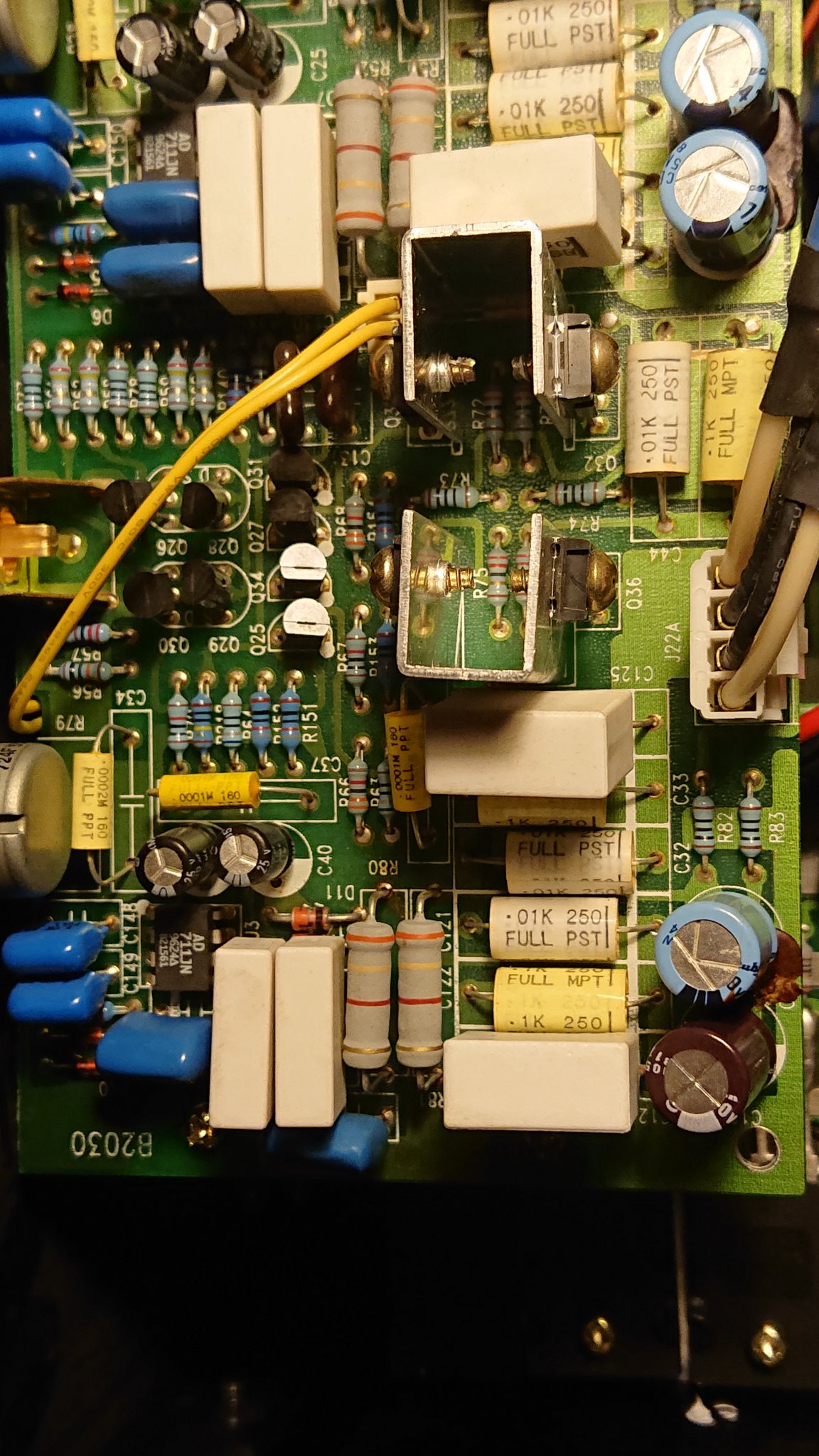

Good news - progress. I finally pulled this beast out of the rack and have the following observations.If it was me and I didn't have a scope, I would start with either compressed air can, turned upside down (cheap man's cold spray) and start with Q25-Q31 to see if you can replicate or see it get worse.
Otherwise, start checking the B-C-E junctions for voltage drop with a DMM and see if you have one of more that don't match the others. Then if that turns up nothing, do the same for the TO-126 on the heatsinks. If you still don't have a smoking gun, I would begin pulling the transistors out of the board one-by-one and test them with a transistor tester. Starting with TO-92s - Q25, Q27, Q31 and Q34, then move to the JFETs, Q26, Q28, Q29, Q30. My guess is that one of those is leaky sending DC and the leakage gets worse as it heats up.
1) At room temp, upon numerous resistance and diode checks across the target TO-92s and JFETS comparing all three channels components, I could not discern a single difference.
2) At operating temp, when the original symptom would occur (somewhat slowly cycling positive then negative offset reaching 2+ volts in each direction), the root cause would heal when blown with cool air. The most likely culprit is the Q27 Q32 pair. Notice in the (new) close-up pic (attached) the close promixity of these two. So the root cause of failure of thermal fatigue?
3) A new symptom would be exhibited after soem power up shot down events... a static -1.46 [Vdc} offset with "THX Level" pot on rear of amp @ its min level, -1.62 [Vdc} offset with "THX Level" pot @ its max level. Efforts to cool the suspect transistors would not lead to any healing of this symptom.

Is the "THX Level" pot level control R79?
The root problem may well be error in the input pairs (Q26-Q28 and Q29-Q30), but I recommend testing the DC servo as a first step. It's possible the servo itself is oscillating. Alternately, if it is operating correctly, it will try to automatically set to output voltage to 0V; in consequence, it will tend to suppress/obscure the drift errors that are the real underling problem. You'll observe erratic voltage on U3 pin 6 as it attempts to correct offset errors to 0V.
To test servo, install temporary shorts across C148 and C149. If opamp U3 is healthy, its output voltage on pin 6 will be within a few mV of 0V. Now you can test output offset error without incurring corrective intervention from the DC servo. (Leave the caps shorted until the problem is resolved, then remove to restore servo nulling.) Now you may find output error is even larger and continues to be "drifty" and erratic; this suggests drift in the input transistors. But if the output error remains relatively stable (even though large) at the amp output, this points back toward servo oscillation. Suspect C148 or C149, or connections to them. Maybe the opamp, though less likely.

With regard to suggestions relative to C130, then both C143 and C157, none of these caps are even in the Channel 3 Input Stage topology. So I see no connection they may have to the root cause. Note: "ROOT CAUSE TARGET CIRCUIT BOARD: With 100% certainty (after experiments swapping interconnects to/from other channel's boards and/or power supplies), I've isolated the culprit to be the Inputs Board. See pic. The right hand one-third of that board is the specific at fault circuit."

Correction: I see C130 on the opamp noninverting input. So I may test with a bypass cap as suggested. Q: If the instability symptom changes, what would then be the conclusion?
I was assuming an expendable speaker, like one from an auto junkyard or from a garage sale, would be used for troubleshooting a power amp. A dummy load such as an 8-10 ohm high power resistor in place of a speaker also works.
C143 and C157 are at the back end of the amp but they (together with the resistors in series with them) may have an effect on the stability margins of the global feedback loop that they themselves are part of. However since you have exhausted the possibilities by rotating/swapping channels during testing, perhaps the loop instability could be ruled out.

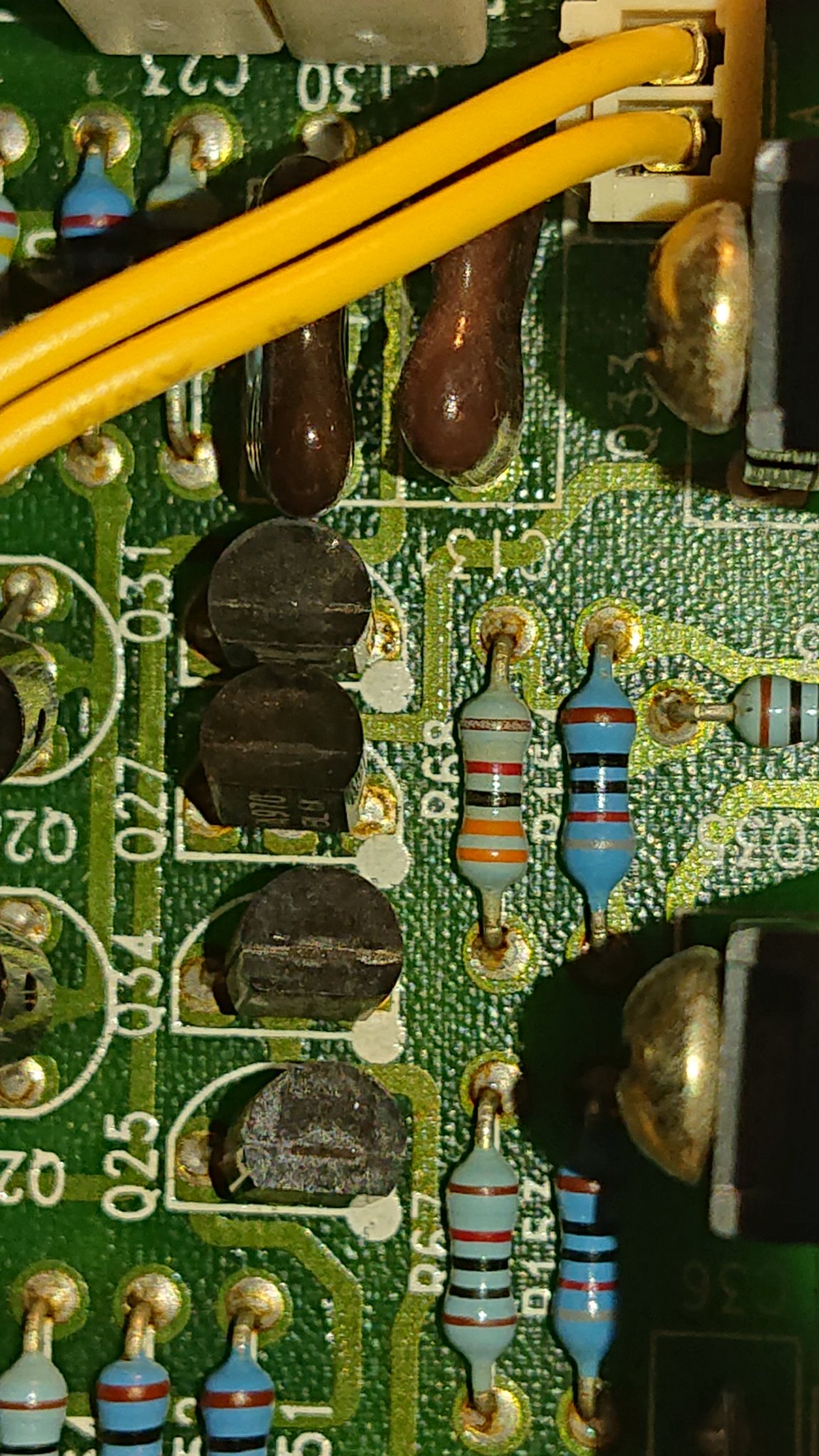

Have replaced a total of four TO-92s. Specifically, two A970 (Q27 and Q31) and two C2240 (Q25 and Q34). I choose the most closely matched pair(s) for hFE (A970s @ 340 and 336, C2240 @ 355 and 356).
Symptom remains, though somewhat different Vdc values. The earlier reported (unstable) symptom exhibited a slowly, somewhat sinusoidal, positive going then negative going offset. Also, blowing cool air across those four TO-92s would have significant impact on behavior. The current symptom varies slowly and is most often a negative value like -1.62 Vdc. Blowing cool air there still can affect output but not as significantly.

The -1.4V voltage you observe is a reasonable magnitude, but it shouldn't be oscillatory. I still recommend shorts across C148 and C149 as diagnostic simplification. If you see about 0V at opamp output, that's suggestive that opamp is ok. Test amp without servo correction. There may be DC present at output, but it should be relatively stable; might show some modest sensitivity to temperature. Once the amp is well behaved, remove short across C149; there should be modest correction of output error, but no oscillation. The filter at C149 has a 1 second time constant--- you'll probably be able to sense it's "slow." Then remove short across C148; output error should drive to only a few mV. The servo should be able to null initial amp offset error of more than 2V.
Looks like there's a bit of corrosion on the PCB. This could be causing leakage issues if it's a multi-layer PCB.
Did you check R69? High value resistors often go higher in value with age, sometimes even O/C. Servo caps might also be worth checking.
Forgot to mention you should also monitor the +/-12V servo supply to see how that compares between the 2 channels.

So to date I've replaced:
a) four electrolytic caps, specifically C35, C123, C40, and C41
b) four TO-92s, specifically, two A970 (Q27 and Q31) and two C2240 (Q25 and Q34)
b) the servo op-amp AD711
