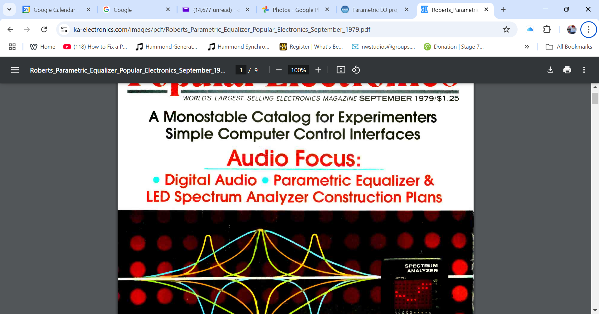

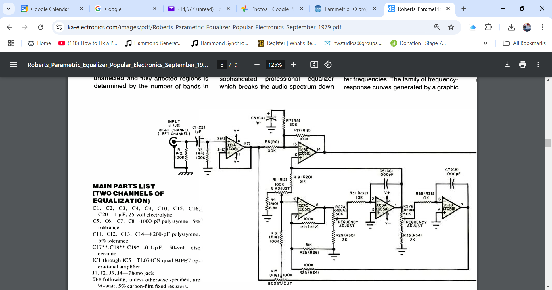

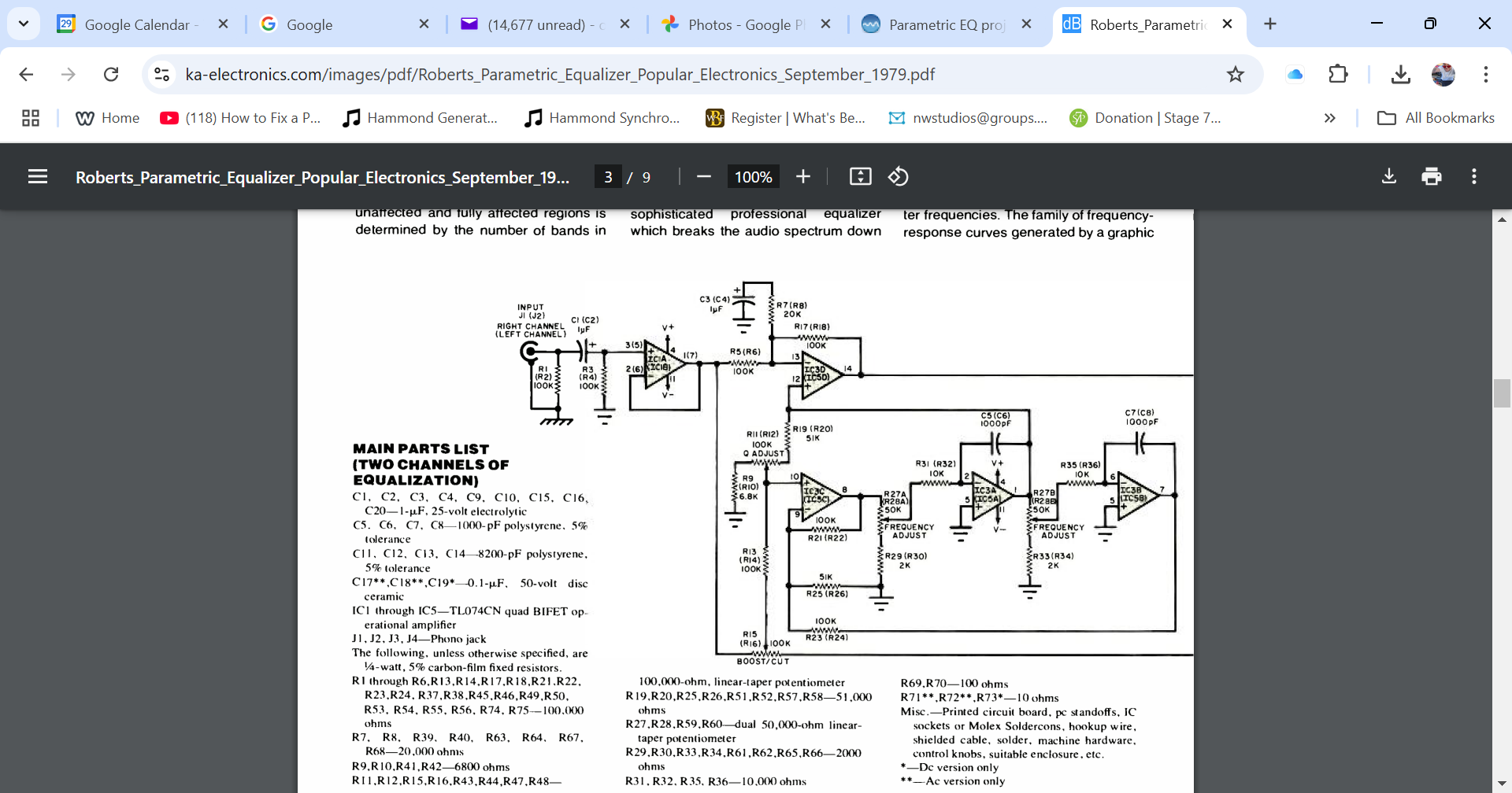

I built one from an article published in Popular Electronics Sept 1979. It worked really well. I saw these magazines are available online for free. https://www.ka-electronics.com/imag...alizer_Popular_Electronics_September_1979.pdf
Unfortunately the .pdf is too large to upload, so hopefully this link will work for a while. Here are a few pictures of the schematic should the link stop working in the future. Of course back in 1980, that was all you could do. Now I listen using a laptop and it's easy to do EQ in JRiver or equalizerAPO digitally. Of course you don't get to warm up the soldering iron doing that.
