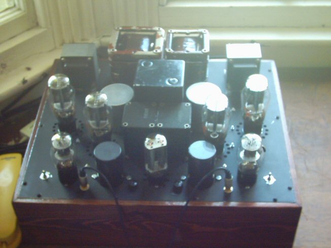

Hi,I've paralleled a pair of 10H 120mA chokes in the first CLC stage of my latest power amp which draws 240mA with no probs,This is followed by an LC stage consisting of a 10H 300mA choke and 100uF filter cap.Sounds really nice.The second LC stage made all the difference.😀
If both chokes have the same inductance, it will result in a half inductance value for the paralel mount.
Okay, I'll give it a go then. A second L stage with higher H seems indeed the way to go when H of the first parallel stage are only half. Thanks guys - and nice looking amp, Kianbach!!!😀
