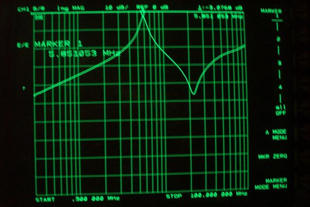

To illustrate what I said in my previous post, I've made a VNA measurement on a combination of a 220µ/10v Oscon cap paralleled with a 10nF polypropylene film cap.
The measurement point is right at the 10nF pins, and the wires to the 220µ are exactly 50mm long.
You can see a strong parallel resonance at just below 6MHz, followed by a series resonance at over 20MHz.
The attenuation at 6MHz is only 3dB (it's a 75R system)

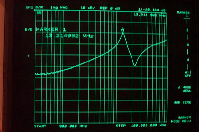

For reference, here is the same measurement taken without the 50mm wires (both caps directly in parallel).
The parallel peak is now at 13MHz and 20dB below the reference, and it shoots only moderately over the normal, inductive slope of the curve.
