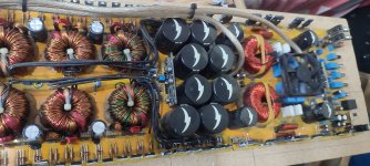

Could I just connect the psu's in parallel? Jim Stuart of Meridian answered a question years ago on a forum regarding the 'lean' nature of the Meridian 105 mono. He said what they need is a bigger transformer. Would this satisfy that need? Would this double the va rating? Since the psu and amp are in separate chassis, it would be easy to piggy-back them.

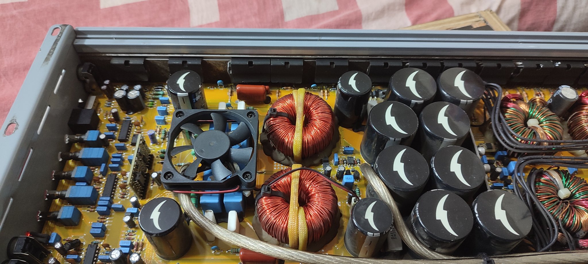

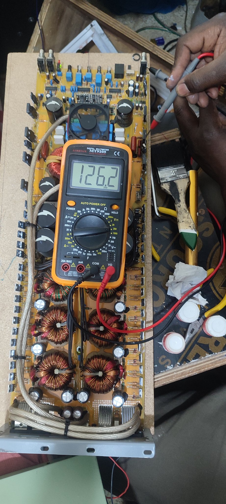

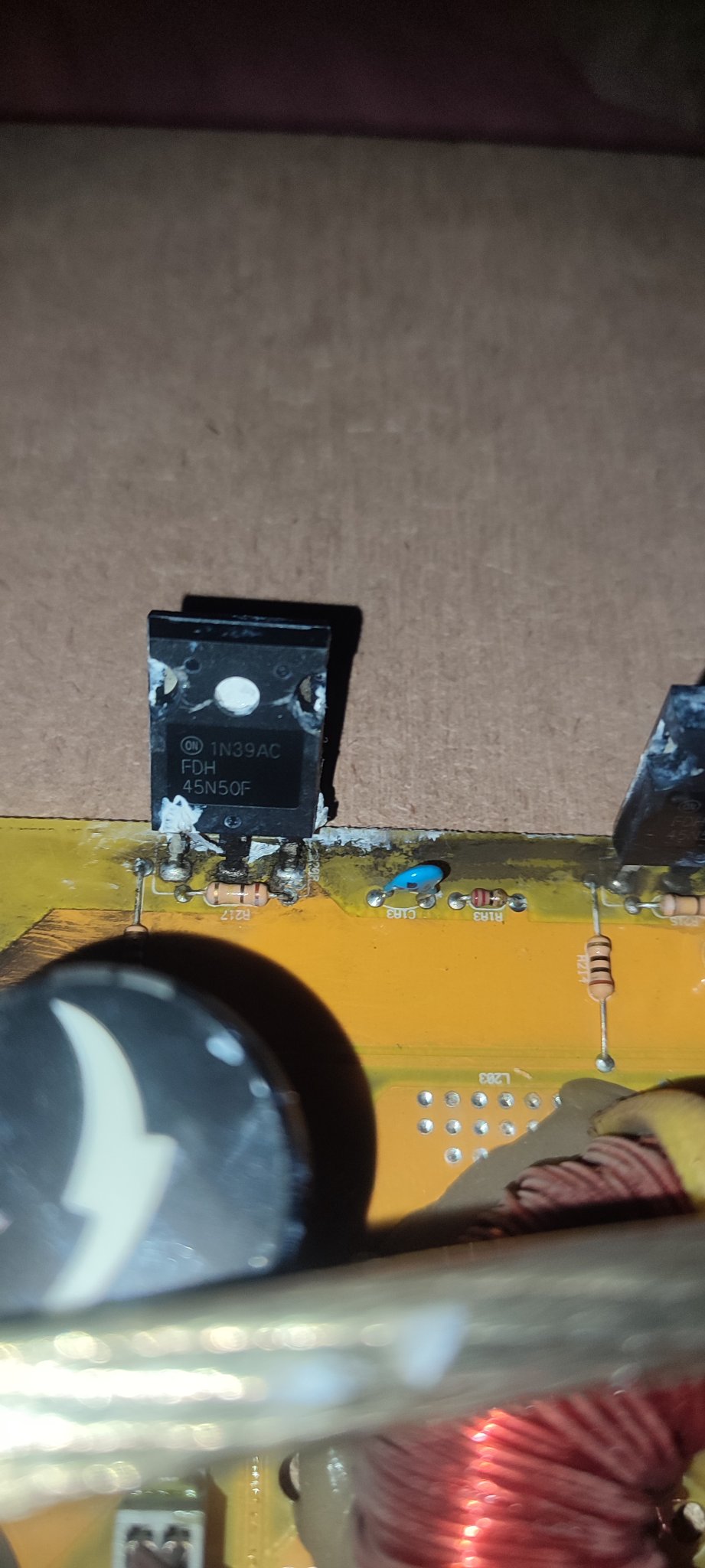

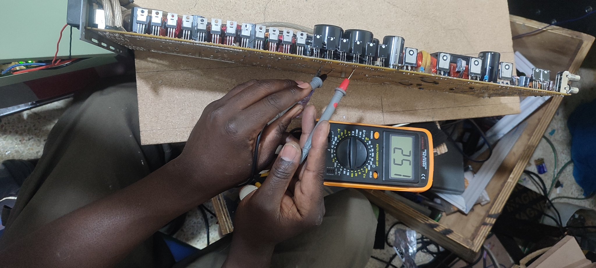

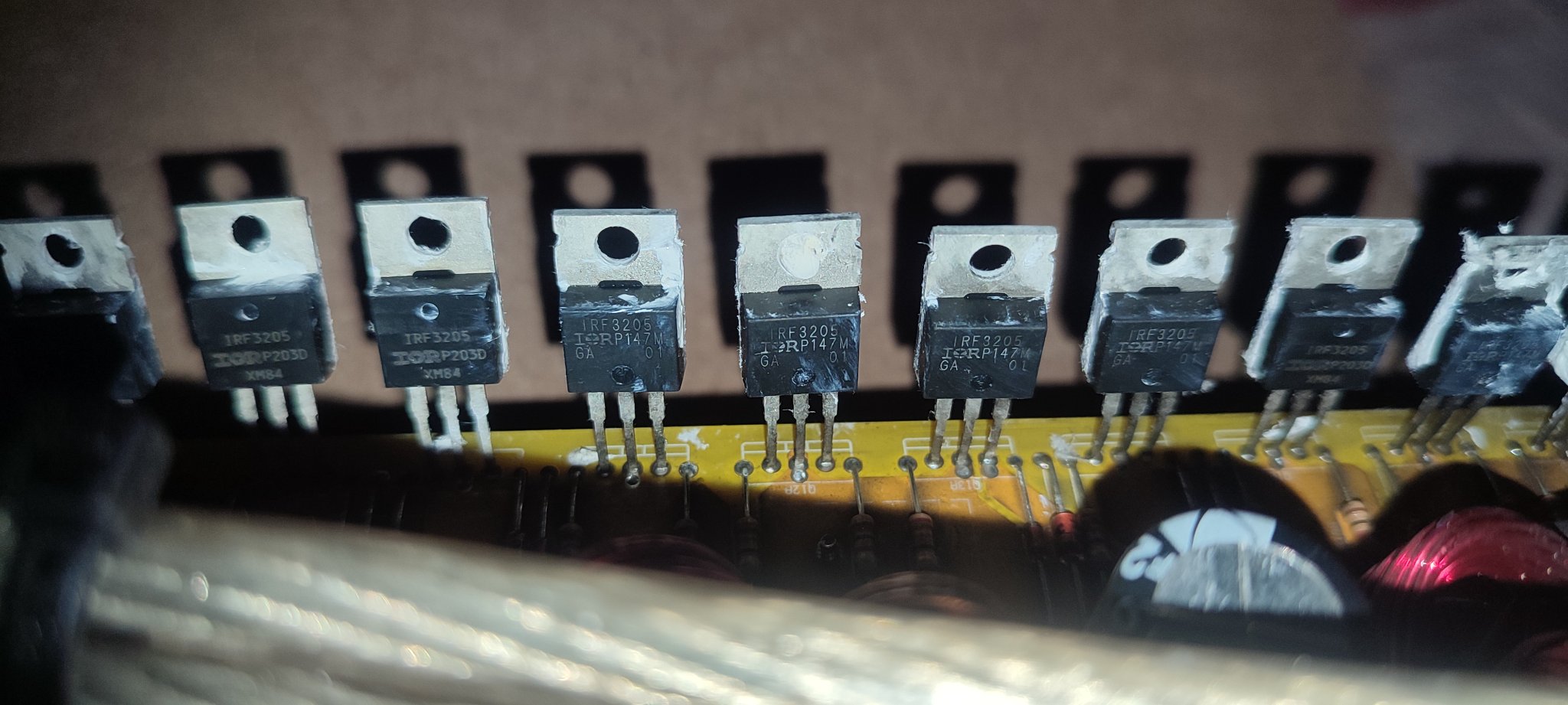

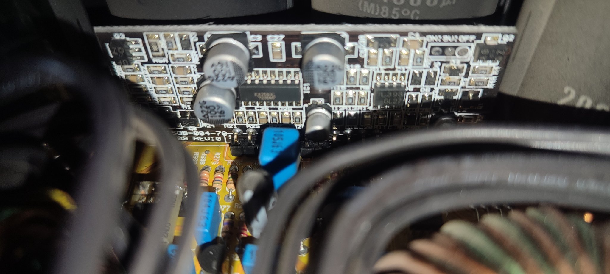

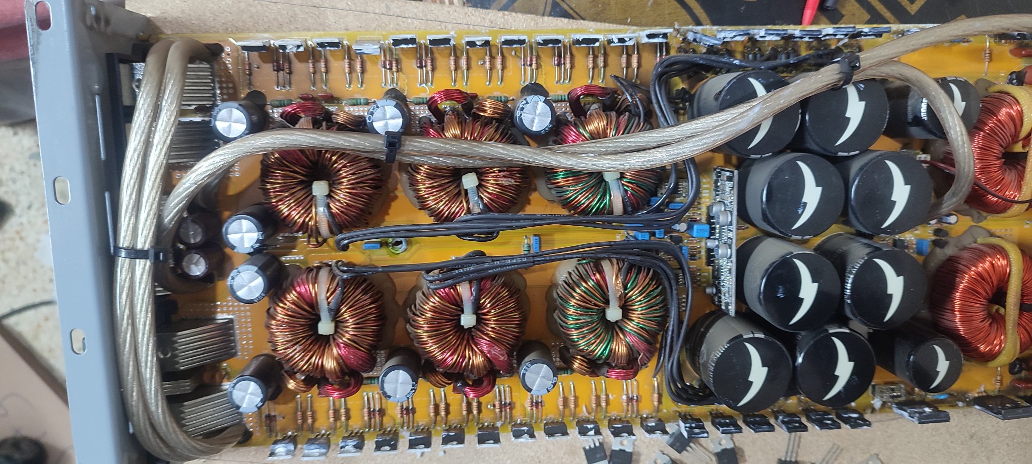

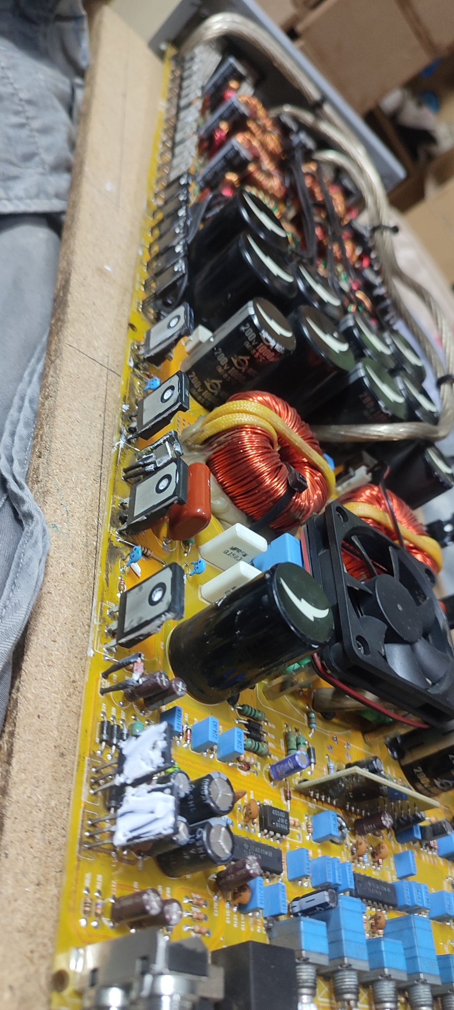

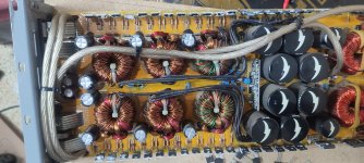

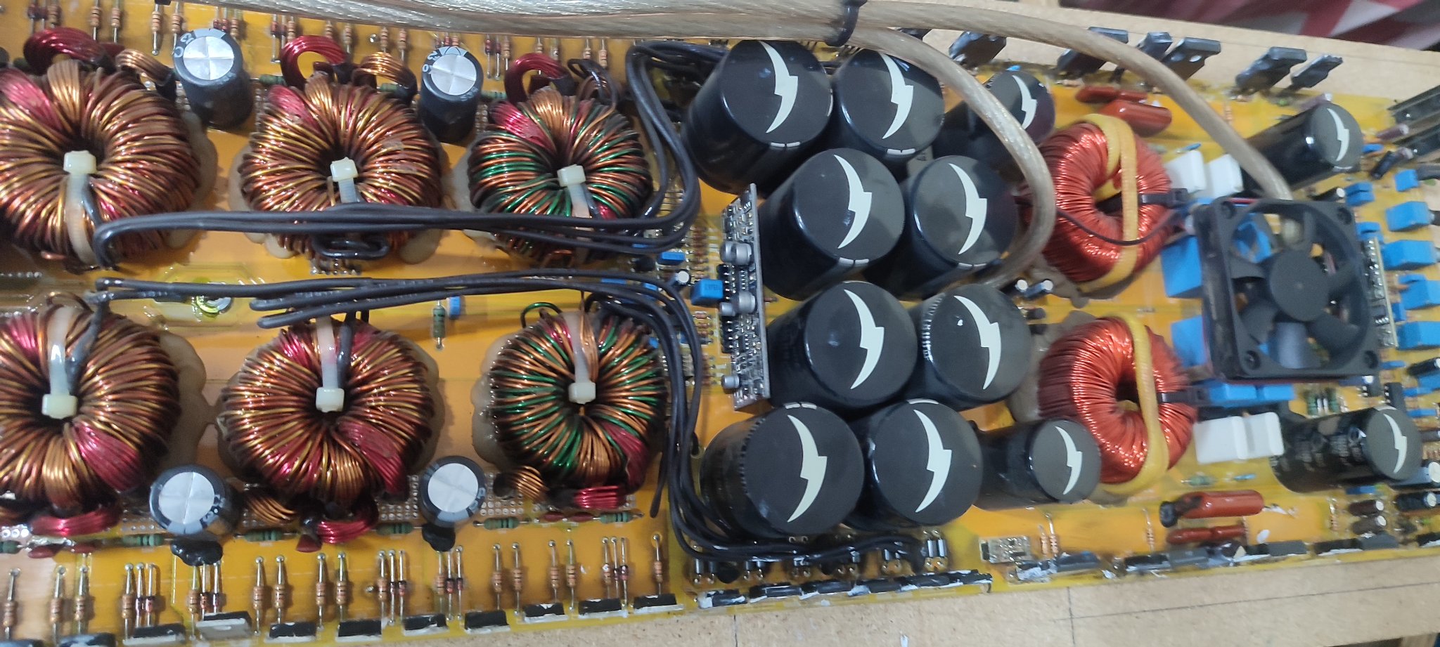

hello all this too is a high power class d using +/-125 vlts and its paralled in the outputs , also i cannot see any output resistor used before output. (i think they are the four white droppers resistor next to the output inductor)
the amplifier is stable up to 1ohm

thanks wg_ski for the reply .do you have a schematic diagram of paralleled class d amp or paralleled ac smps ? kindly share here if you do

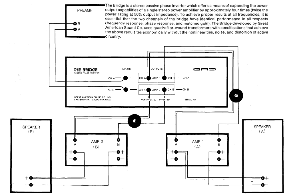

"The Bridge" is just a polarity inverter using line level input transformers to feed stereo amplifiers to make them function as a bridged mono amp.Hi. I'm wondering if there's such a thing as a universal paralleling 'box' you can plug two identical mono amps into to lower impedance capability. G.A.S. aka James Bongiorno did produce a bridging box called "The Bridge" for bridging their amps which was a universal circuit. TIA
A "universal paralleling box" to combine the output of two identical mono amps could be done with a pair of speaker level audio transformers.
The cost of high-quality full-range 100 watt audio transformers would exceed the cost of new power amplifiers with more power than your circa 1978 100 watt @8 ohm Boothroyd Stuart Meridian 105 amps.

Simple question, simple answerHi. I'm wondering if there's such a thing as a universal paralleling 'box' you can plug two identical mono amps into to lower impedance capability.
There is no universal paralleling box.
