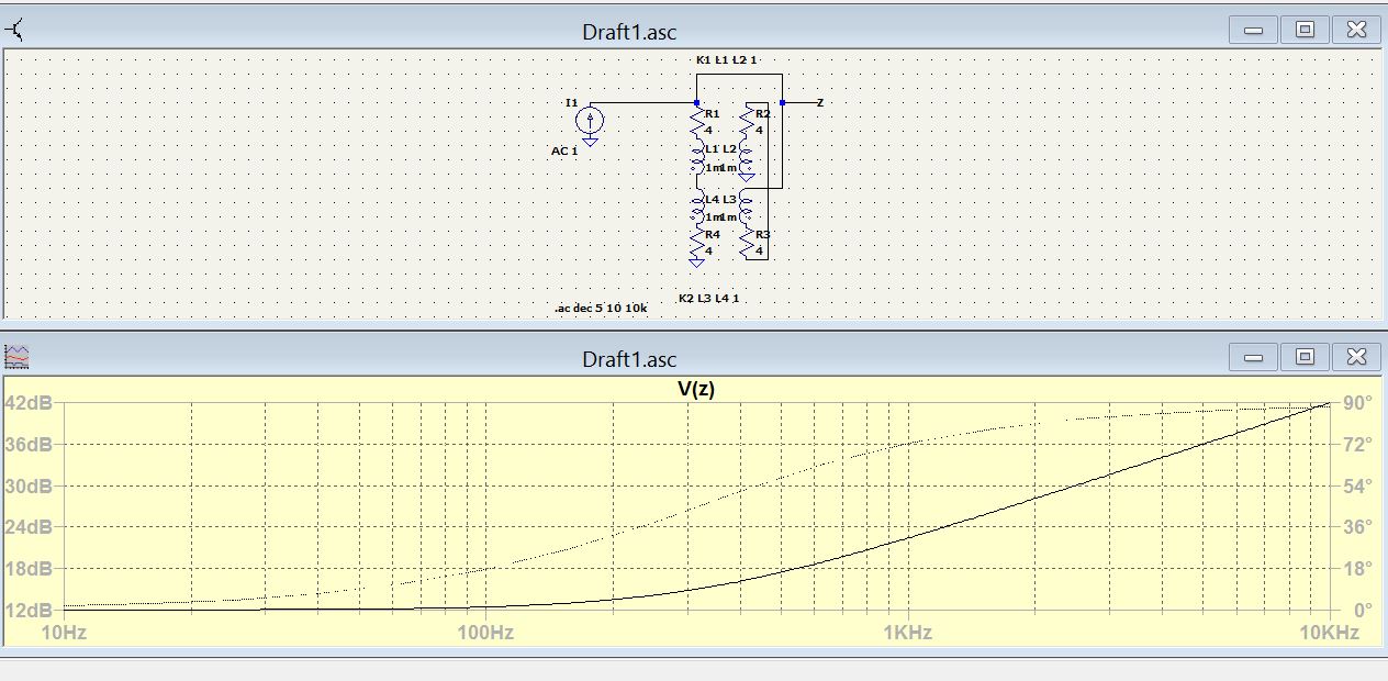

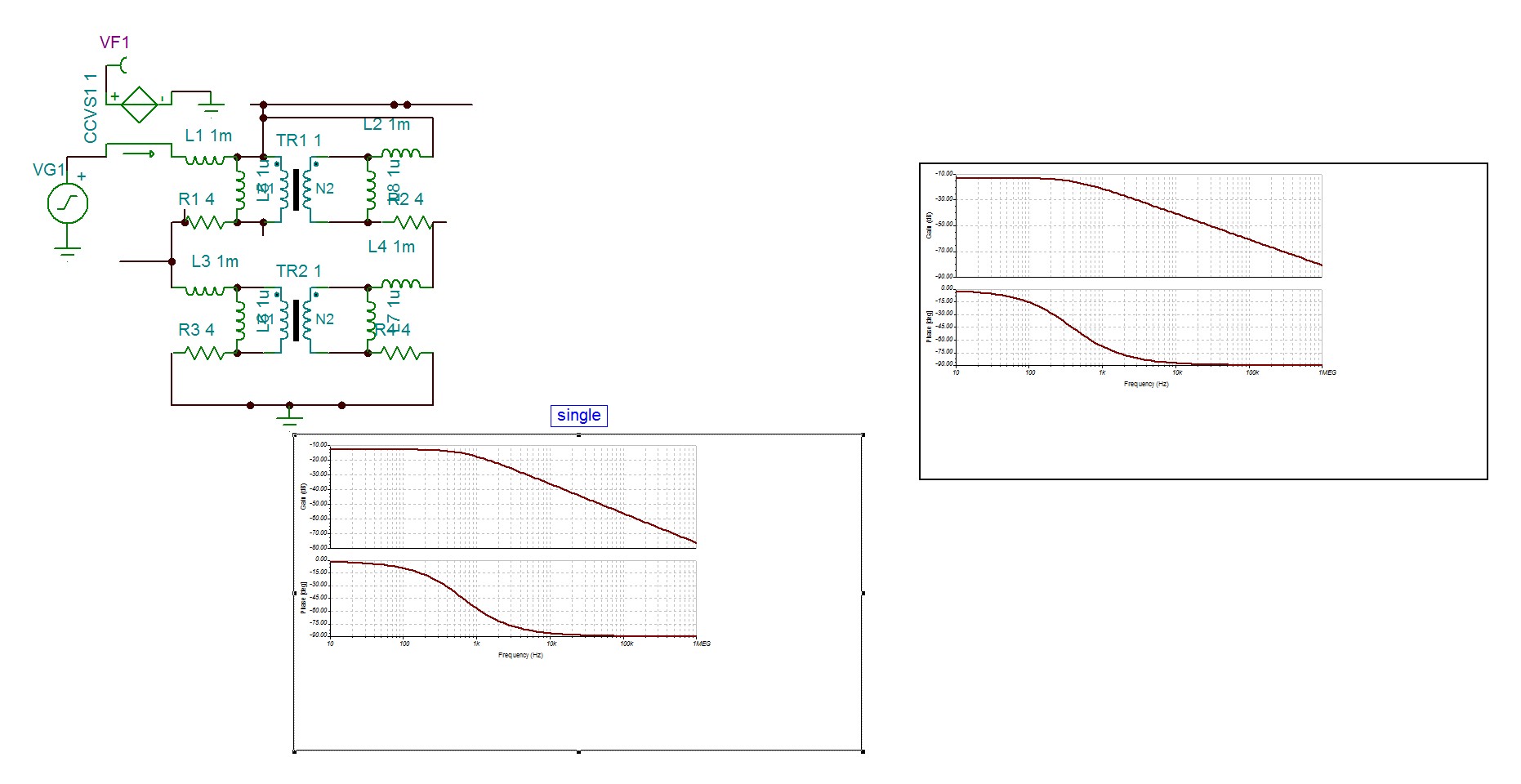

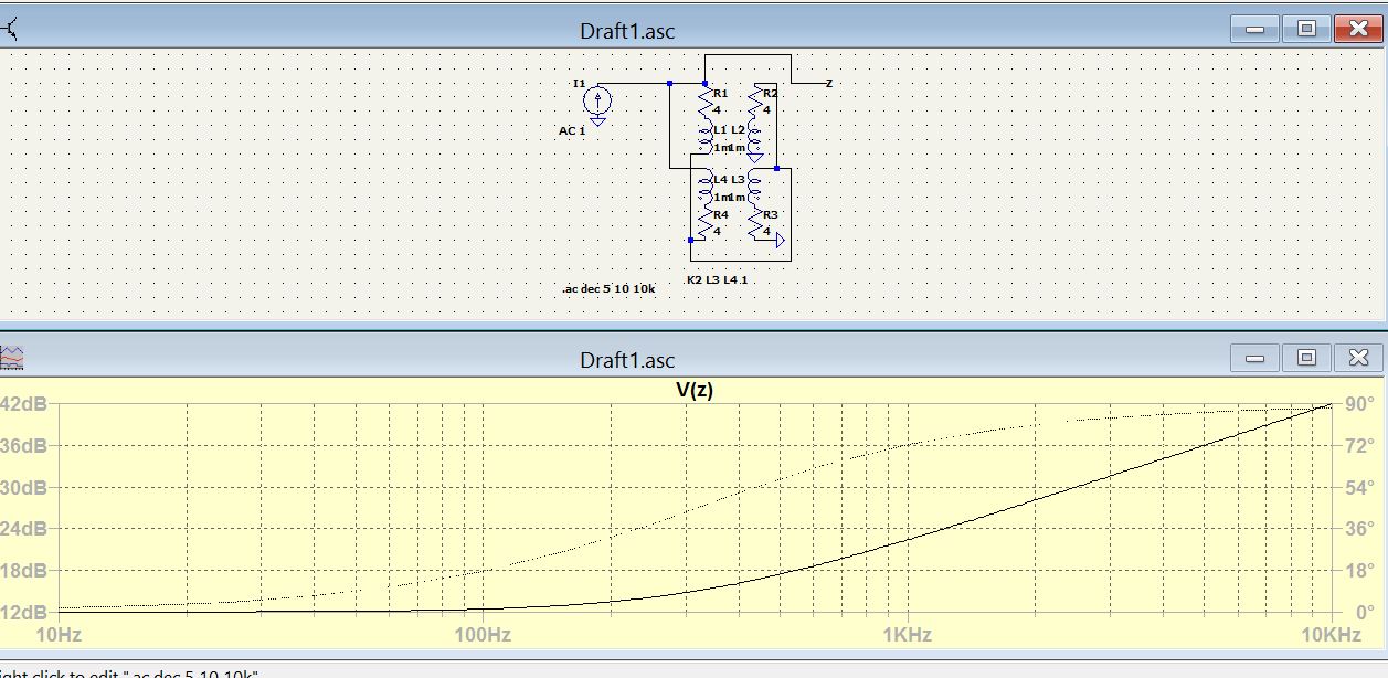

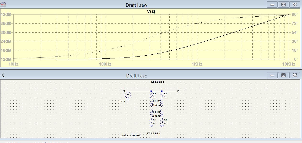

The hero of this story is the Inductance. If each winding has impedance 4 ohm and inductance L, if you wire the two windings in series you get 8 ohm but 4L. If you wire them in parallel you get 2 ohms but only L, because it is in the same magnetic field as if the wire is just thicker. To obtain back 4 ohm and L, maybe wiring one winding of a speaker in series to second speaker winding and put the two pairs in parallel can do, not so sure.
I will see on simulator.

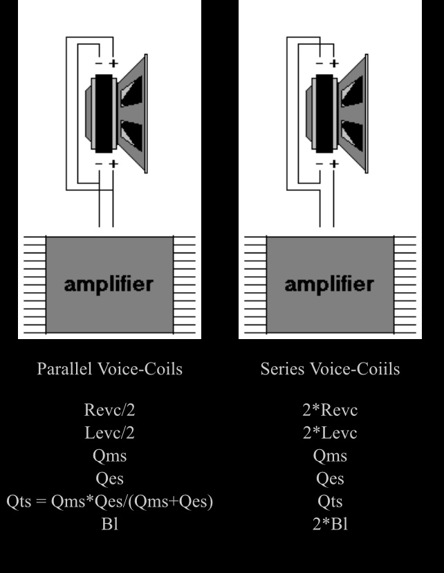

I found an interesting source on attached. (Credit: Thiele-Small Parameters and Dual Voice-Coil Drivers)

Or just lift the T/S parameters from the datasheet which the manufacturer has gracefully provided for both series and parallel wiring configurations, then treat it as a single coil driver.
The configuration they likely won't give you is if you use one coil, and short the other, or short it via a resistor. Then you need a bit of math
