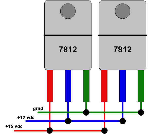

Hi All-
I was curious about what would happen if you paralleled voltage regulators to try and get more current availability for a circuit.
I did a search and did not find any drawings such as below or this specific question being "recently" discussed. I was not about to read search results going back 50 yrs (exaggerating of course).
Thanks in advance,
Troy

I most probably won't work. Since two devices are never
exactly identical they will fight each other and share the
current unequally. I would even be worried about oscillations
due to the mutual independent feedback loops.
There has been suggestions before on the forum to parallell
regulators by adding series resistors at their outputs. That
might work, but regulation will suffer.

I agree with Christer. I think it might work with 317-type (or other with external feedback network) regulators, by including a small sub-ohm (depending on current drawn) equalising resistor and taking the feedback point for all regulators at the load point where the equalising resistors come together.

As Christer said your circuit won´t work very reliable but some chips from Linear Technology for example (LT1083) just need very low ballast resistances on the output (like 0.015Ohm) to share current equally.

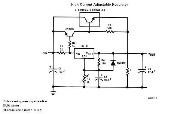

One of the best and most popular ways to achieve greater current output of a regulator, is to use parallel emitter current followers on the output.
I don't have any schematic drawing software handy, however, there are many good examples on the internet, and probably many users here at diyaudio that could provide a simple example.
Essentially, the output of a positive regulator will connect to the base of an NPN transistor, with the unregulated DC voltage input also going to the collector of the transistor, and the emitter being the new output. It works on the principle of maintaining vbe drop across the transistor. The ouptput will now be about .5 to .8 volts lower than the original regulator output, so it's nice if you have a variable regulator like a 317 so you can set the desired output.
This may be a bit confusing, but if someone shows a diagram, it'll all clear up.

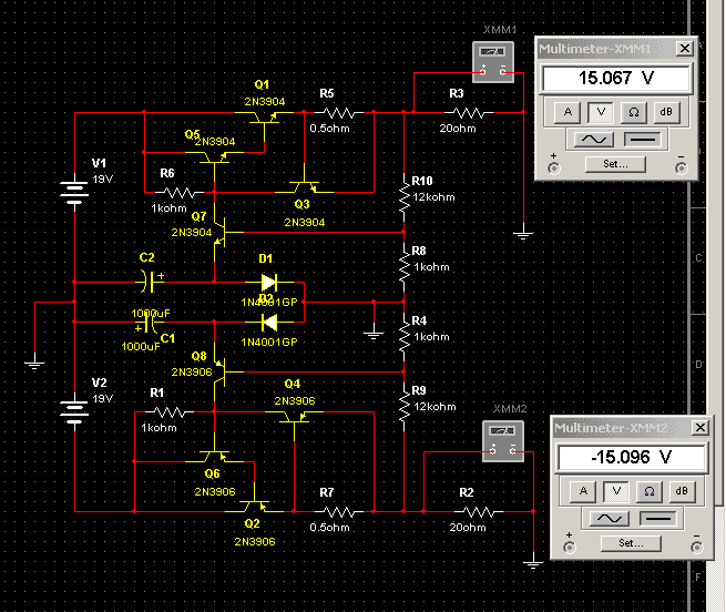

Why don't you go all discrete. This is a popular regulator I found many moons ago, it was only positive but I made up the negative side and it works vary well quite high regulation for it's simplicity. It has short circuit protection which is adjustable by varying r7 and r5. Voltage is also adjustable up and down by replacing r9 and r10 with 20k pots.
