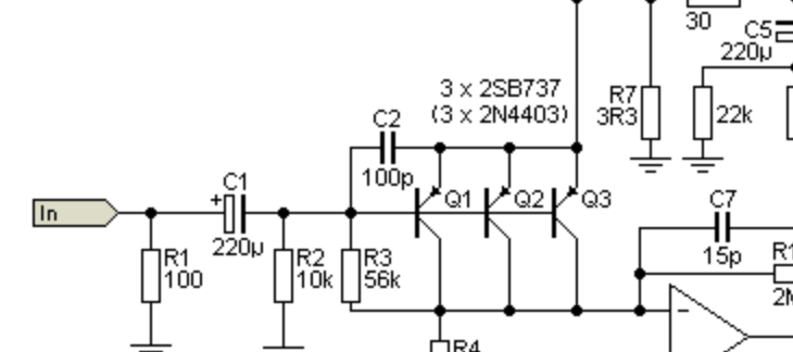

Here is an unbalanced pre amp. To produce a balanced pre amp, build another input leg for the +ve input.
AS for the loading, it depends on the Hfe or f the transistors and if you have a high enough Hfe, the impedance will be governed by the load resistors used. In the case of this diagramme, 100R.

An MC photo amp in particular requires careful attention to noise design, and at low impedances. Using devices with a high noise impedance will give a massive noise figure in this situation, just as devices with a low noise impedance don't perform with a high source impedance.
MC is the only audio application where parallel devices makes some sense as it is hard to get low base spreading resistance and decent gain at the same time.
You can treat two transistors fed by a 10 Ohm MC as each being fed from 20 Ohms

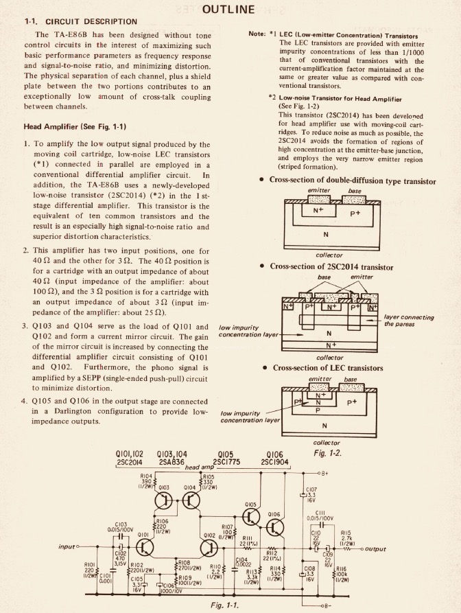

Professor Nordholt (TU Delft, Netherlands) wrote an extensive published (in dutch..) article about noise optimisation in 1981 concerning a MC prepre ("avoid current mirrors anyhow"). It boils down to get the lowest series resistance from source to ground, the coil, rb, re and if not avoidable the external Re. Paralleling works up to a limit: ref #4 #5 #6 #7.
In general:
Ic-optimal = ( 25*SQRTbeta - VRe ) / ( Rs-mc + rb-bjt )
So, high beta does contribute up to a certain device-depending level to reduce noise, whereas the external Re adds noise and the chain of resistance should be kept as low as possible.
That gives even a simple circuit a serious challange regarding gain, noise and distortion.
Finally, he brewed his own semi to meet his qualifications. Edge tech from the ancient past.
My Sony TA-E86 employs a discrete prepre with a Sony-cooked 10-parallel-on-a-die bjt, reaching SN 78dB @ 0.2mV weighted. Still in use, flawless.
