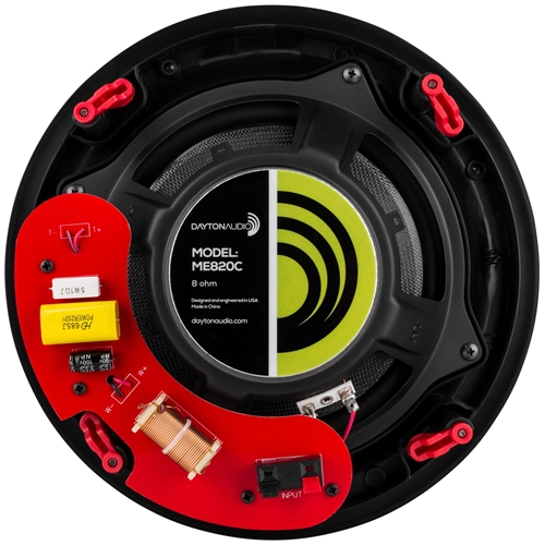

Amplifier shows banana plugs, speaker drawings appear to show push terminals for bare wire ends, so go to first speaker in a line, uncover 1/2" end, repeat with wire which will continue the path to the second speaker, twist bare ends together and insert in first speaker terminals.
Repeat at the last speaker in the chain, obviously now using just one wire per terminal, since path ends there.

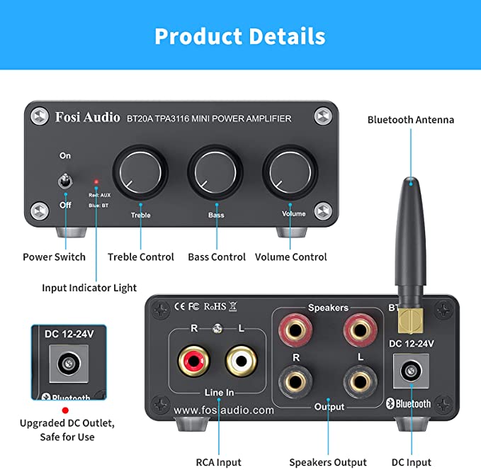

I've looked at the components, JMF, and can confirm your statement as well as adding images for future reference.

To be fair, the TPA3116 chip is only rated for a 4ohm load on 21V input and running a 24V powersupply as supplied by Fosi is a bit naughty and technically overloading the amplifier. It will allow more current and more power on a 4ohm load than the chip designers have anticipated.
The chip even has a mode which 'simulates' a lower voltage powersupply by clipping the signal early to limit the power/current for this exact scenario:
7.3.4 PLIMIT Operation
The TPA31xxD2 family has a built-in voltage limiter that can be used to limit the output voltage level below the
supply rail, the amplifier simply operates as if it was powered by a lower supply voltage, and thereby limits the
output power.
We don't know if Fosi have configured the amplifier to use this feature.
As to if you could manage to let out the magic smoke in short order by running those speakers on that amplifier, I doubt it. Put it into thermal protection however? Reduce it's lifespan by causing it to run hot? Maybe.

Amplifier: not yet decided, maybe (Fosi Audio BT20A100W + 100W)
