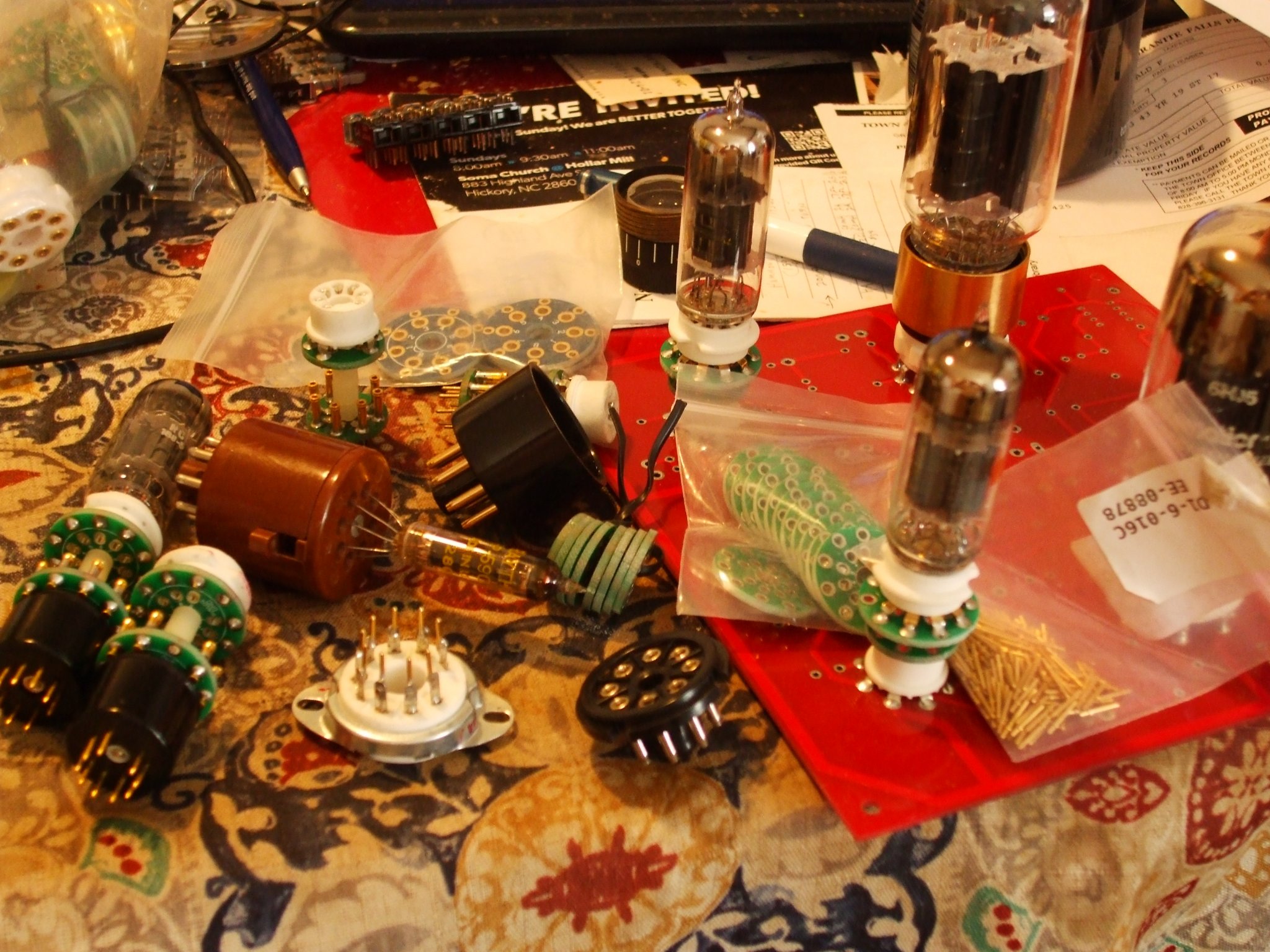

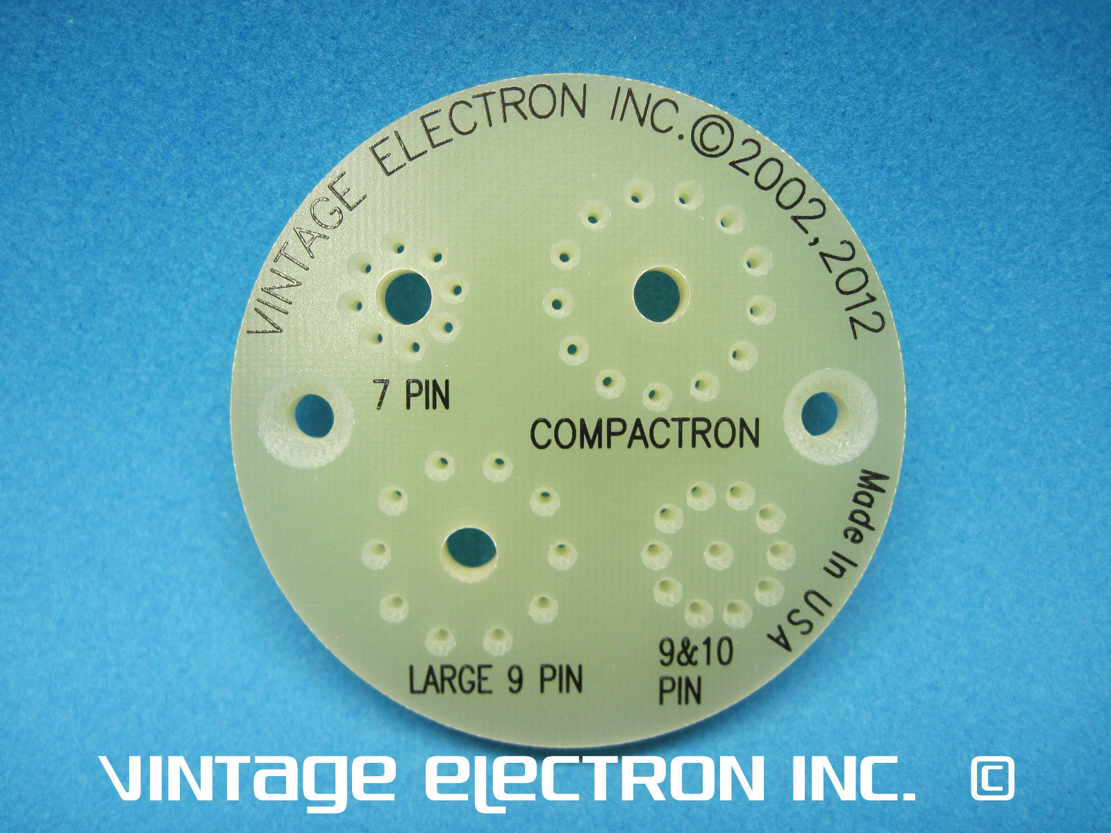

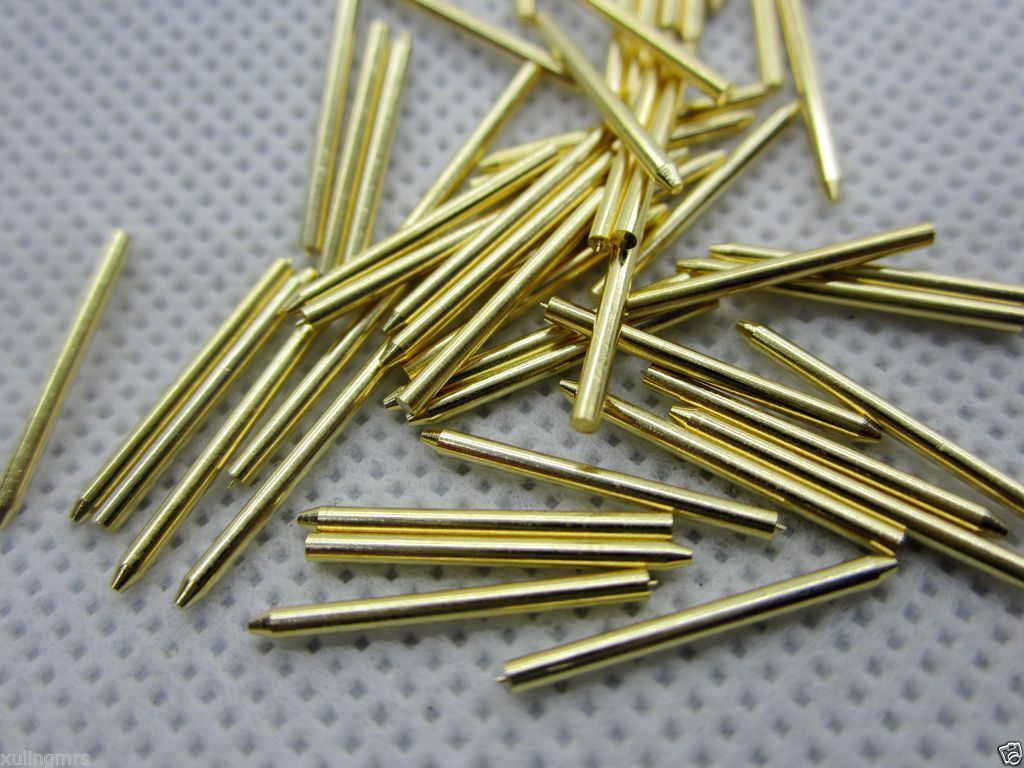

You don't really need multiple sockets for each position, just make an adapter to fit the standard socket in use. Use a pin aligner tool to hold the pins in position in an adapter PCB for soldering. Using 2 stacked adapter PCBs allows changing pin configuration with short wires.
