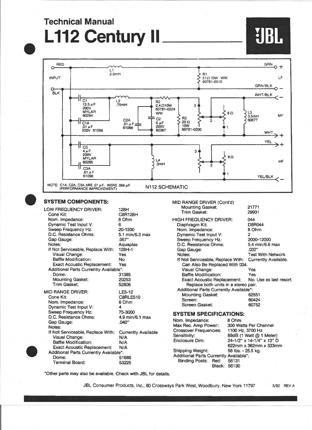

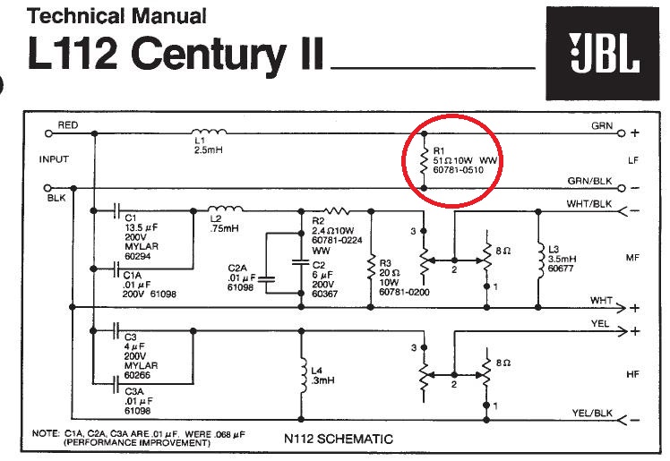

Here are the schematics of JBL L-112 Century II. Could anyone please tell me what is the duty of a 51-ohm resistor in the woofer section?

It may either be to dampen the impedance peak(s) at the lower end (I think it is a reflex box which has therefore two of them) and lower interaction of this with the 1st order crossover (as mentioned by PKI).
But it could also be to reduce interaction with the crossover caused by the rising impedance at higher frequencies due to Lvc.
Regards
Charles
