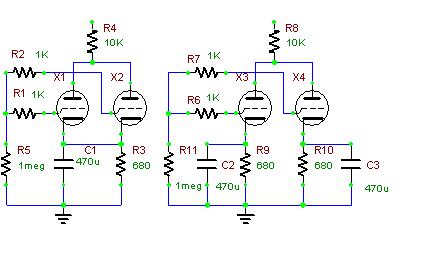

2 in parallel will give half noise and double the gm (gain). The usual method is to tie the G, K and A directly together. I'm not sure of the good or bad effect of having separate cathode bias circuits.
Ashok, that's correct, the noise of each section is uncorrelated, so you only get 3dB noise improvement from paralleling. Separating out the bias won't really change that.
There's no reason from an electrical standpoint that a parallel arrangement should sound worse, but I admit it's entirely possible to cause issues because of layout, grounding, and the like when doing that with actual tubes and wires.
ashok said:Which is a better way to operate in 'parallel' ?
Depends of the tubes gm in the sum. Separate cathode resistors increases the operation point stability (decreasing gm for DC).
The "borderline" is IMHO a gm > 10 ma/V for the tubes in parallel.
Andreas
IMHO, paralleling tubes equals increasing the max power, the slope, and reducing the internal impedance (in a rate of 2 for tube doubling) . But the "single plate" of a 300B for example is by itself a twin plate 😉 as the 6080 is 😀 one "right" anode , one "left" anode together tied , around a single cathode
I used up to 4 sections of 12AX7 in parallel in some of my early phono pre-amplifier designs, this in and of itself resulted in about a 6dB improvement in noise performance.
The design only proved to be tolerant of mismatch between sections when individual cathode bias resistors were used. (higher distortion and lower gain without individual biasing)
The source impedance of that first stage was 1/4 of what it would be with a single tube meaning that the passive eq network could be scaled downwards accordingly which also resulted in some (significant) improvement in noise performance.

1) ...but surely tubes have such wide tolerances that two or more tubes of the theoretically same type in parallel will all be exibiting (slightly or widely) different characteristics, so will that increase distortion?
2) When paralleling tubes in a line stage (such as is done by CJ) which parameters require the closest matching for best objective performance of the completed stage?

I parallel triodes all the time, mostly for power duty though. I use current sharing resistors on the plates of about 10R to stop dumb oscillations.
Matched Parallel Tubes are not always matched for all circuits, currents, and voltages.
For Fixed Bias, use separate cathode sense resistors, and separate grid bias adjustments.
For Self Bias, use separate self bias resistors each with its own separate bypass cap.

Using proper techniques, they generally do not have to be very closely matched.
But they should at least pass reasonable tube tests well.
One important thing that was discovered in the tests that became the magazine article. . . when you combine the plates to a 1/2 impedance and 1/2 DCR load, you must not connect the cathodes together (to a common 1/2 resistance self bias resistor).
Using a common self bias resistor absolutely requires Very close matching of the tubes, or the harmonic distortion will have anomalies.
The most common causes of failing to get good sound from paralleled tubes are:
Not using separate bias for each tube
Not using 2x the driver current capability (increased capacitance of the driven stage)
Not using a transformer load that is 1/2 impedance and 1/2 DCR
Not using a transformer that is 2X watts capable
Not using a power supply that is 2X current, and same ripple/regulation at that 2X level
and using one bad tube in the pair. For this discussion, what is a bad tube . . .
