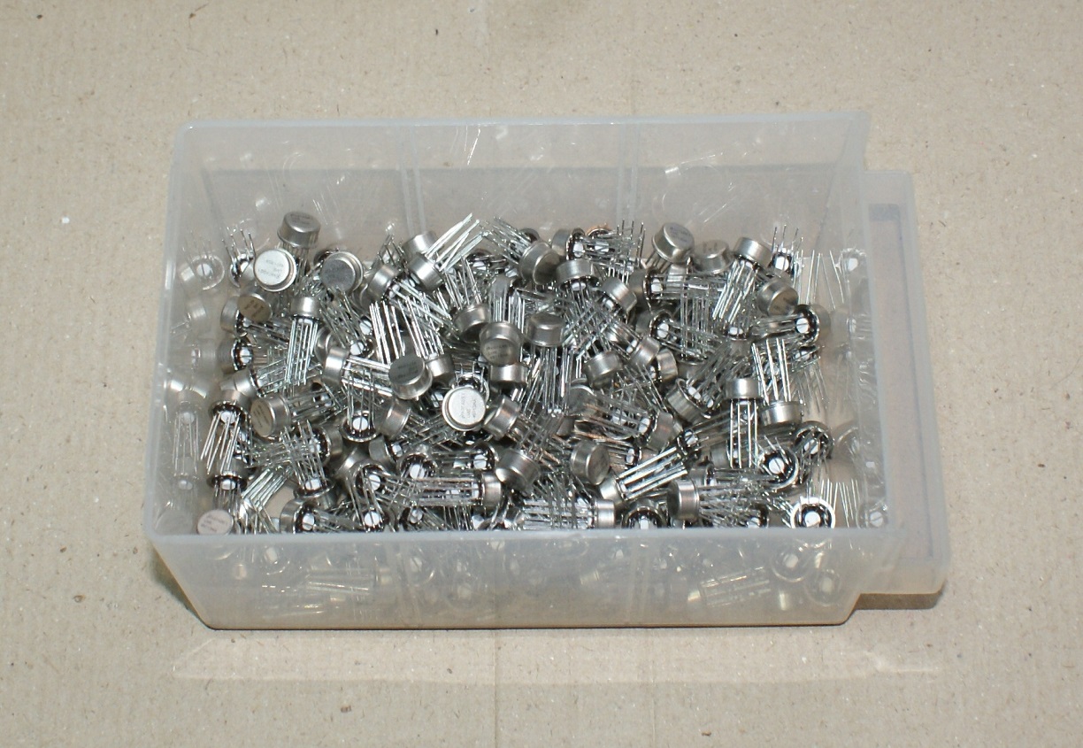

Found this thread, great. Something I always wanted to try. A few questions. As I imagine, “slave” op-amps are in unity gain configuration, right. How about using something like 20 or 30 LME49713 TO-99 metal can op-amps per channel as slaves.. Those are high-quality and 100mA output current, Current Feedback. TO-99 would be very nice for cooling. Could use some of them for something... exotic..
