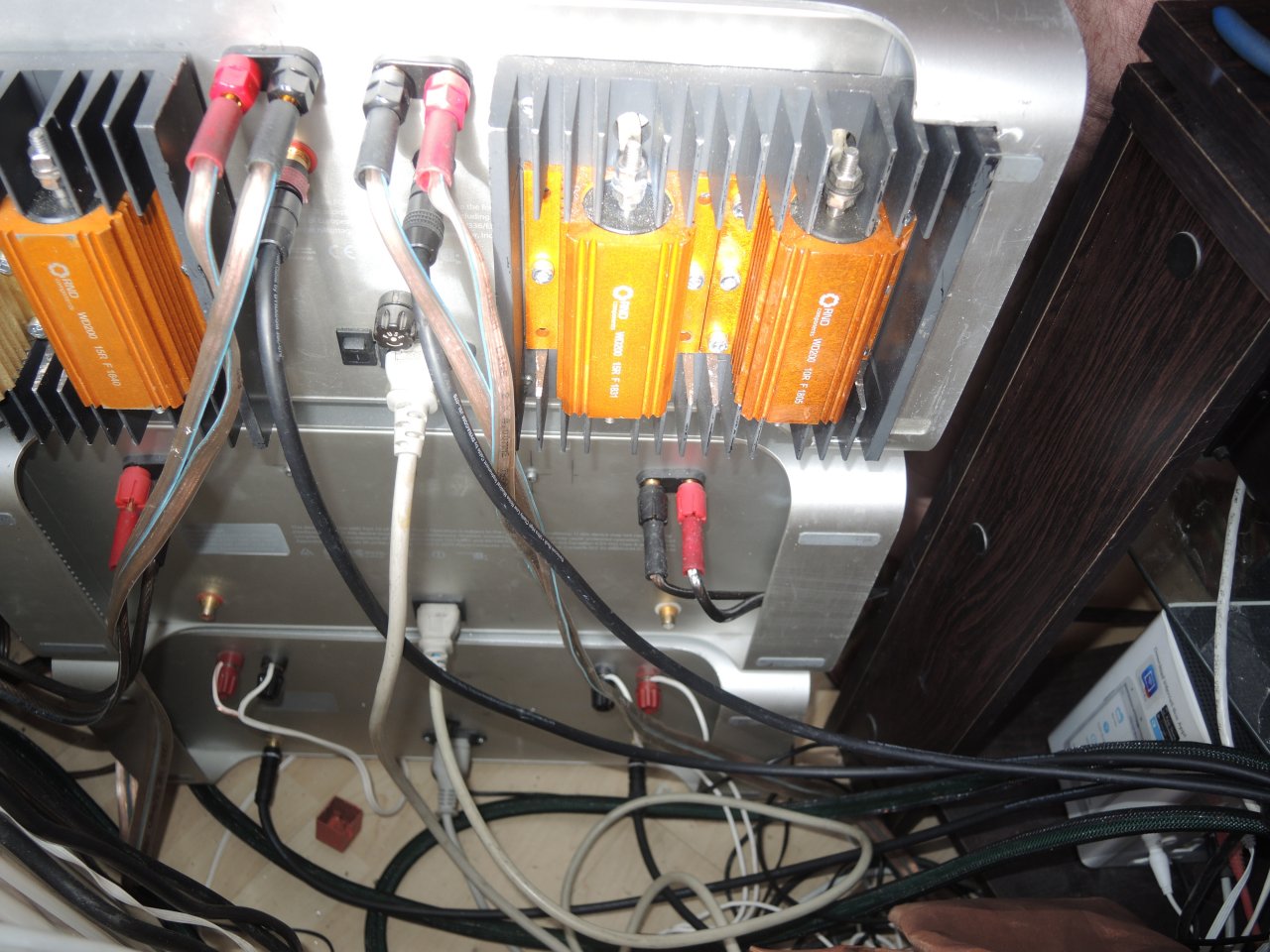

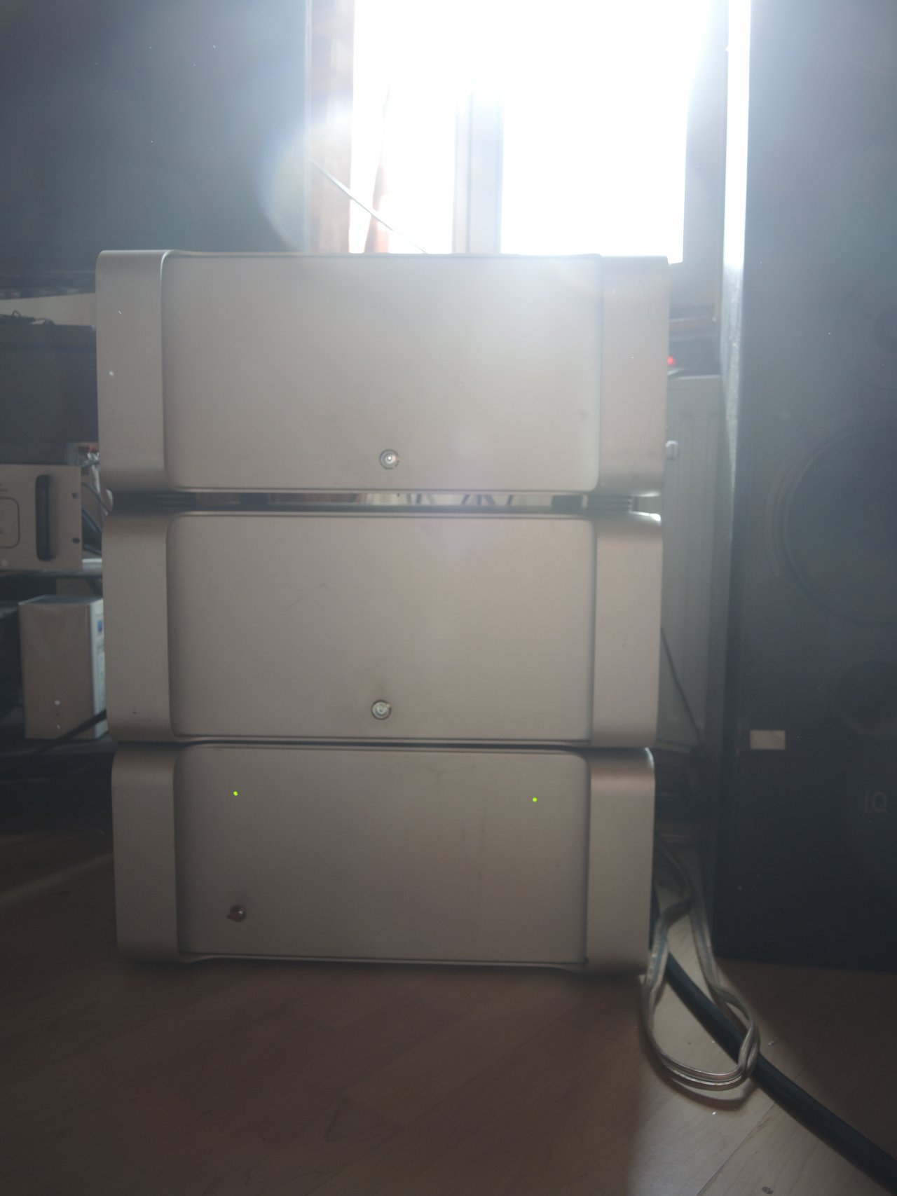

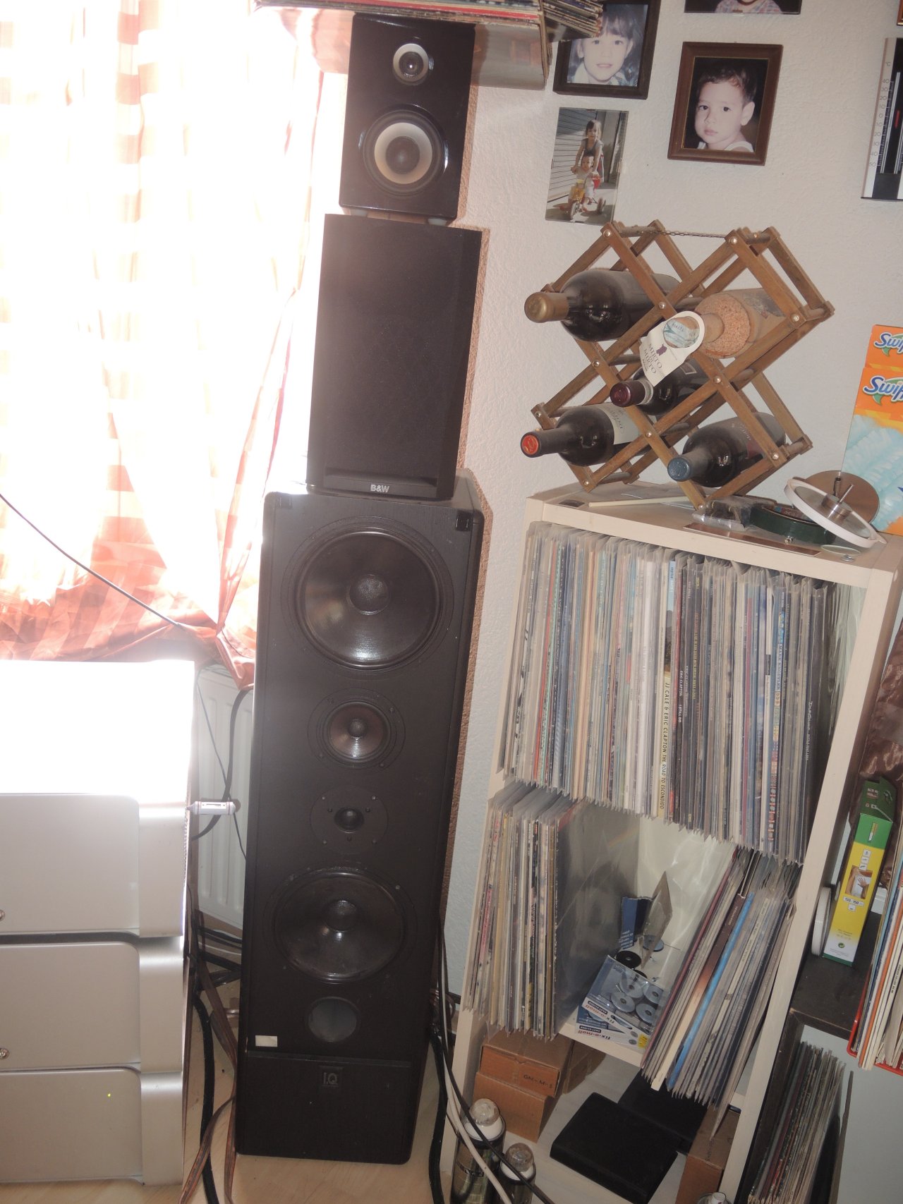

The top one is Class A - Build 2020 October and Exchanged the AMPS inside to newer Version with more STABLE POWER @2Ohms using 6Parallel Output Transistor instead of only 2. almost same circuit of the one in 2020..I installed the AMPS 2 week ago if I remember right. Driving the IQ4 Series Speakers with 3.8 Ohms measured at the Port of the Speakers. The Drivers are all VISTA Speaker. this Pair has been build 2002 at least from what I know. Never been repaired all original, very good sound
The middle Amp is driving the Shelf Speakers, the 5 inch are SERIES 2000 B&W very good also, never repaired as well
Both of these Amps build in 2013 respectively in 2017 I have already placed pictures in an other thread of mine.
The top speakers are unknown brand, got them from a friend and these are connected with the B&W in Parallel, so there we get 2.5 Ohms, running on the middle CLASS A - also Single end but with Common Current Source instead of the Resistors you can see on the Single End of 2020. This one has been build in 2017 September, and since I took some of the DESIGN from the AMPLIFIER from DOZ designed by ROD ELLIOT, Australia, I send him all the new Created Circuits to look at. We had a nice talk about it.. So he knows that some of his Thoughts are in two of my Amps, even it's only a Gain control of the input..but it's his design so Awards please to him.
The Amp on the floor is about the same as the one in the middle and was build 2013 - same as the one in the middle it has some designs of ROD ELLIOT involved, partwisely in the INPUT STAGE, Output common current source is the right Name I think.
both of these CLASS A running on +- 48Volt Rail voltage, with 2AMP bias for the one on the floor and the one in the middle it's BIAS is 2.75 AMPS and it takes 3 Fans / Side to keep this one COOL @80Degrees Celsius. But I had this one running on 120degrees Celsius and more and it never broke down. Output Parallel 10 Pieces MJL4281 Per side, as most of my amp..
The one on the floor is running the Speaker in my Bedroom, just small ONKYO 5 inch Shelf Speakers 4 Ohms. I have another class A in my Bedroom to listen too but the FANS are too loud when listening for a long time, and that's why I use the one in the living room running 10 meter Loudspeaker Cables.. And this one is controlled via Remote control to adjust loudness.
