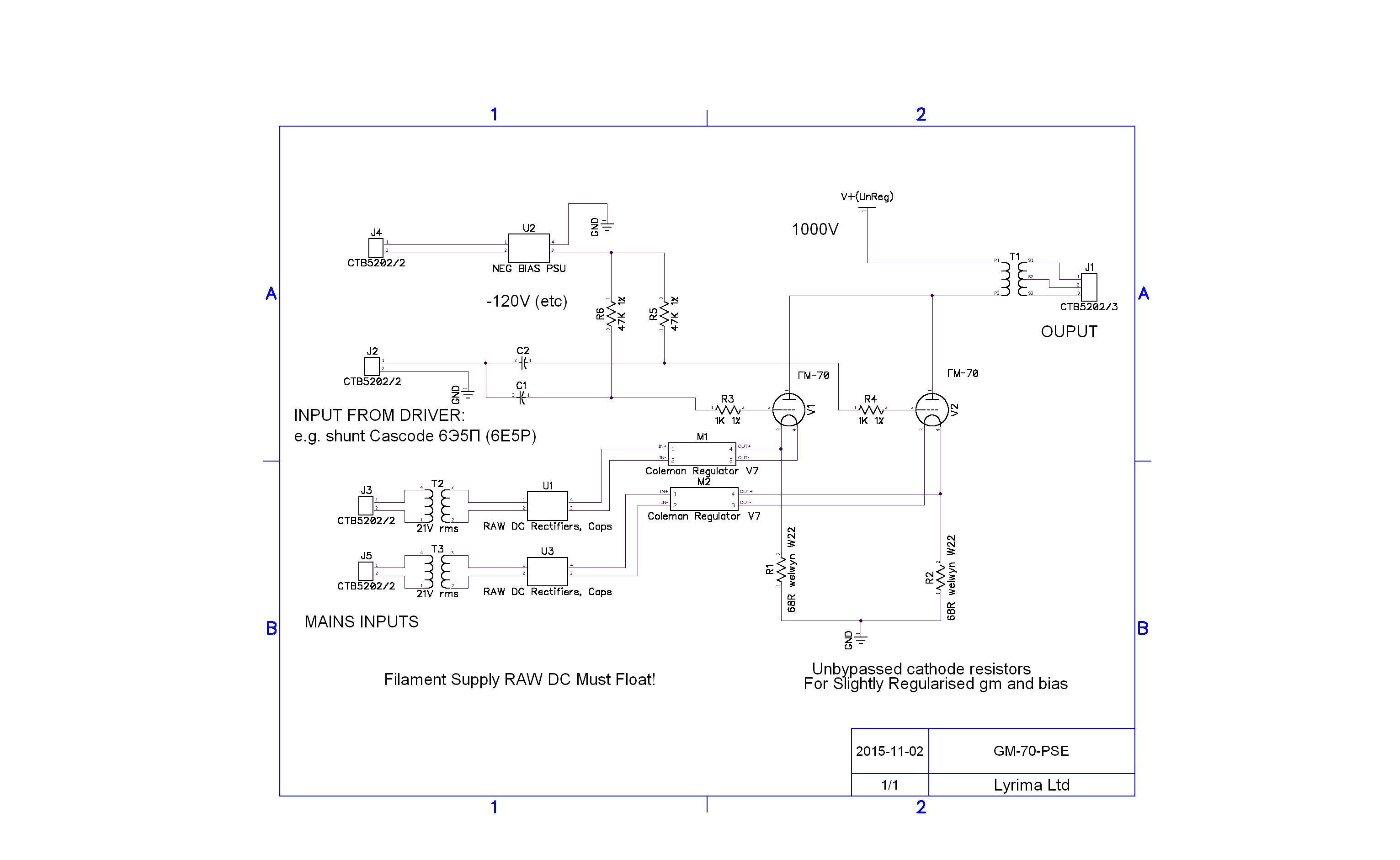

You can also force the gm and bias to match a little better with some resistance is the « cathode » return connexion. If this is unbypassed, it decreases and converges the gm, slightly, and should help counter the distortions.
My schematic shows how I do it...

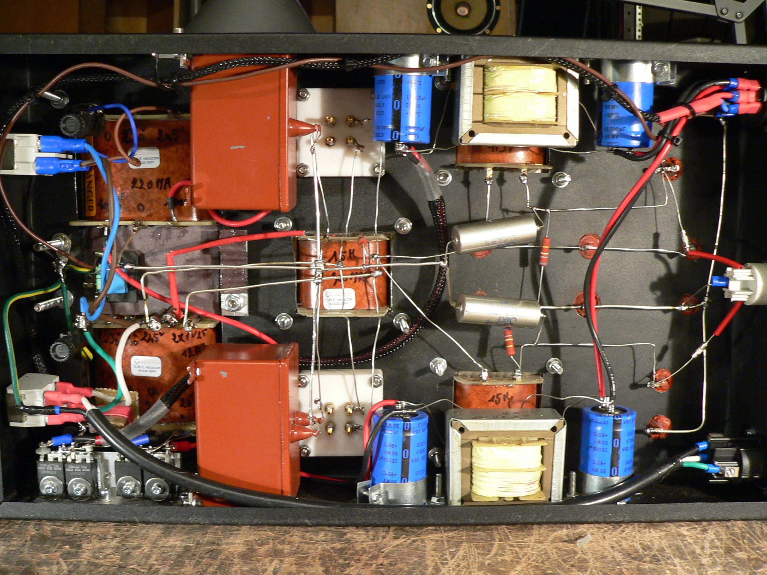

Here's a couple of pics...I'm almost finished drilling the chassis. I will post more later and schematic and all that as I get into it...for now just keeping on this parallel/balance/distortion topic. One thing at a time 🙂 Thank you very much for the interest though, like I said more to come and I'll start another thread for it. Hopefully the pics come through Im on a phone right now.
So while I wait for Kevin, I'm also curious Ron how did you arrive at those values for the Cathode resistors? I will probably have 2 in series as one will be a smaller sense resistor for one of the meters (extra rounds you see in the chassis)

Loren, the resistor values were set to diminish gm by about 15-20%. Since you only want to run soft, this should be no problem.
And, yes, you can use dissimilar values, and try to match the effective gm.... or you can insert a pot for testing, and look at the output spectrum, and adjust until you like it best.
If you use dissimilar values, and optimise and adjust them, the values can be lowered, too.

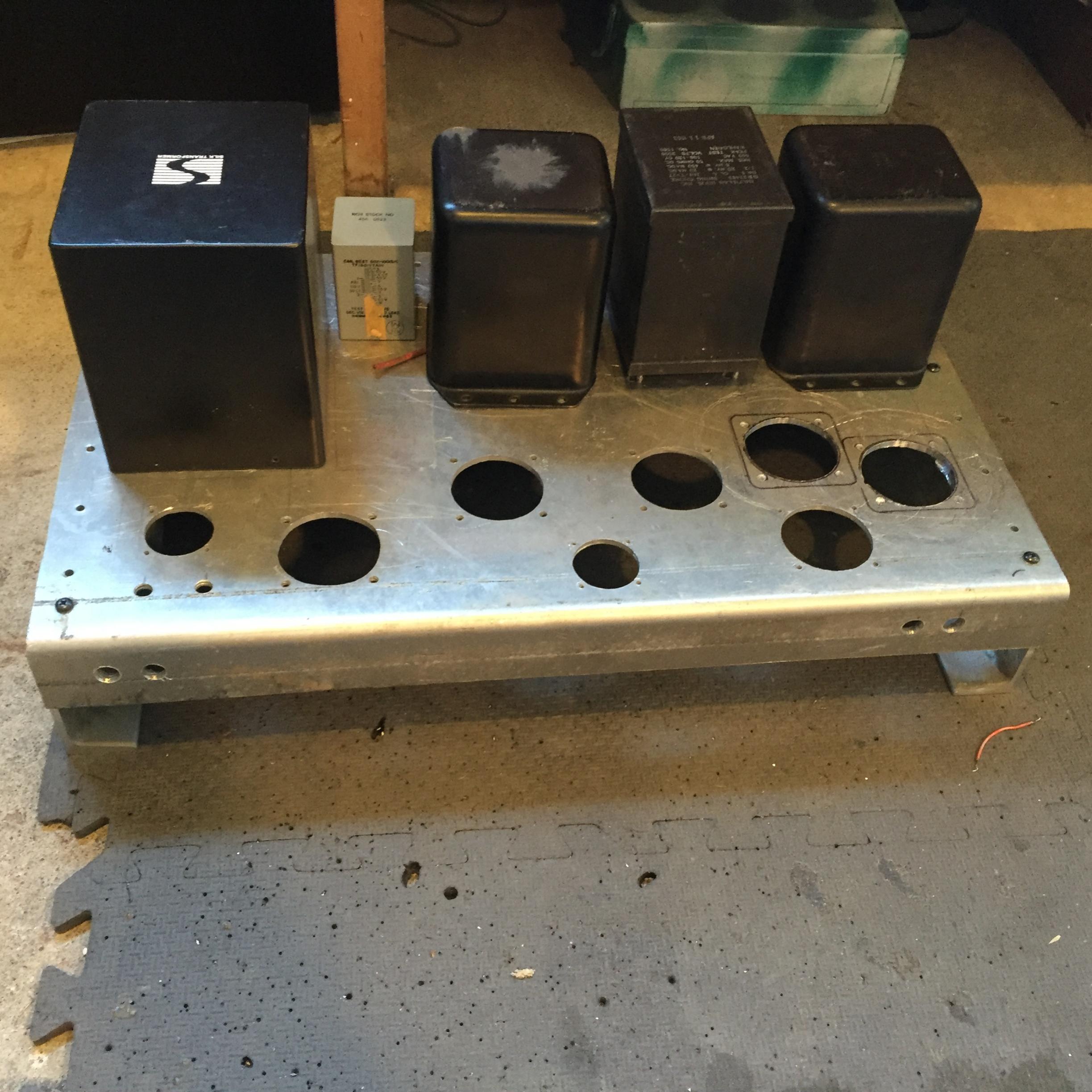

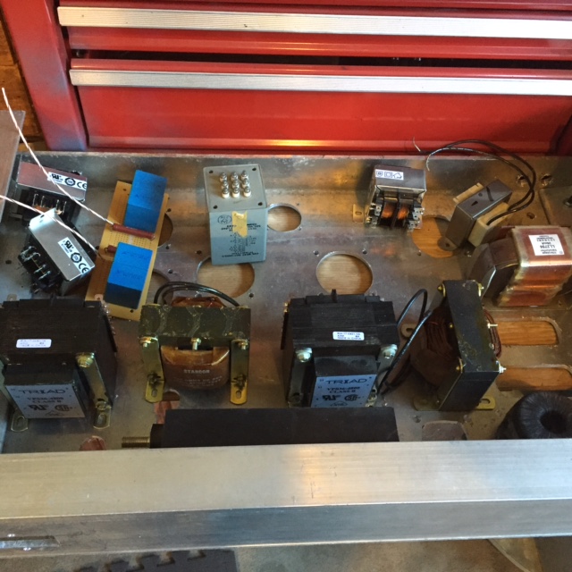

Hi all. I promised in another thread that I would start posting pics when I actually got going on this project. It's that time. Wanted to ask first though...
Anybody out there seen any schematics for a Parallel GM-70 amp? Or, any other transmitting triode parallel SE amp? Couldn't find much, and I'm still looking for more info on output tube balance in a parallel SE DHT design.
I found one amp that SILK Thailand made that was a parallel GM-70. The Glow Master GM-70. This project started because I have SILK Parallel GM-70 OPT's, otherwise I would have just done single SE. Anyway, the Glow Master has amazing specs. Full power is around 60W with 1.58% almost all 2nd order. 1W is a staggering .079....very impressive. And they are using 3 stages, with IT and then Cap coupling, where as I was planning on 2 stage IT.
So yeah, I'll start posting some pics. The HV, bias, and heater main supplies I already have PSUD'd, and laid out, so I'm starting there. But if anyone has any Schematics they'd like to share (Silk hasn't responded, and I doubt they will), I would sure appreciate the comparisons.

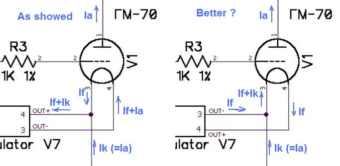

Those polarities look somewhat odd.Perhaps better like this ?My schematic shows how I do it...
Direction of the arrows not conventional(+ to -) but electron flow (from - to +).
Mona
Don't know if it is better, but your suggestion is generally how I do it in my designs, and with GM70s. It does have a pretty significant effect on the level of grid bias required. (Reduces the voltage required at the grid as opposed to the way Rod suggested, enough so that when I built my amps I had to tweak the bias divider/pot ratio to get the voltages into range for the target plate current - I missed it by a pretty significant margin, must have made a mistake in my design analysis or calculations.) EML also recommends the negative terminal of the filament be grounded. (I use the 20AM in one of my designs)
