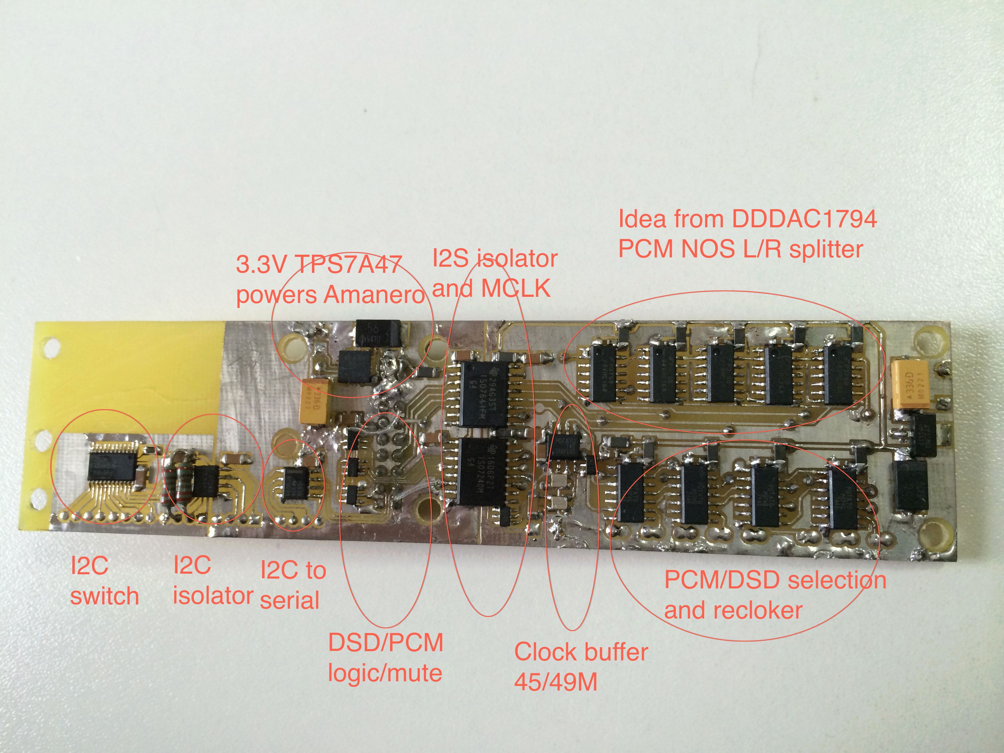

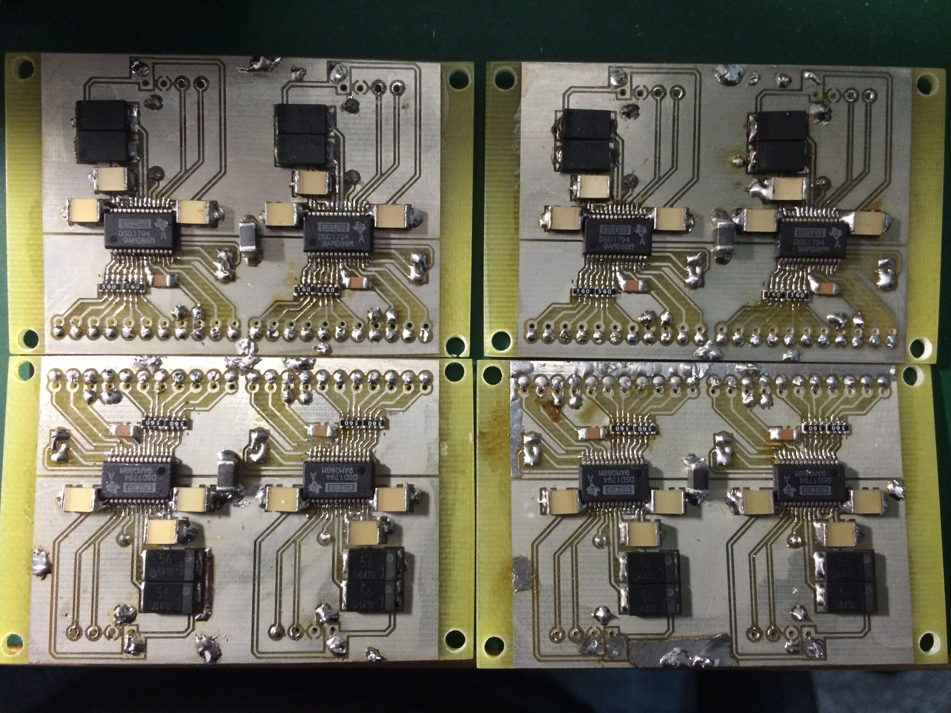

Parallel DSD1794 NOS/DSD passive I/V
Just for fun and sharing the experience, borrowed the idea from DDDAC1794 to run NOS mode to support 24/384K meanwhile also support DSD, worked out with PCB with DIPTRACE, doubt it's optimized, while looks better than P2P.
