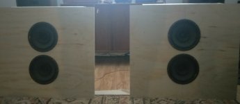

So, I aquired two pairs of Ciare CH-250 from the Bay a while back. These are an 8ohm version that is not listed on the Ciare website. I did check and they are not the PH-250. So, since I have four of these I plan on putting a pair of each in parallel on a JE Labs style open baffle and power them with my 45 amp.
Any thoughts on how well this would work with a flea watt amp?
I am eventually going to order a pair of Eminence 15a woofers if I like the OB sound. Hell, I could order four and parallel those with the parallel CH250s with a passive series connected crossover😀
I was previously going to use a JBL 2155H 15" coaxial driver for the OB, but decided against it due to the lowish QTS and I didnt want to waste a $50 sheet of plywood.

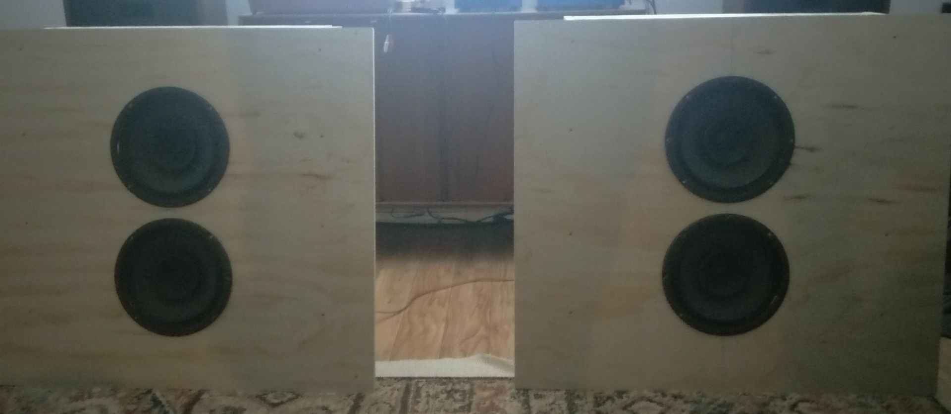

Wow, these sound soooooo good, I mean seriously! I don't know why people complain about bass from open baffle, I love the bass! My 45 amp has no problem driving these to decent volume!
So, I'm loving the sound of these, but want to take it to another level. I would like to build another set of OB, but this time use 2 15a woofers in parallel and 2 ch250s in parallel per channel, but not sure how to connect both to reflect 4-8 ohms. Could I series connect the two pairs with a low pass on the woofers for an 8 ohm load? I want to parallel the drivers to further increase sensitivity for my flea watt amps.
Also, I don't care how large the baffles will be
