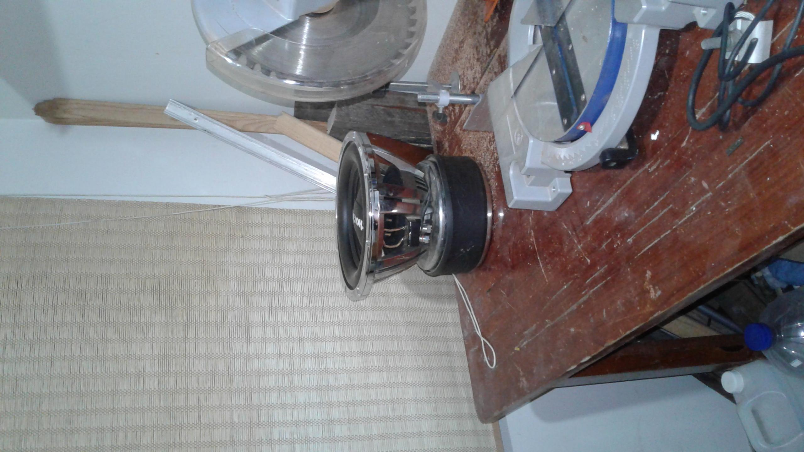

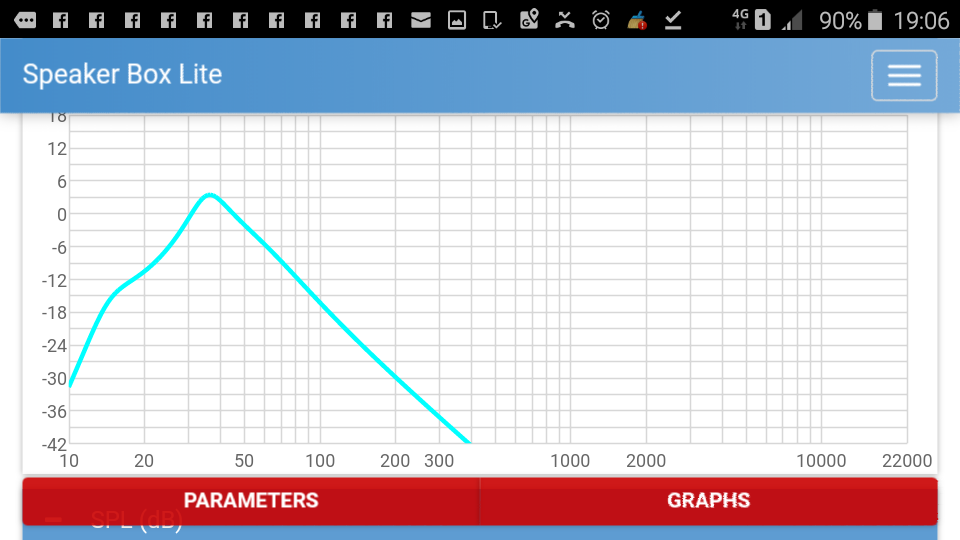

Parallel 6th order boxes seem easy to acomplish starting from sketch and calculations from online sub calculators. By now I had this idea of going down further in my fullrange. I have a post on the sub build pictures thread of my horned sub box. Its is astonishing, giving TRUE 50Hz it produces wind sounds, but it can't go really below say 40Hz. So my plan is to use a 2500-5000w (nit sure the rms rating its just ridiculous. I initially had a pair but gave away one to my neighbor cuz she helped me unloading some stones I managed to pick from my city) 12 sub in a 6th order bandpass with bandwidht from 20hz to 40hz. The compartiments are 50L and 80L. The online sub calculator plotted a graph where this range is well bumped to somewhat like 6 or 10dBs!

I will post the graphs soon.

If the port surface area is large enough, to keep the velocity of the air inside the port, below 5 - 10% (depending on application) of the speed of sound, no wind-sound.
The system doesn't guess, you are. The program just translates your guess for what the ports and chambers should be into a result. If you guess you're unable to correctly input with said program, perhaps you're better of downloading one that can.

It's really hard to understand what exactly it is that you want, can you use bullet points to structure your goals or questions, i.e:
Also could you use neutral descriptions, for example you're saying PA but neither the driver nor the tuning, resembles anything PA-related to me.

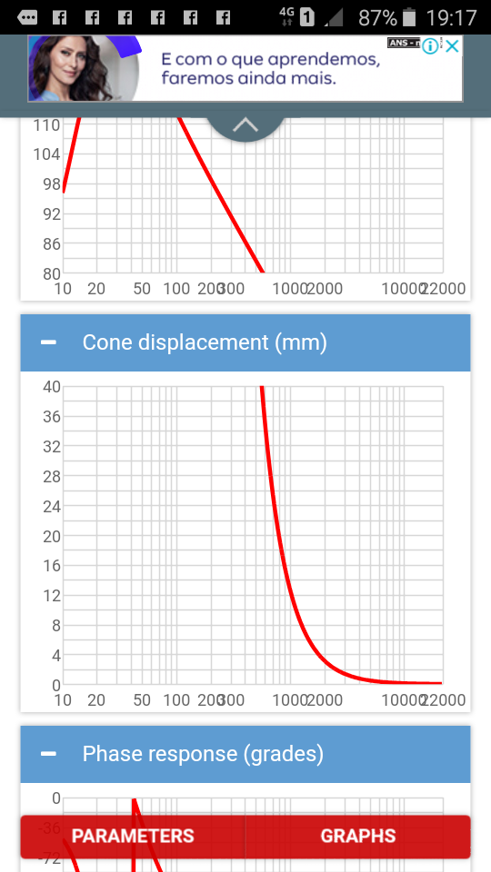

The graphs are leaving information out, leading to more guessing. Right now I would guess you're not simulating a parallel 6th order. Regardless, it would be much easier if you show your input parameters instead.
Unless you're going for a closed chamber, cone rise to infinite is going to happen. Whether that's a problem depends on your design, sound processing or playback material.

You got my point. That excursion is cone movement as limited BY THE BOX
