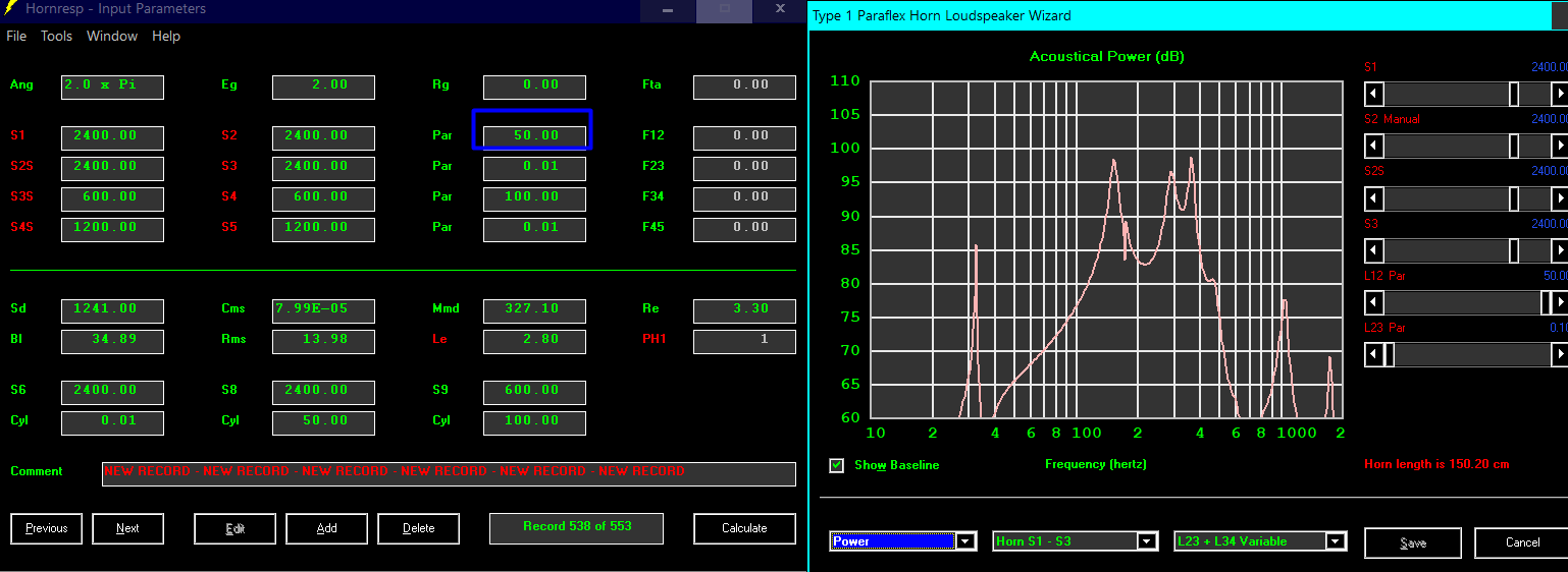

Yeah, total cancelation if matching up both sides to the Same resonator in PH or ch3 modes. I found it intersting if I swapped the driver position in either of those By 50cm(the ‘3/4 resonance’ @ ~172 hz)
its Just a math puzzle essentially, observing how strangely these hypothetical scenarios pan out and excite harmonics of the pipe but not the fundametal, etc

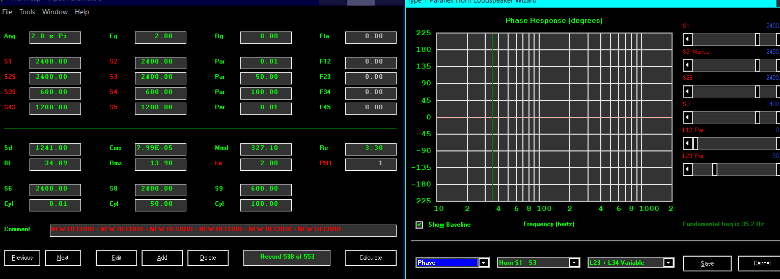

the offset driver position on ONE side brings those resonances/ frequencies back 'in phase' by shortening the distance between the other side of the driver(time of flight)?? im geeking out and exploring/learning despite my ignorance thanks to HR 😀
This is intersting since the distance between exits is well over a half wave , etc........or simple 'H' frame wave cannon?
