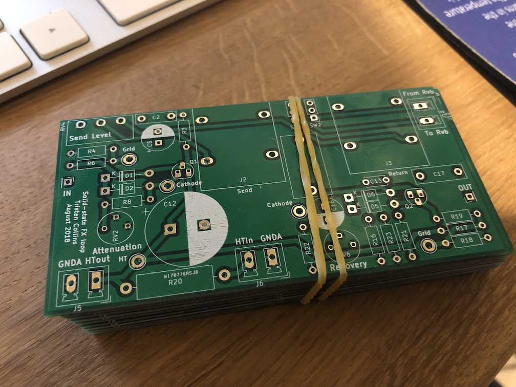

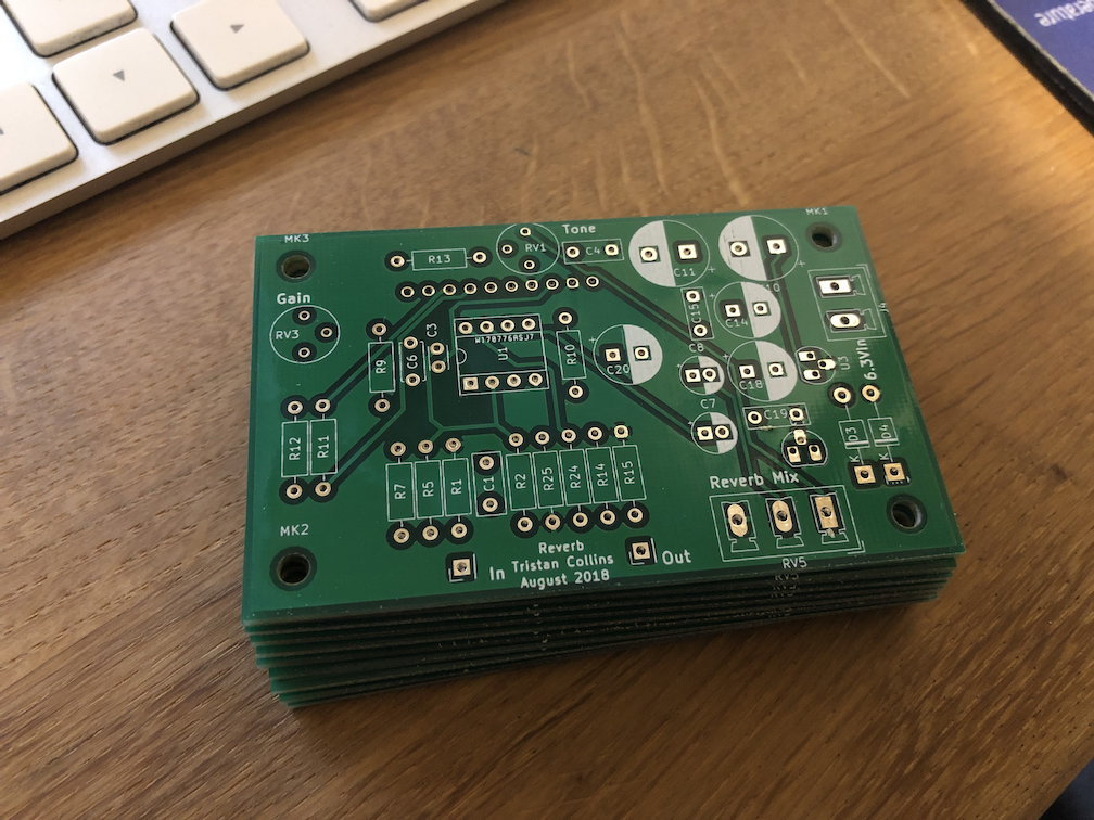

I've a spare PCB for the Belton reverb module if it'd be of use? They do exactly what you are after - basically taking a feed from the heater / spare 5V supply, rectify it to 9V and then power an internal 'pedal'. Trim pot for gain & tone (could be panel mounted) and pads for reverb mix.
You'd also need an effects loop to get the signal down to the right level. I've also got a spare PCB for that too!
Send me a message if interested.

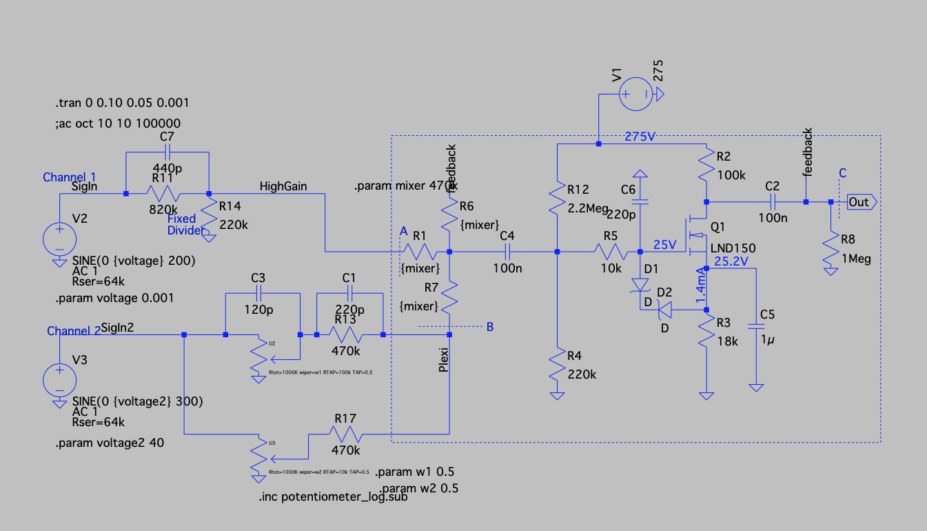

On the merging - I've been playing about with something. Was reading up on virtual earth adders and came up with the attached schematic. The idea was to mix two preamp channels with a minimal interaction as possible - and not having to use another tube to do it. So this has an LND150. All the section in the dotted box is what I'm calling the mixer. The bits on the left are the feeds. Apologies for the overlapping labels...
I'd welcome any input on how well something like this would work.
