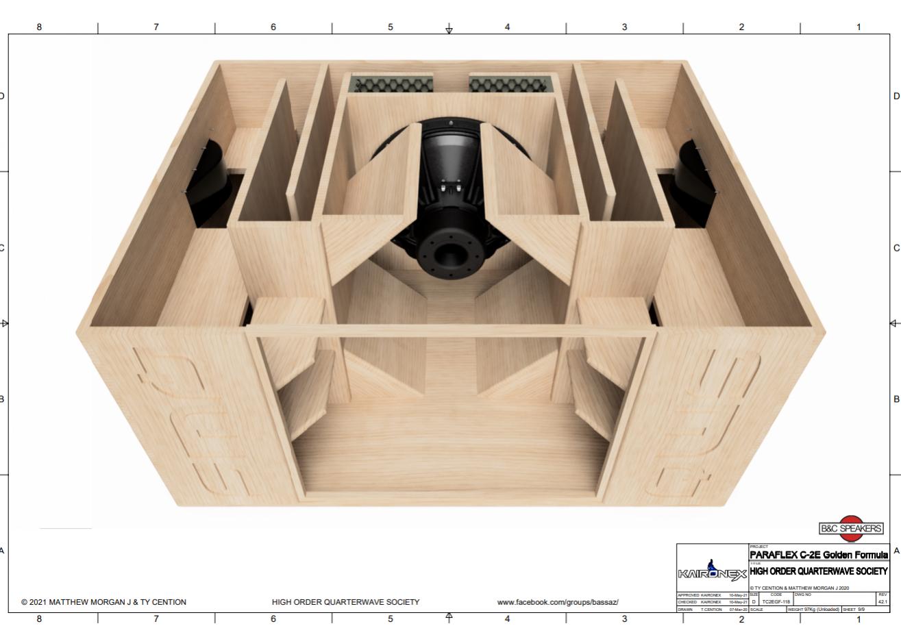

I am looking into building some Paraflex Golden Formula C-2E 1x18" boxes as they have interesting looking frequency range and performance with a relatively simple design that seems doable with my skills and tools. However I have not yet had the chance to actually hear these to see if they are really my cup of tea so to say, and the only way I have been hearing about them is through the paraflex facebook page which gives them heavy praise (with an understandable bias).
Goals of this system would be to play low bass dubstep/DNB and will be paired with JBL SRX835p tops.

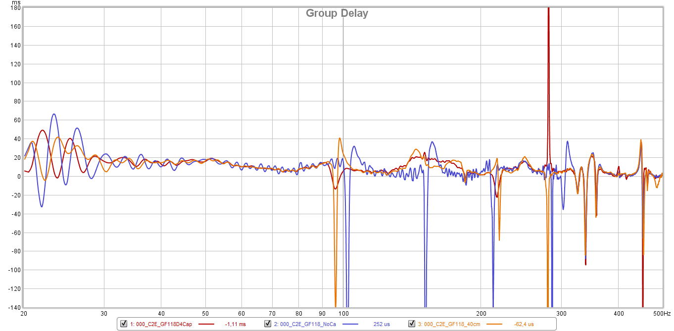

I haven't heard Paraflex cabs but the Hornresp sims should tell you almost the whole story, the FB group is a bit over the top in their enthusiasm but they are a box that will work in some situations:
1) They are physically quite large for their minimum frequency
2) They are narrow band, IE you may have trouble meeting your tops if you select a low tune
3) The drive pole vent is exposed and so any drivers that have mechanical noises have no filtering of this as would happen in bass reflex. On the plus side driver cooling is excellent.

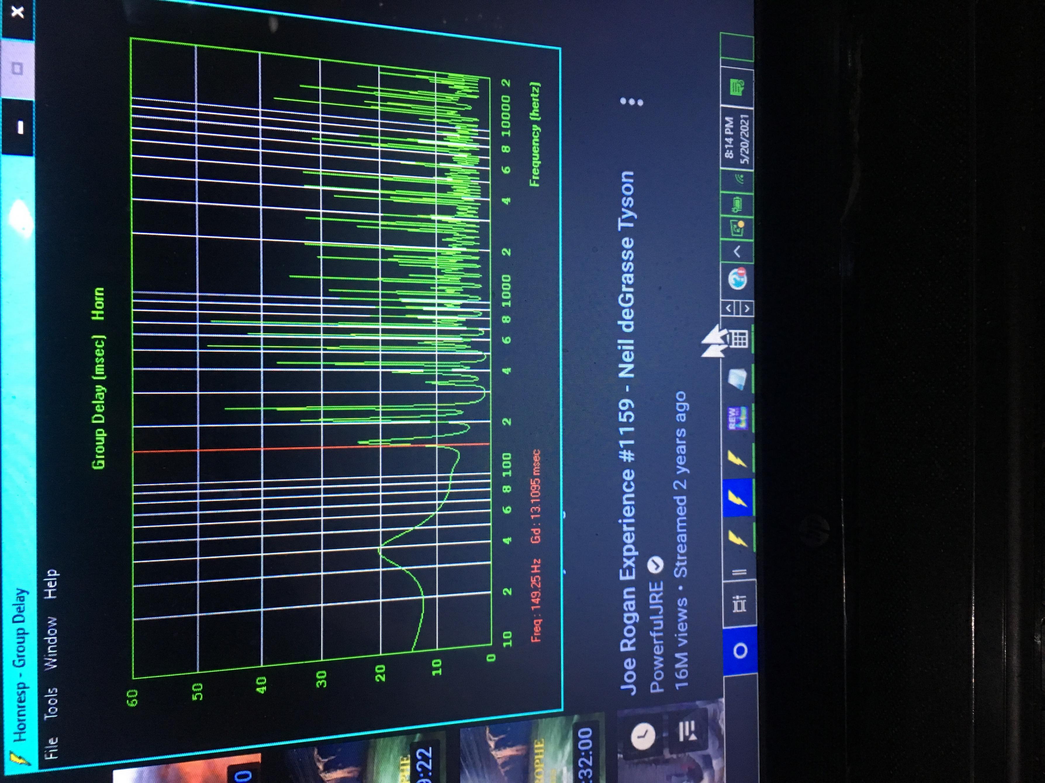

4) Group delay could be an issue for some genres, worth checking the box your building against audibility thresholds. The psy trance that tends to be the preferred genre on the FB group is quite insensitive to group delay issues.

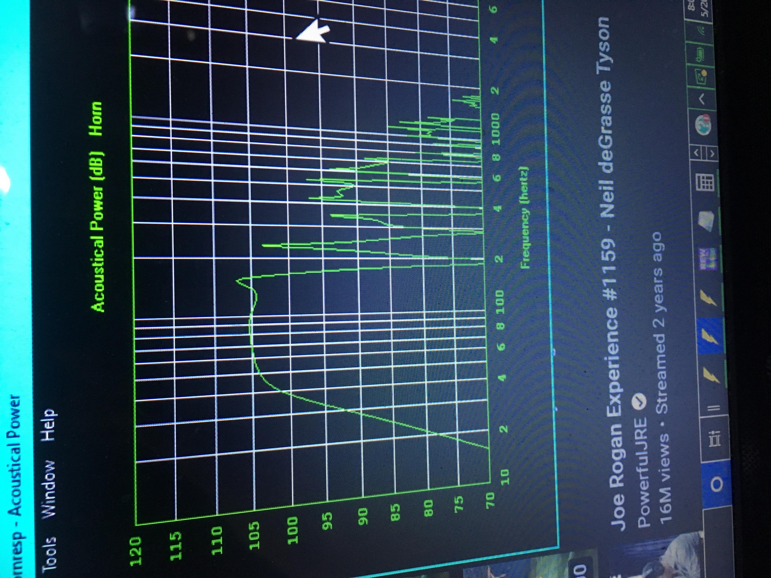

With this kind of response and the long sound pathways I can hear them now...
YEah, i know. Its a question though. Because the rest i feel is only different if we hear it. And not everyone does. But i was skeptical too. But back to back with qw pipes of a variety of use of nodes or positions of them on either side of the cone(and driver) theres what i think made an impression i found unique? Not perfect, or easy to just find. But its thst detail thats remaining maybe?
Im Suggesting things are in a timing that is stuck like our ears. Qw pipe is harmonics already, and catering to that in someway or however is also something thats either missed or overlooked or nothing at all. Not sure im
Guessing from my interpretations of harry olsons pipes? And obviously more recently mmj. But the wholevidea is clearly present in the new sim in HR. No questions left to not see for anyone to try. Theta is all i got. Parts of 45 degres into 90 into 180 into 360(shown as 720 unwrapped phase and well beyond)? Its nothing. But theres a pressure node in all that to?

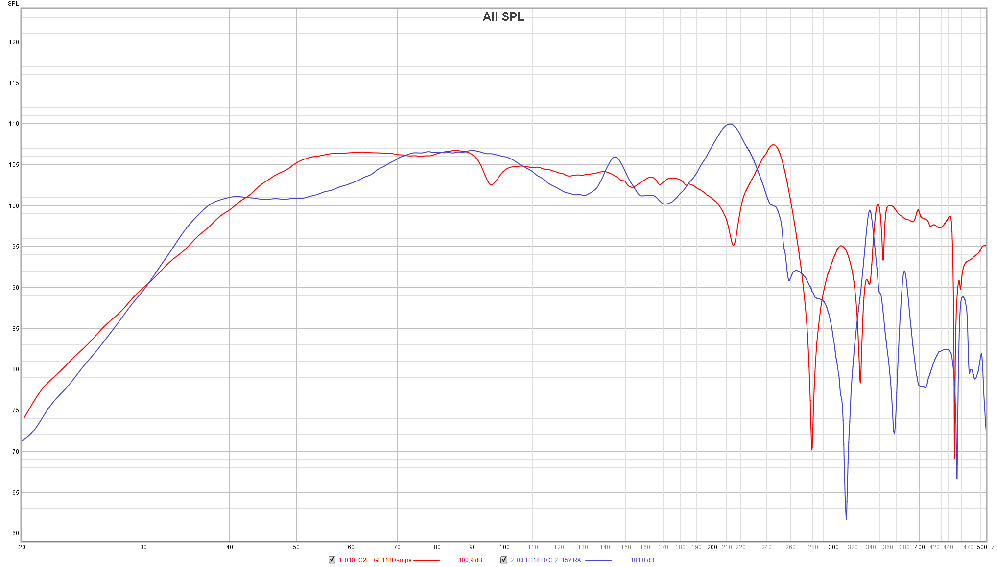

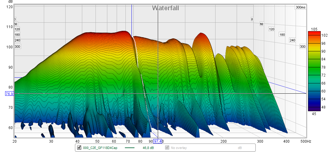

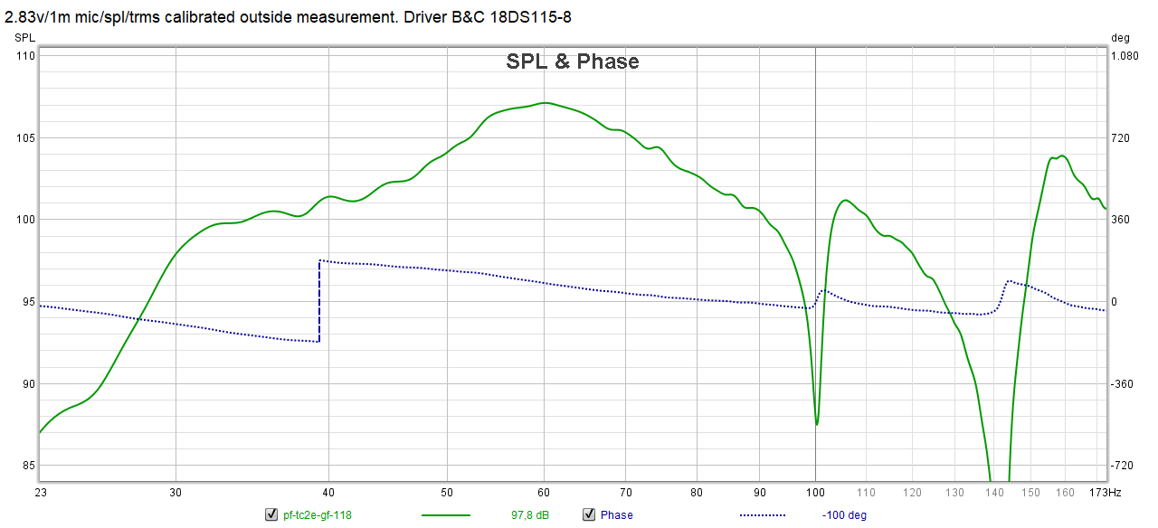

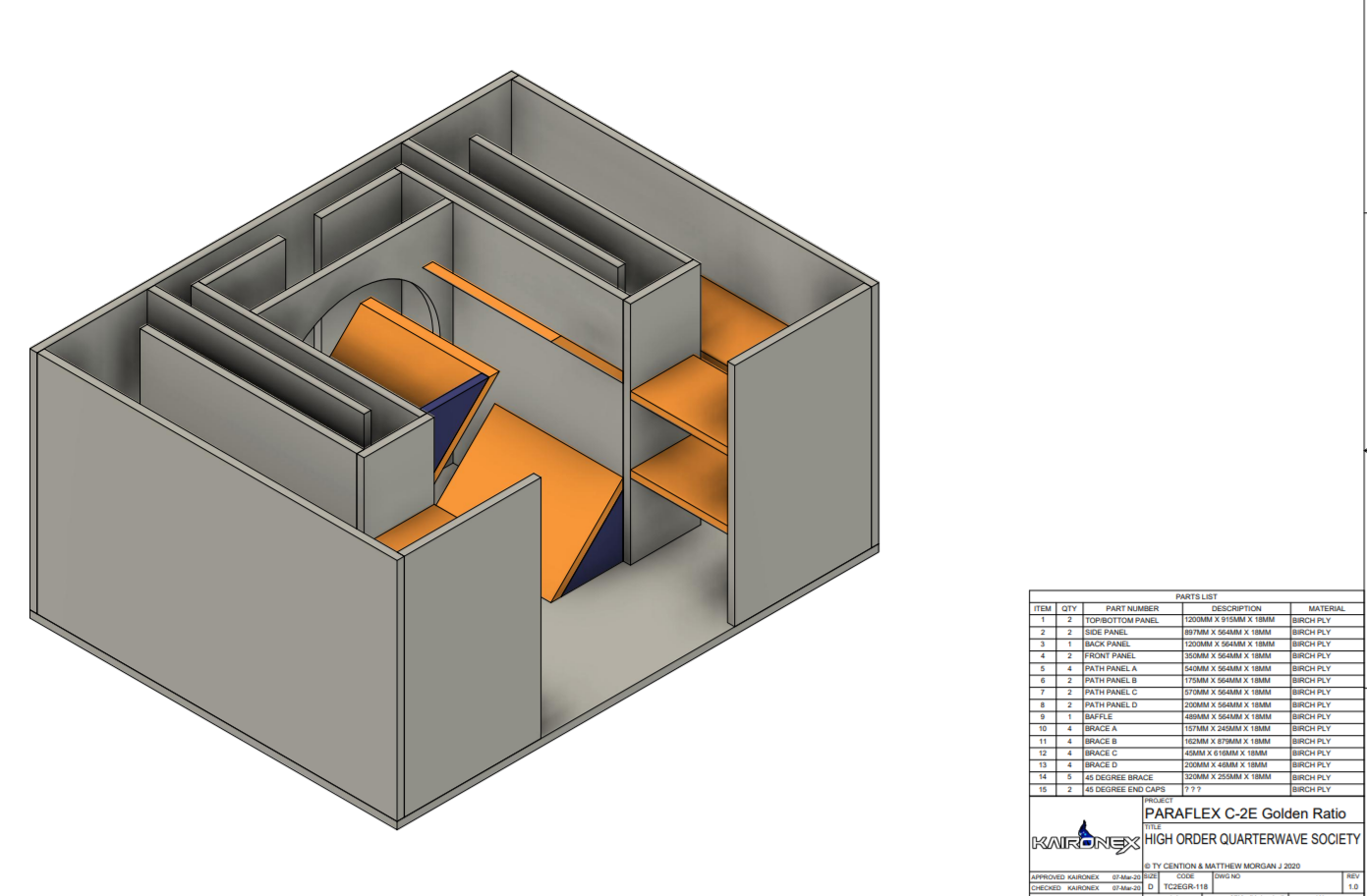

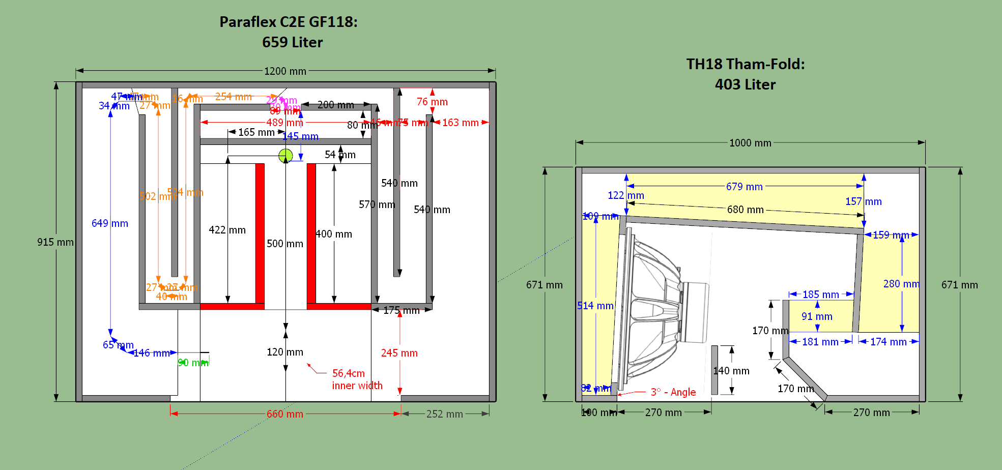

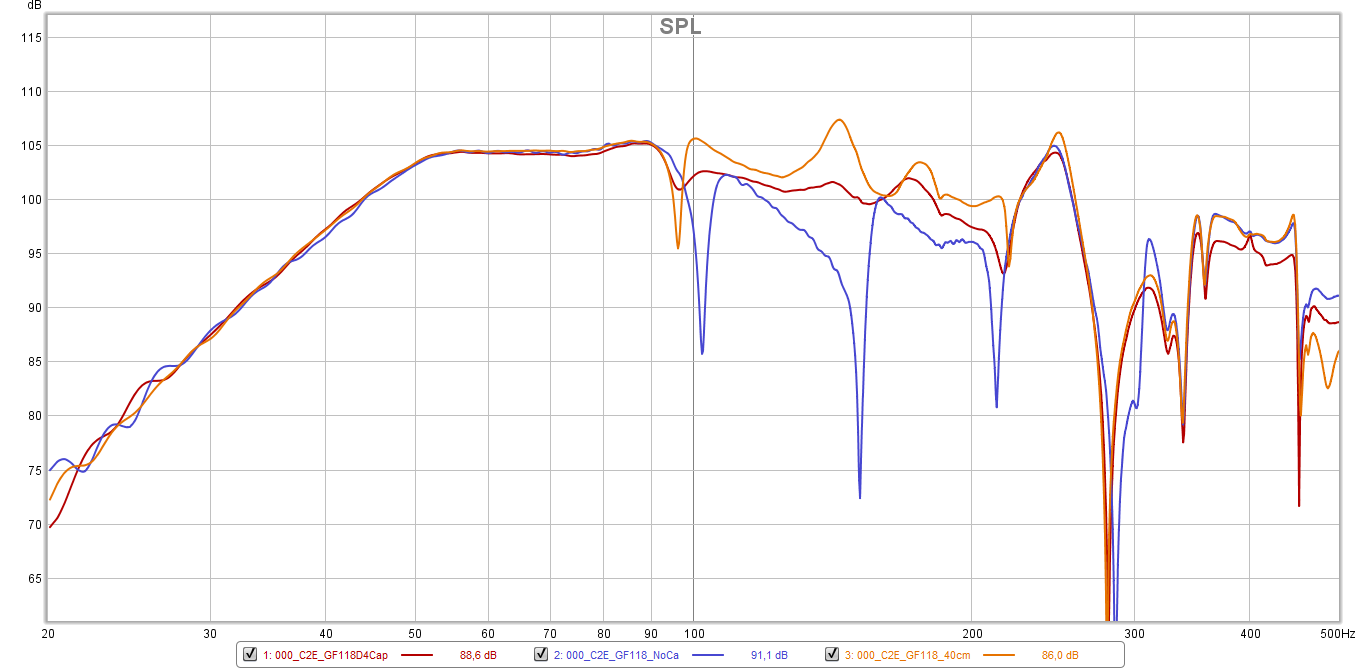

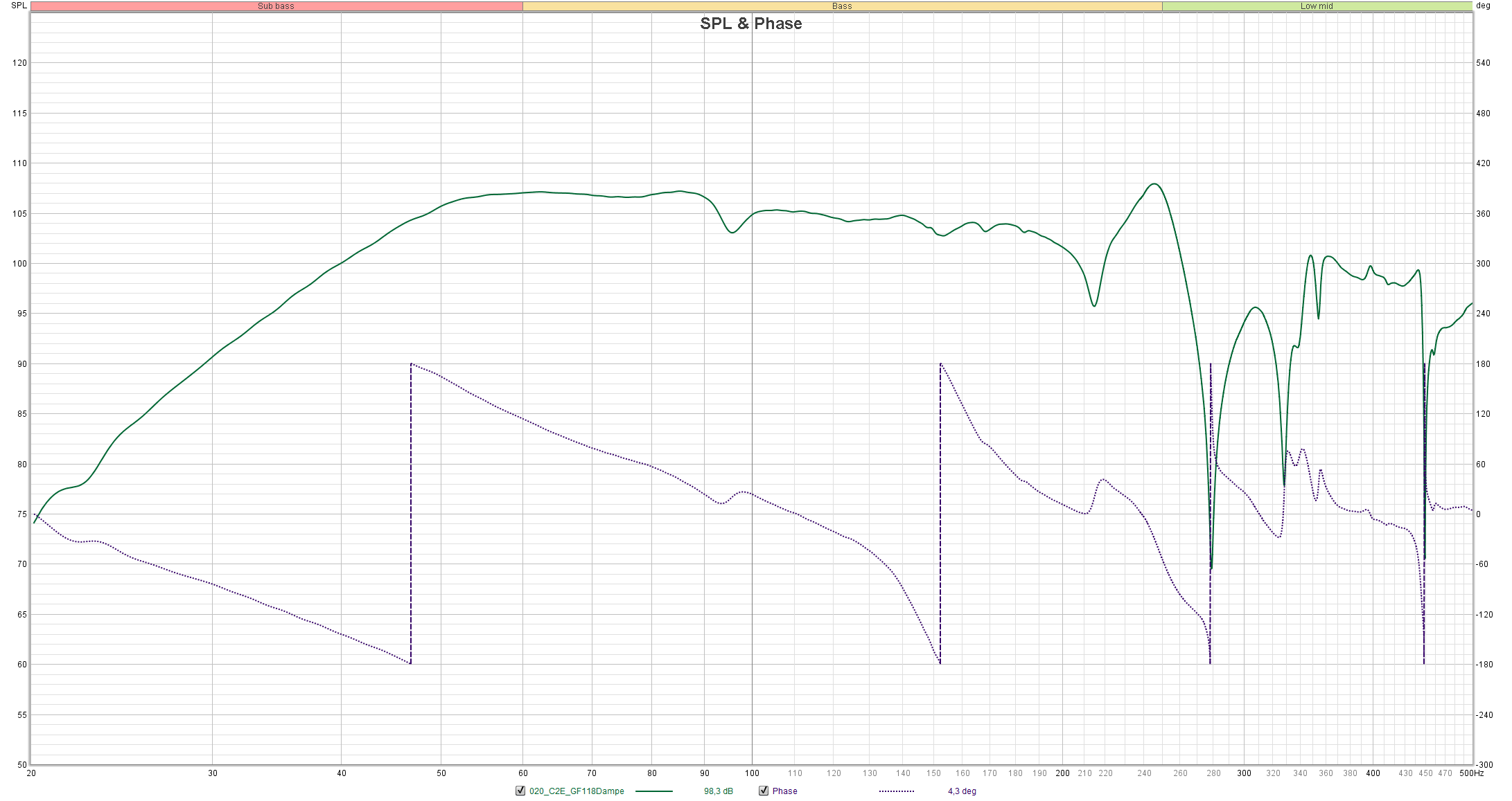

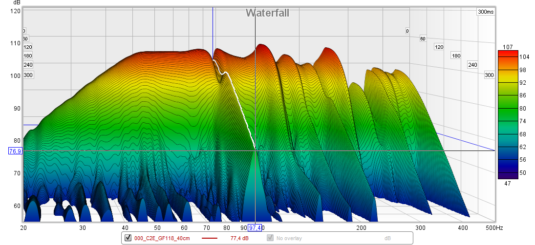

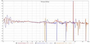

Hi all together. I am one of the Co-Designers of the C2E-GF and i did the optimizations and testings for the latest update V42.11 on the Facebook homepage.
I want to share some graphs with you, just for some "ah, okay" effects.
But before that, some notes:
Hearing is the essential thing when it comes to Paraflex Designs.
When i started building subwoofers i started with Tapped-Horns. MTH30, MTH46VS (updated to big Tham18) and that was my way to go.
Then one day i saw that C2E classic cab with centered driver and i was done - i needed those!
I contacted and joined the group, told MMJ about my target to do a very strong 50-70Hz region (what i found out sounds best for me, with my 2x12 THs that i designed ) with a C2E-look. It took some time and MMJ contacted me that he found a solution!! That is how the C2E-Golden Formular was born. First builts in the US, Netherlands were promising okay-ish. (the Dip-Issue - cancelations)

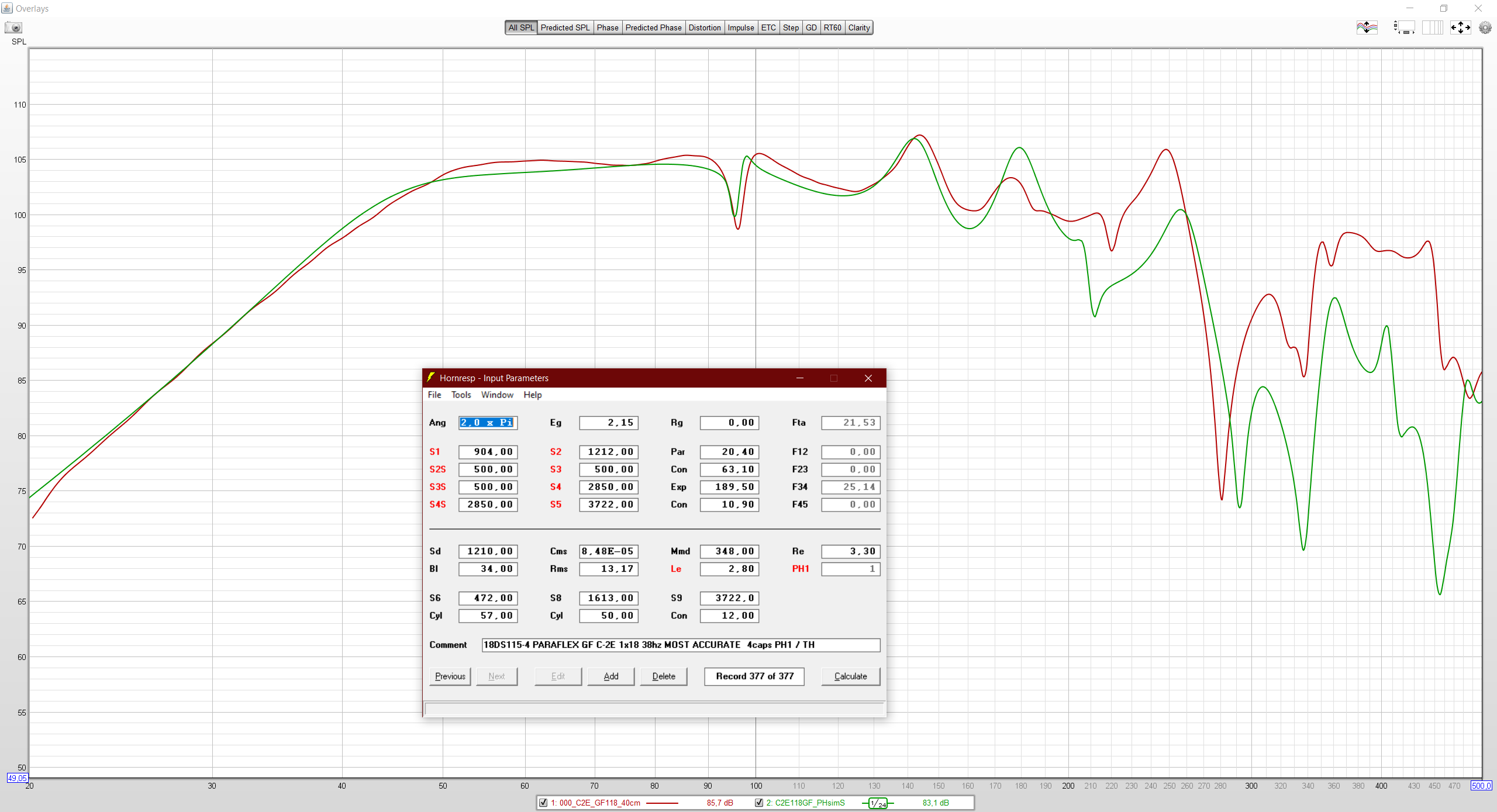

Then we started to optimize (Hornresp: TH-Mode) and did that fold in the HT-chamber. (today we know we just did the fold too short )
Since the latest HR-updates (Thanks to David McBean at that point) we can simulate the Paraflex quite accurate since we know how it behaves in HR.
Also: The Folds in the R-Type (that were also too short in the prototypes) sounded not that good as they do now, why i sticked to my big Thams.

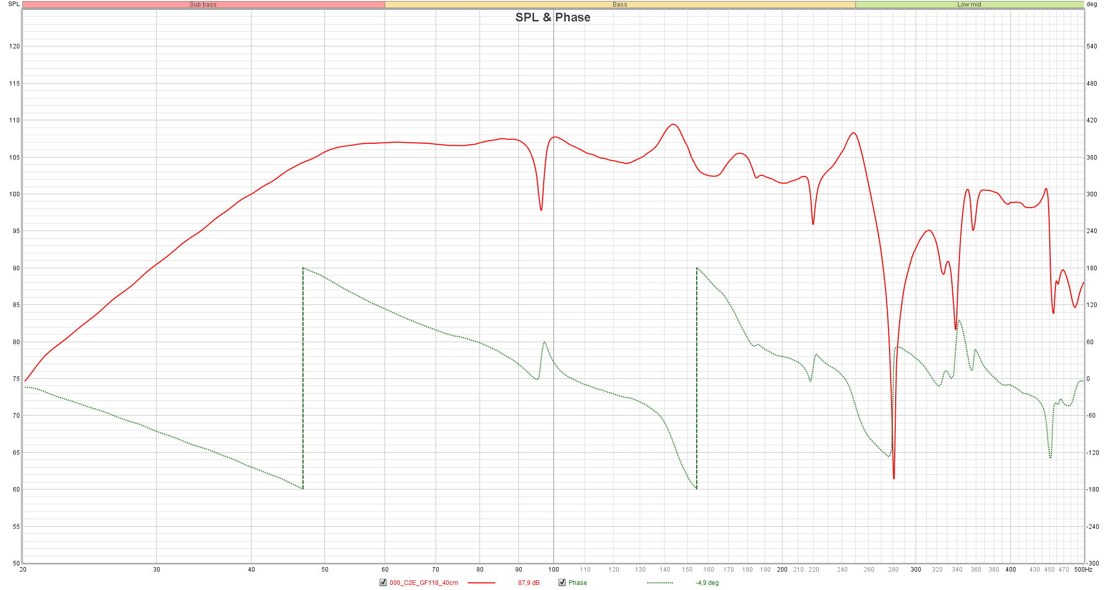

Okay, enough of that. I will share some graphs now, not every graph is 100% SPL-calibrated, but it gives you a hint, how the cabinets behave and what is optimizes (50-80% Damping material in the stubs for example to avoid a ringing-tone at 97Hz) or even the fold (also have angled braces without the caps included, just to see what these optimizations do on their own).
00_C2E_GF_118_Measurement_40cm_HTres_4caps_Waterfall_DAMPED.png363.8 KB · Views: 986
00_C2E_GF_118_Measurement_40cm_HTres_4caps_Waterfall_RINGING.png408.9 KB · Views: 966
00_C2E_GF_118_Measurement_40cm_HTres_4Caps_PH1TH_STEPPED.png300.4 KB · Views: 1,278
00_C2E_GF_118_Measurement_40cm_HTres_4Caps_Damped60_and_Phase.png133.2 KB · Views: 1,142
00_C2E_GF_118_Measurement_40cm_HTres_4Caps_RAW_and_Phase.png131.3 KB · Views: 1,126

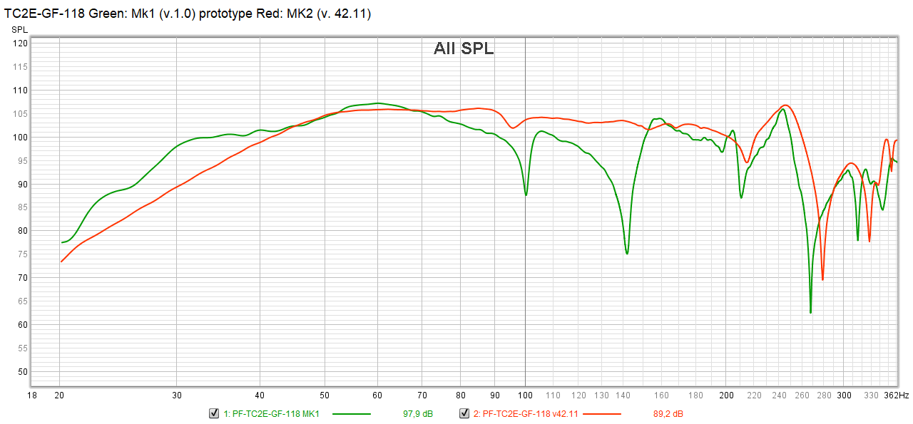

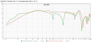

Balfred1. The new data look very promising.
You can see the improvements and progression over the first MK1 prototype of the TC2E-GF-118 I have build, which has a smaller mouth, doesn't have filled stubs in the Hight Tuned Resonator (HTR) and a slightly larger chamber in the throat.
