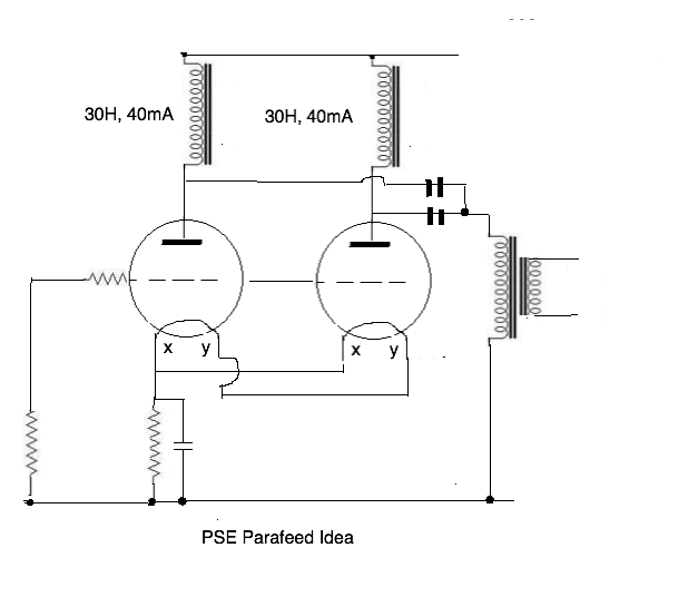

As an exercise in using up parts on the shelf, I'm considering a 300b SE amp in parafeed. I'm not saying this will be optimised in any way, just that hopefully it might work moderately well. I'm sure many of you have redundant PP OPTs in cupboards, so it's a theoretical choice. Mine are 6.6K.
Thinking of a parafeed choke, my eyes fell on four 157G Hammond chokes, 30H and 40mA. These could be used in series for 60H at 40mA or in parallel for 15H at 80mA. I've tried a single one with driver tubes and the sound is pretty OK - it's used in the Hagerman Tuba. Various other Hammond possibilities. I also have some 10H at 100mA which could be used in series for 20H at 100mA. A proper choke would be better of course, but that would be where the costs would start to rise.
Again, the PP OPT isn't optimised and a proper one would be a lot more expensive.
Any fans of trying out a "300b SE parafeed on the cheap" or am I being a bit fanciful here? I've tried a parafeed headphone amp which was nice and used a 157G and a Lundahl LL1689/PP OPT, but not a 300b SE. I'm open to the idea of a 2a3 version as well.

Is this a way of using 2 x chokes to get 80mA and still use the 30H of each choke, rather than having them in parallel which would reduce the inductance to 15H?

andyjevans idea of using two output tubes is quite a good idea,
as long as you are willing to use two output tubes.
Although the two coupling caps do effectively put the chokes in AC parallel, which makes the inductance 15H . . .
But the 15H AC impedance is driven by parallel tubes, so the effective load inductance to each individual tube is 30H.
That was a good call on andyjevans part.
I never would have thought of that, but I will not forget it now that I have seen it.

One thing you do have going for your quick and inexpensive parafeed amp is that at the typical 300B quiescent current, the plate impedance, rp is quite low, 700 Ohms.
That low rp can help overcome some 'not so high' load impedances.

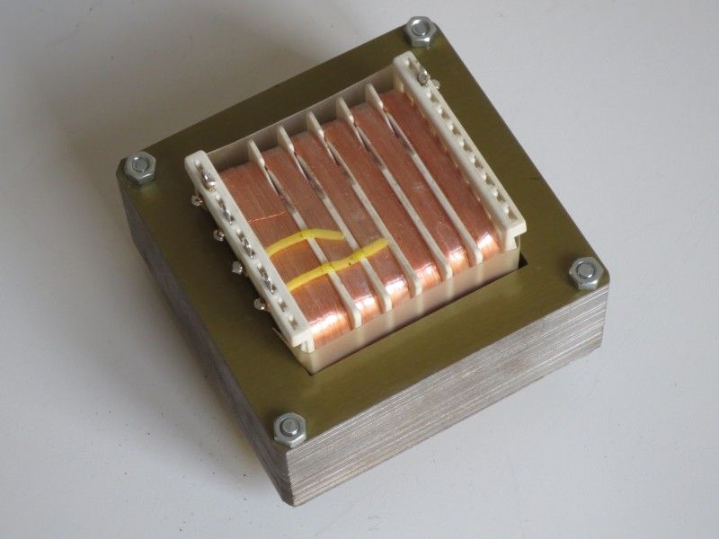

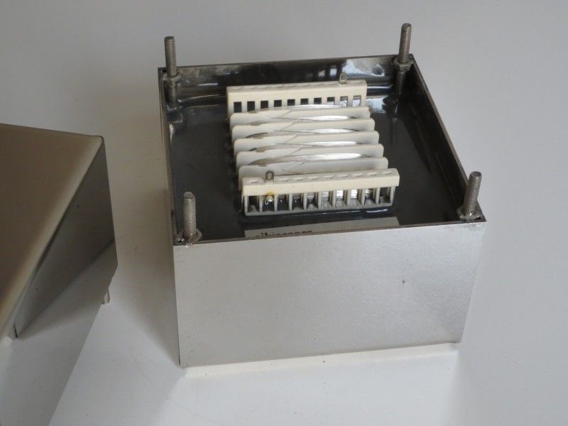

Patrick Turner wrote excellent discussions, this is about chokes:
audiofilterchokes-page3
BTW -well designed- anode/plate choke has even more complex structure than OPT.

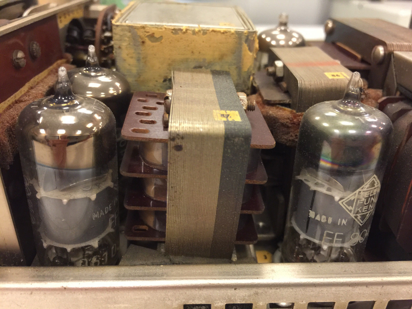

Euro21,
where are those multi chamber chokes available?
They remind me of the TAB V76 anode chokes.
