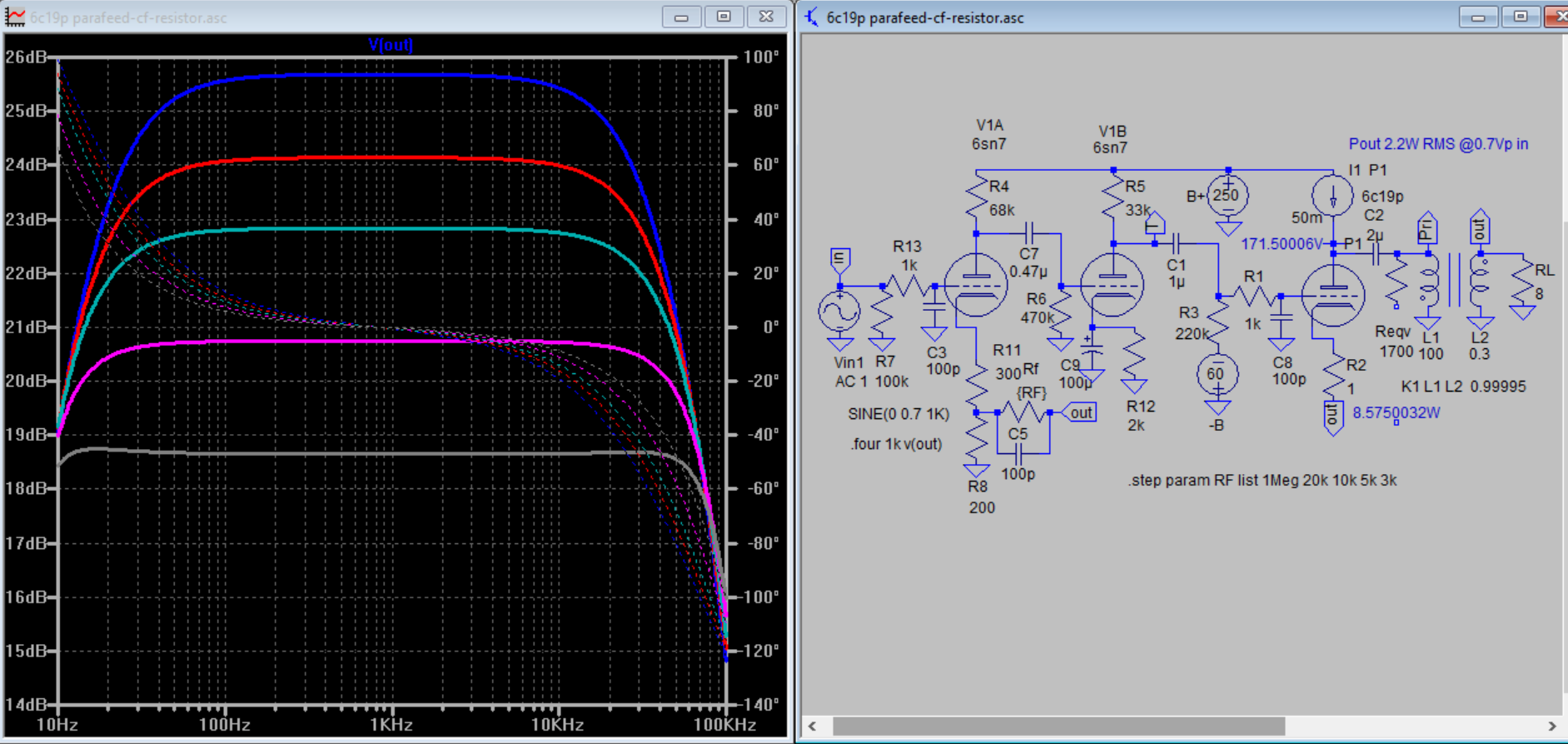

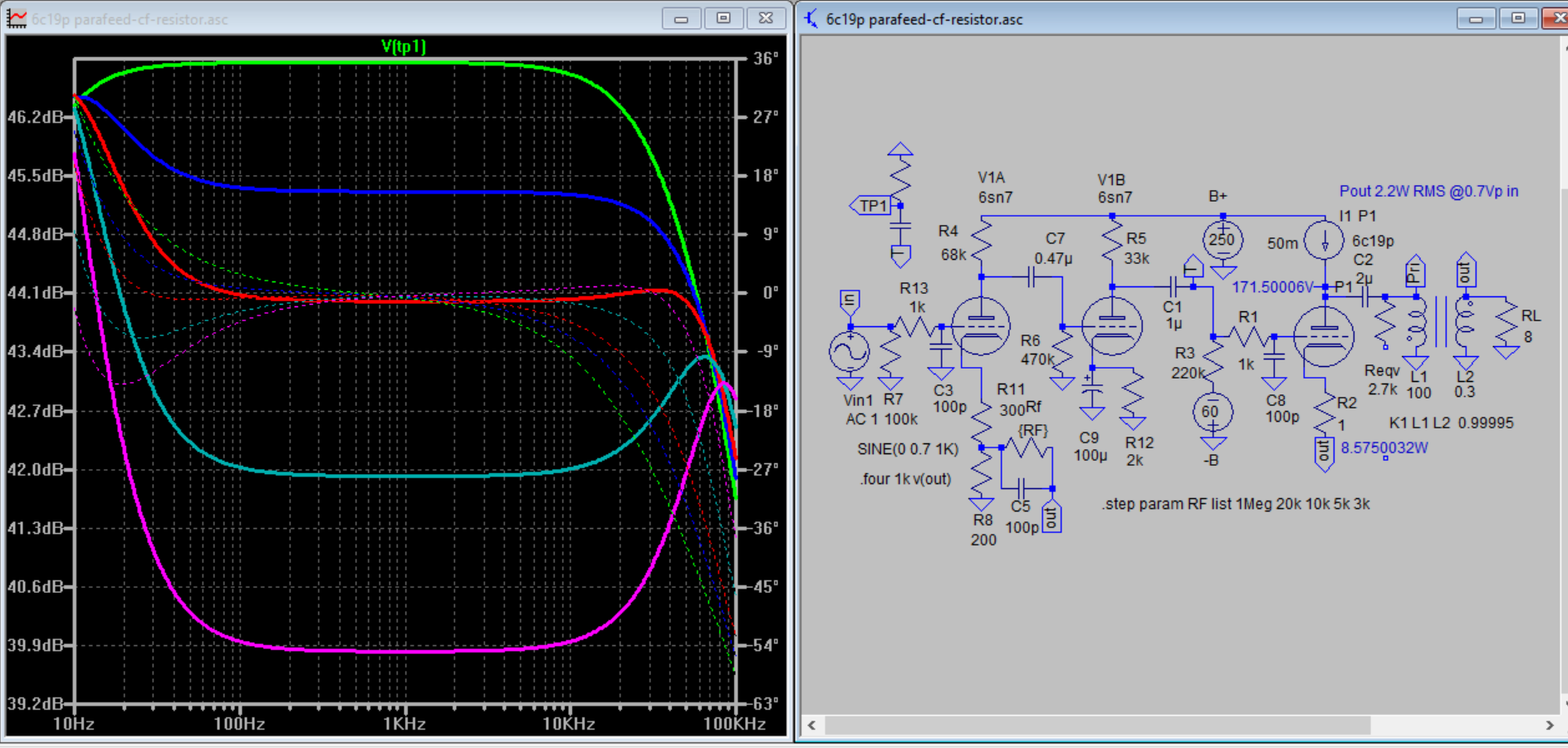

This sim shows the effect of gNFB to coupling cap. gNFB increases the gain of bottom end or flatten the bandwidth and thus reduced the size of coupling cap of RC constant, I think. Damping factor is increased.
