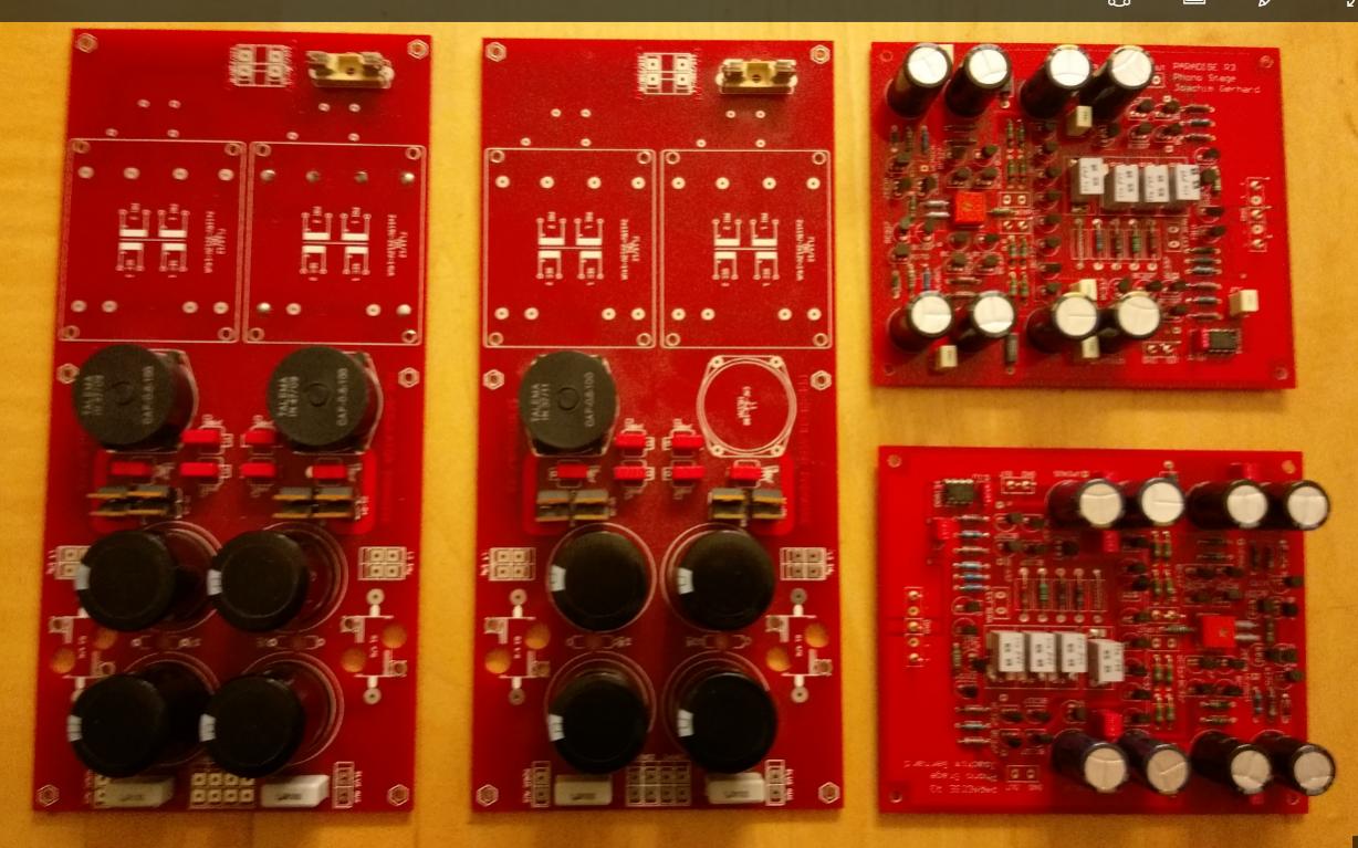

I have a stereo set that is already stuffed but without PSU. I have shown a simple PSU on MPP that you can use for a complete Paradise. I sell the stuffed boards for 400,- €.
And I can provide you with alternative PSU boards that have been proven with the Paradise. They're at least as good as the old group buy psu boards. £24+ p&p

I have this :
2 Pre-Regulators stuffed, Transfoeners, on common mode coil and some resistors missing.
2 Stuffed, working and calibrated Paradise boards without PSU
2 R31b boards with shunts
2 R3 boards without shunts
