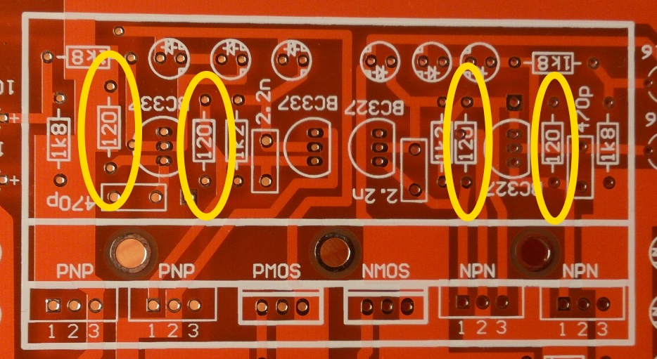

Yes, you can check documents a gazillion times and always find mistakes..... Please note that there was a bug in the BOM and regulator schematic - four of the resistors are now 120 Ohm, not 330 Ohm. I could change it in the BOM but unfortunately not in the schematic, will have to figure out a way to do this.
The PCB is alright, it has the correct text on the resistors, so if you just follow the PCB everything will be fine.

Please specify the number of each resistor.
I could not find any difference in the boom.
Are these the ones ? R100 R103 R200 R203 ?
Yes thats correct. The updated BOM (accessible through the link in my signature) has this fixed.
In the boom I got following your signature link I read
R100 103 105 200 203 205 are 330 ohm

Hi guys, sorry for the confusion, there was an issue with the link list, its all fixed now and the new BOM is accessible. We reduced the 330Ohm resistors when we discovered the CCS might oscillate, and the new boards have this printed on them, as the picture below shows.
Ricardo, are you looking at boards from the latest group buy? Older boards still had "330" printed there, no worries to keep them as they are if the regulators are not oscillating.....

Perfect. Thank you so much Alfred.
I have the old boards but those resistors seemed the ones that should be reduced to increase stability.
