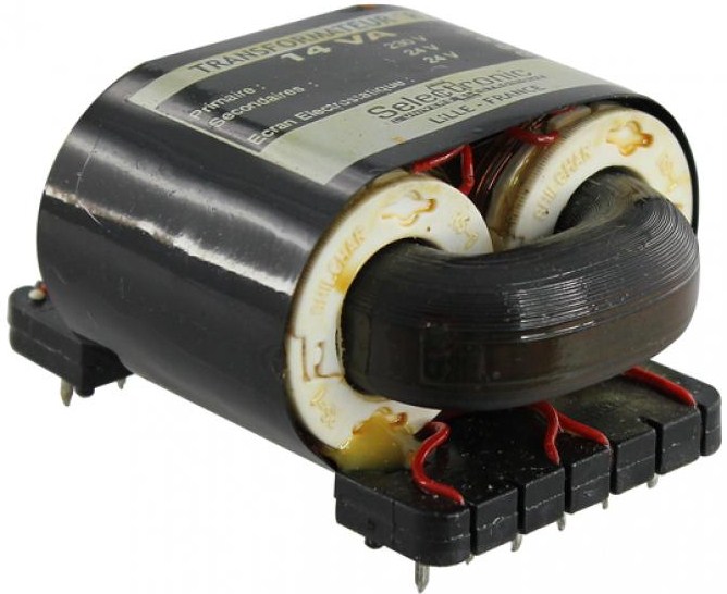

(btw, the PCB-mount R-core on the image I posted is 7mm longer, and 3mm wider than your beloved Flat-Block)
