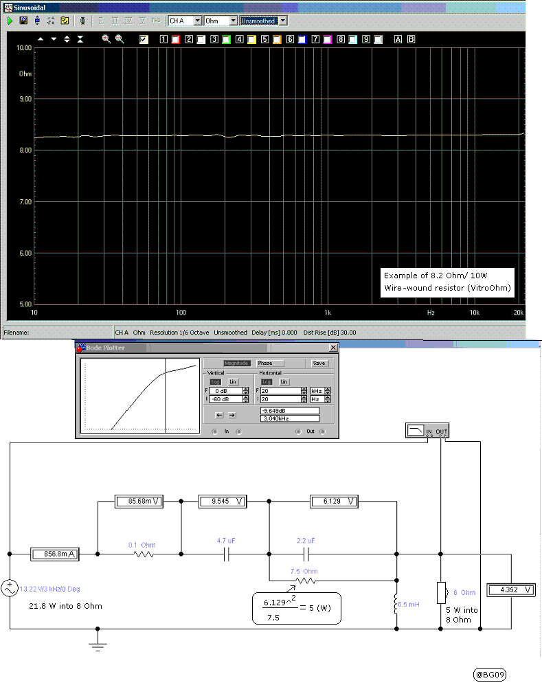

-.. - and why it is 15W ceramic resistor..
Take a look at the submitted picture where your Tweeter is (if) supposed to be an 8 ohm device.
If you replace this resistor with a 5 W type, maximum input to the speaker cannot exceed 21.8 W before you smell smoke, that is if your tweeter have a similar load as the one in the simulation,of course.
By the way, there is no reason to use an expensive resistors.
IMO, in this application a wire-wound will do the job i as good as any other especially when paralleled with a capacitor.
I took an 50 cent 8.2 wire wound resistor and ran a Z plot ,the result is in the picture.
A loudspeaker is a system from a designers point of view where a single component plays a minor role.
Replacing existing components at random, without measuring the impact on the filter as a whole, even if using the same component value, is IMO not a good idea, but rather a recipe of ' high end' disaster where the improvement is often an illusion.
