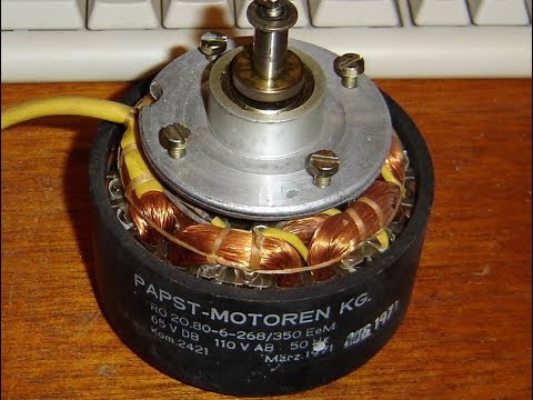

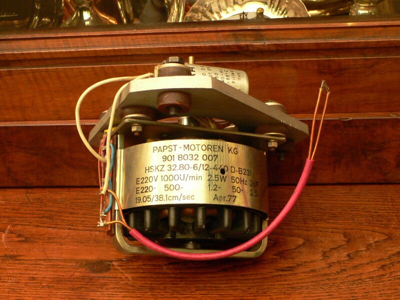

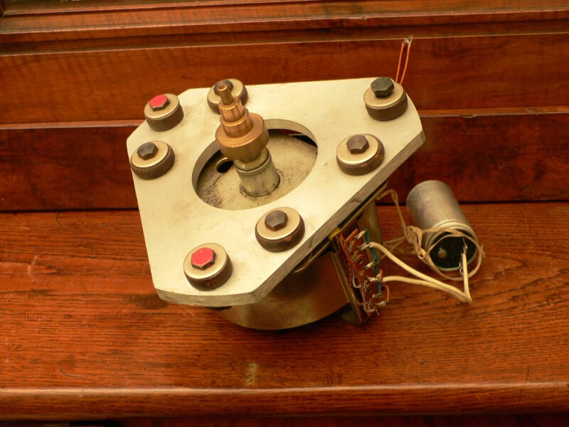

Under
1961 Empire 208 restoration.- Vinyl Engine
and
randytsuch's audio page: Empire Turntable - Motor
are also to find images of the used AC motor Obviously there are different versions.
