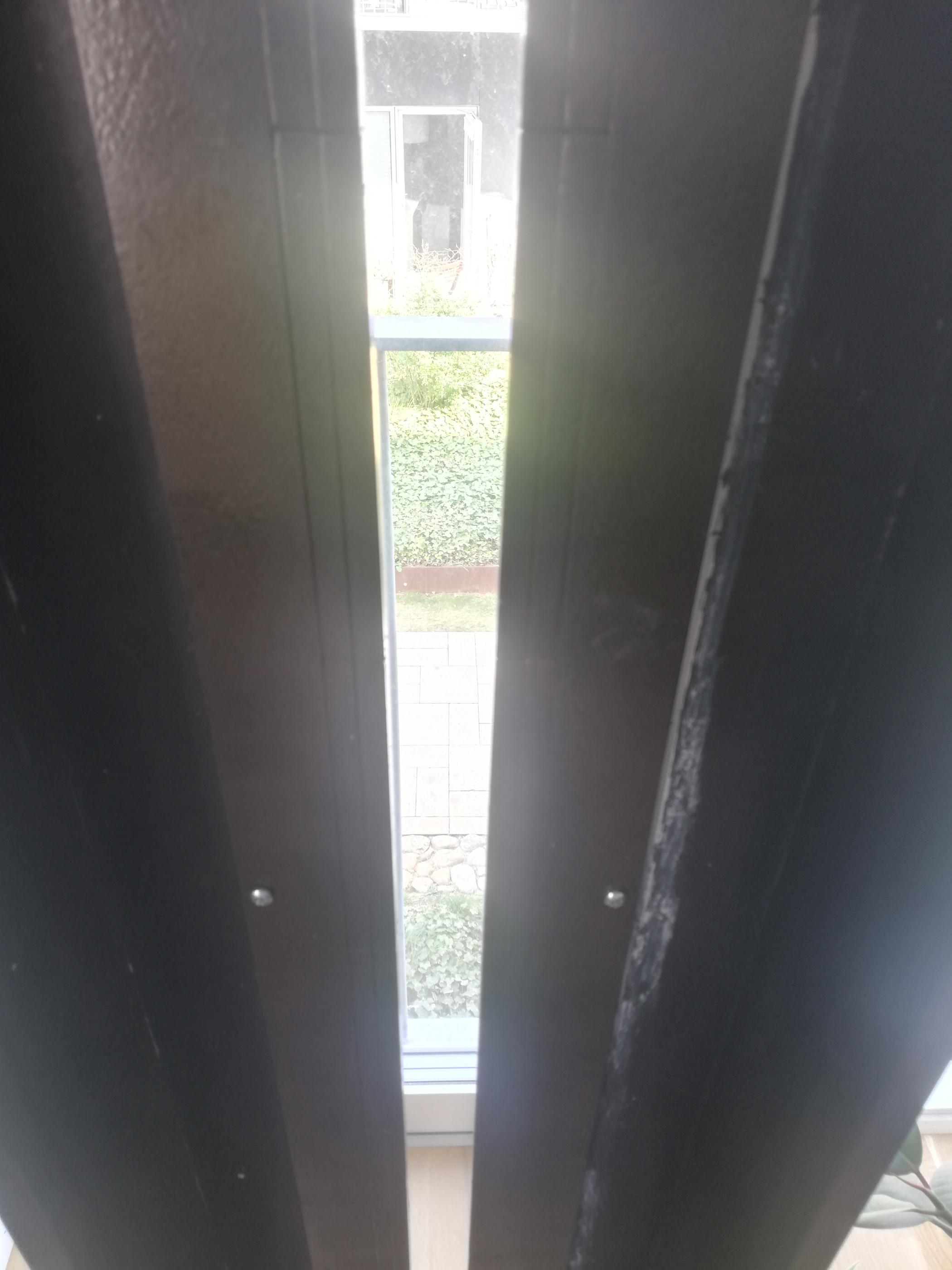

May be not at that distance.

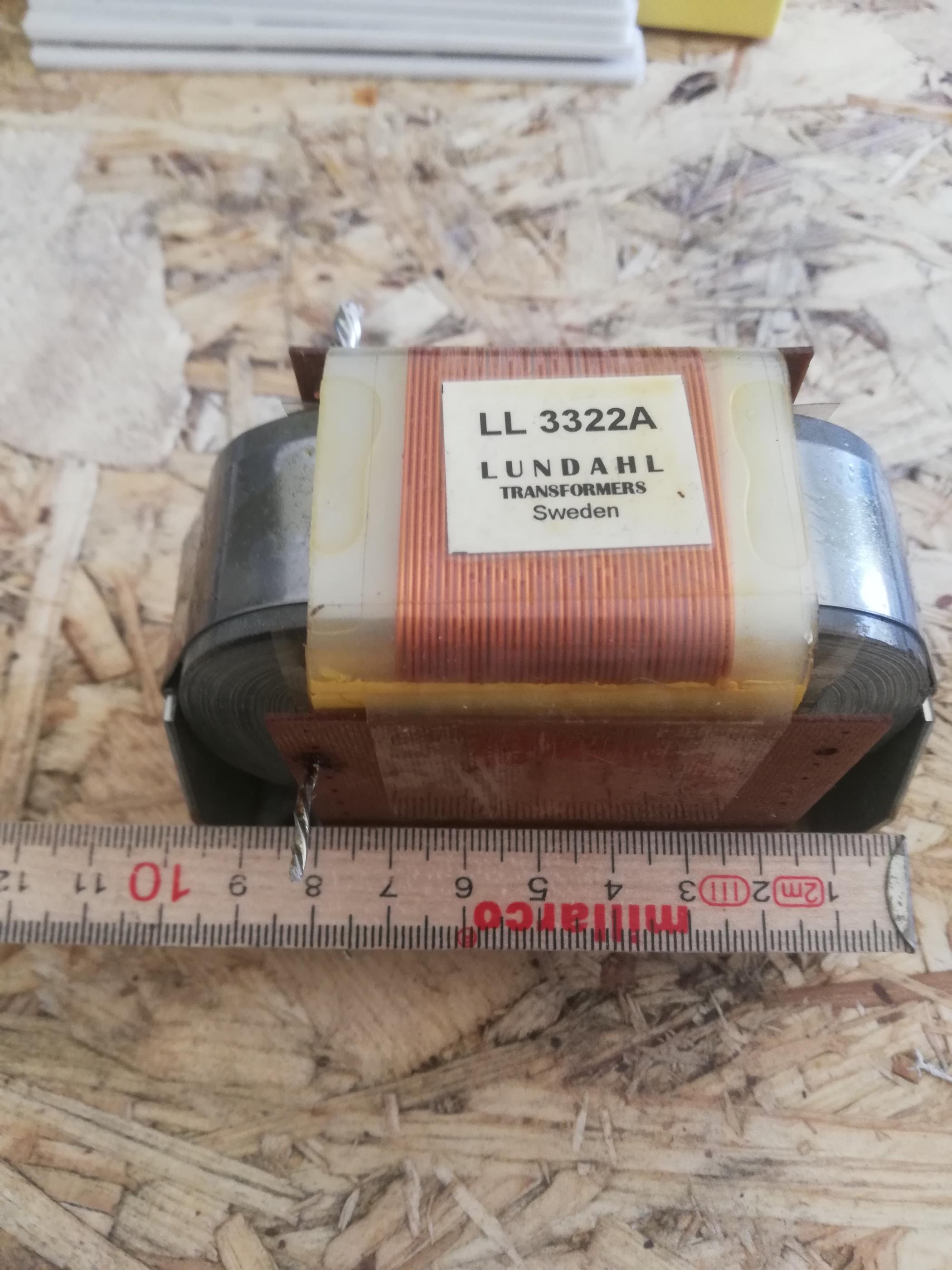

Is the transformer made for ribbons?
What is the resistance in the ribbon? 0,5 ohm?

Yes the Transformers are made for Ribbons.

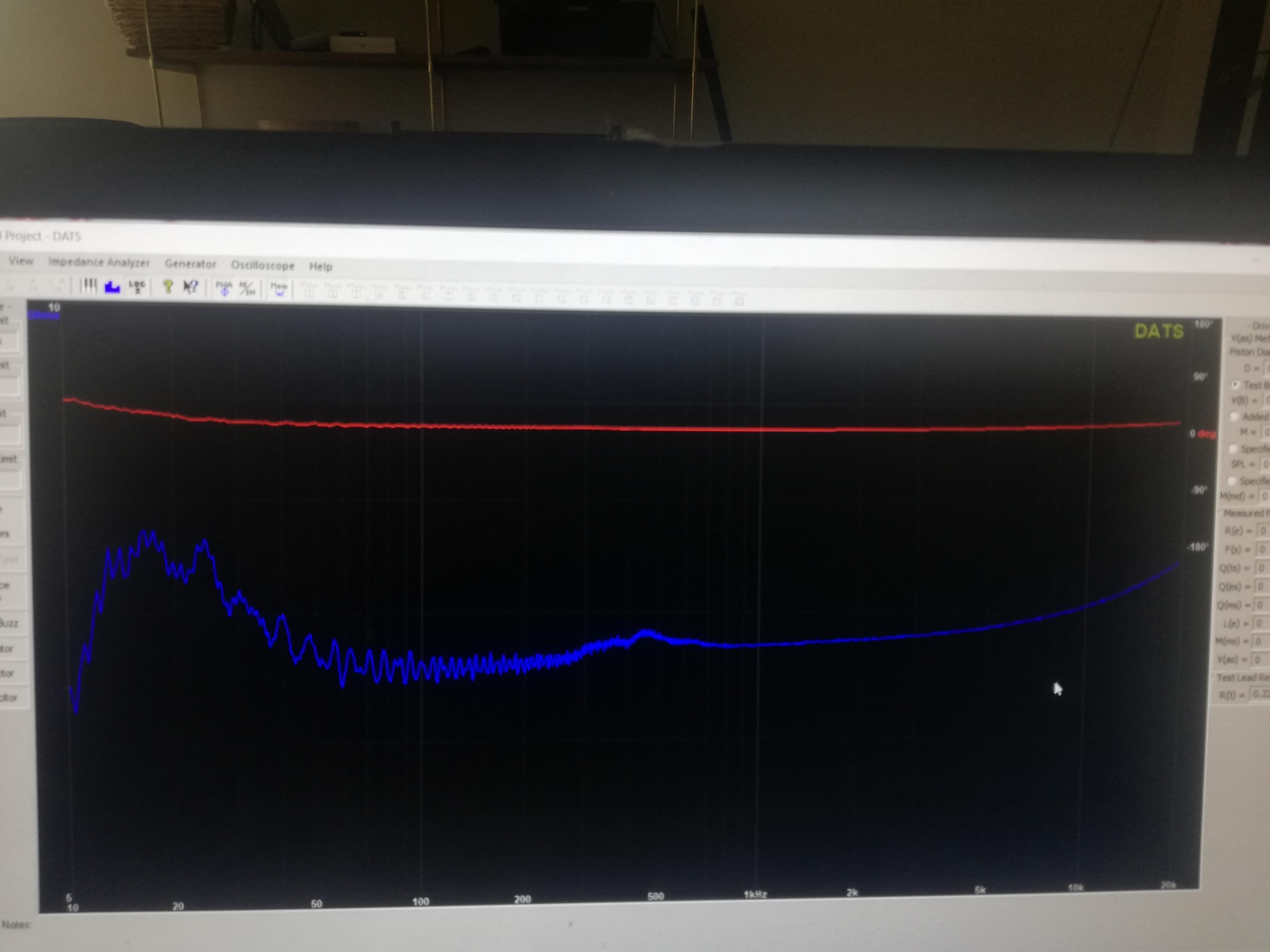

Don't know what the resistance is maybe 0.1-0.2 ohm.
I will measure everything later

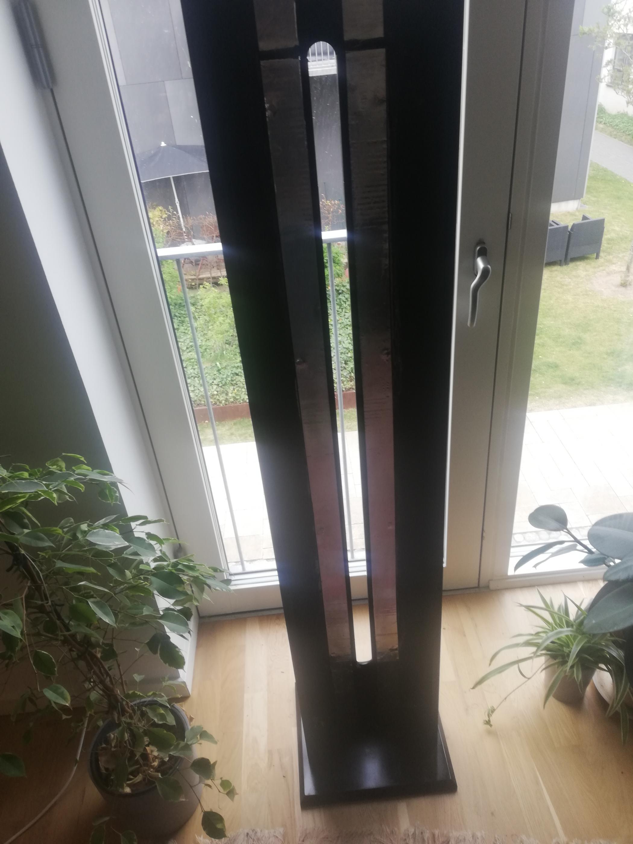

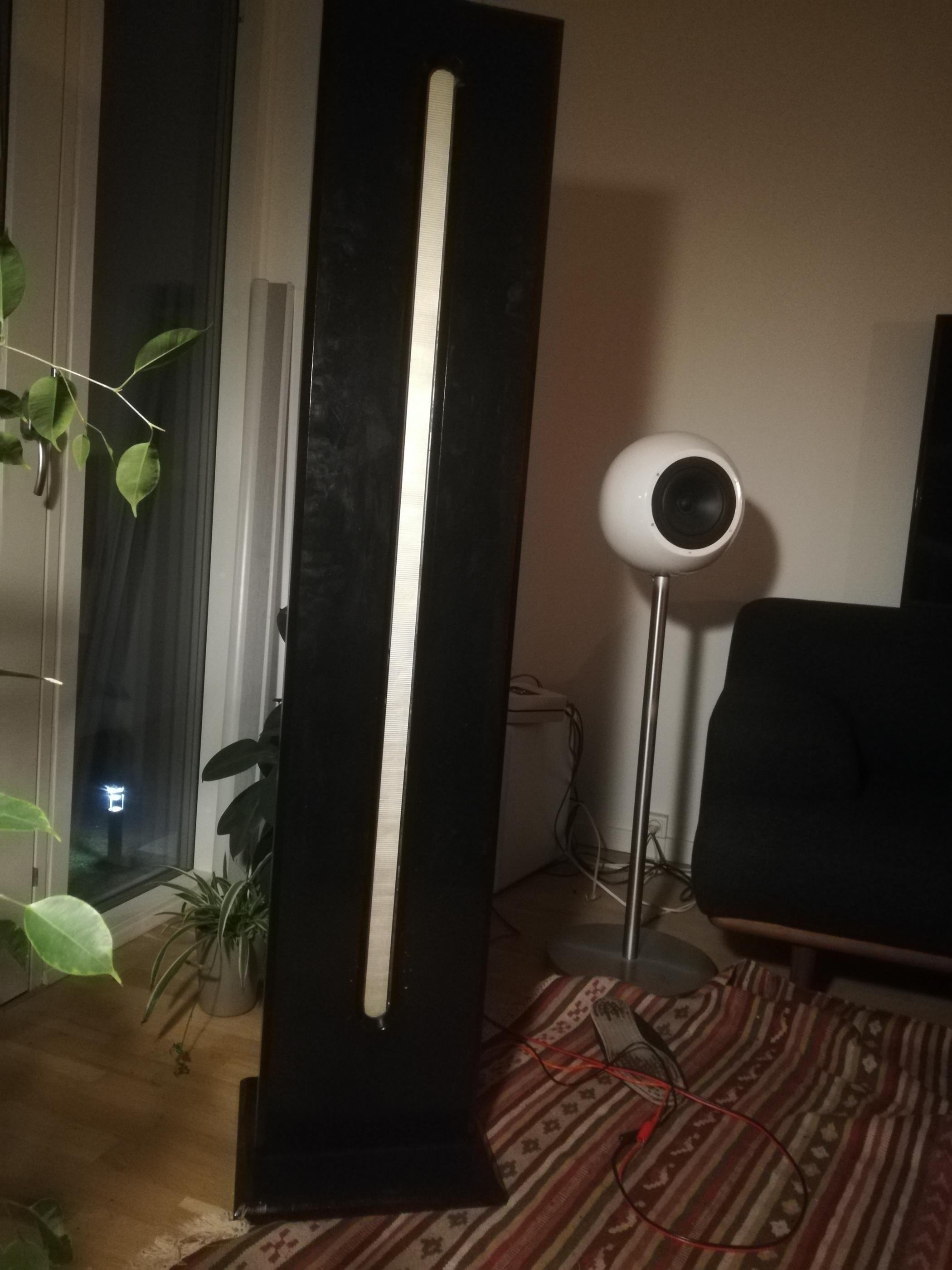

This does not look like what I had hoped for finish wise. But the magnetic field really strong. Nothing like the old apogee copies I made

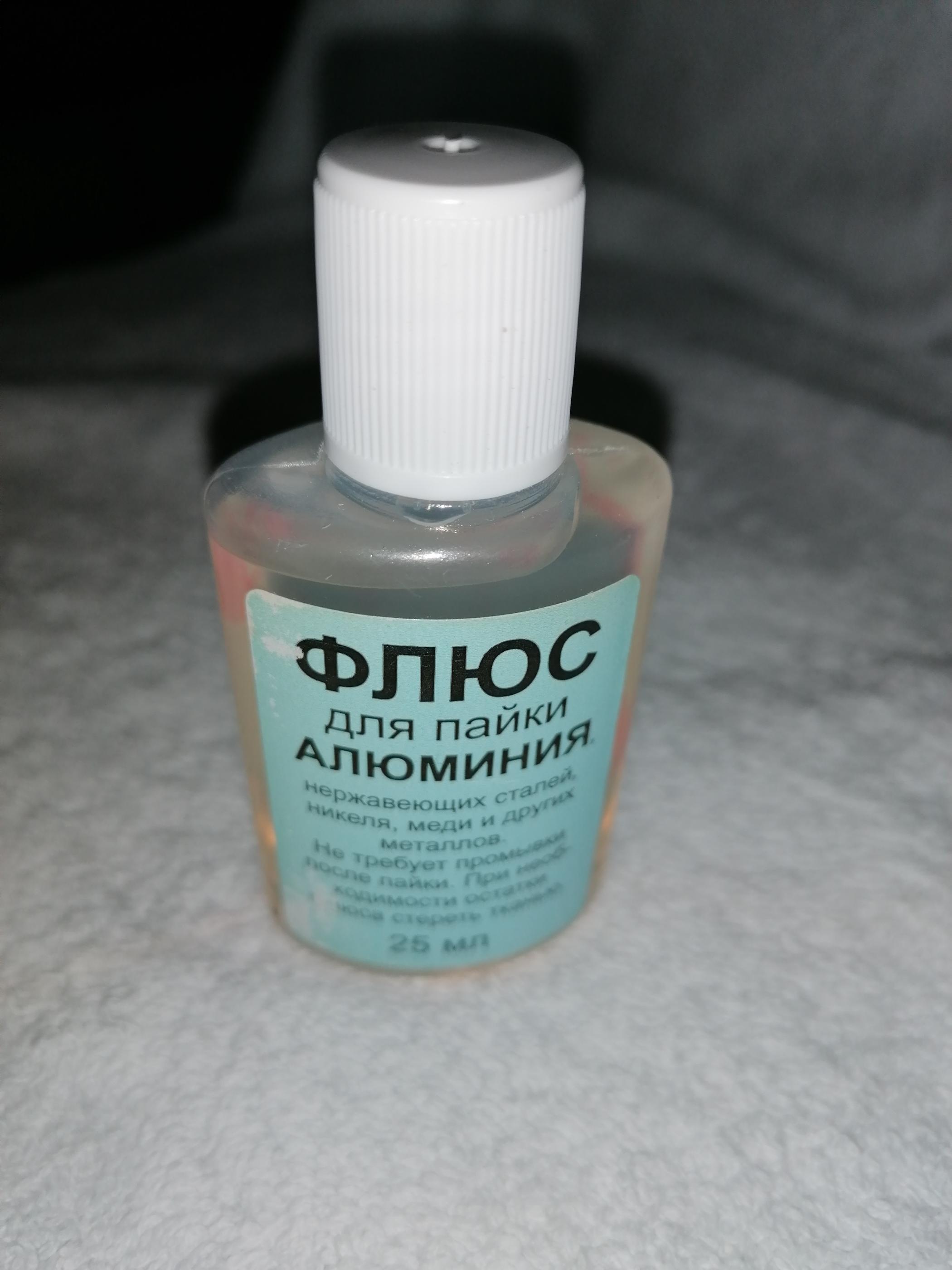

I used normal solder to go with the fluss

Nice ribbons. The white round ones, what are those?
Elipson sound ok with a sub. High WAF 🙂
- Planars & Exotics
- Paper Sandwich ribbon
