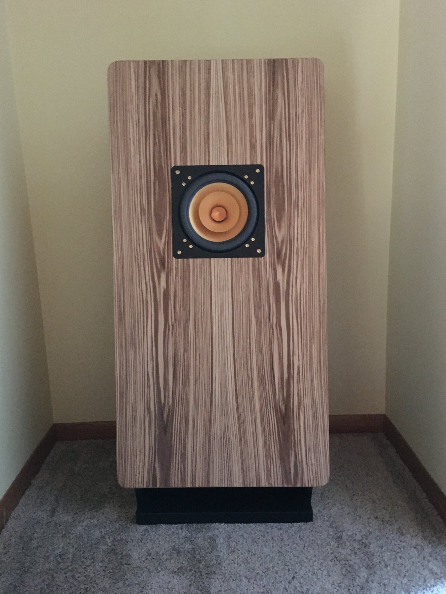

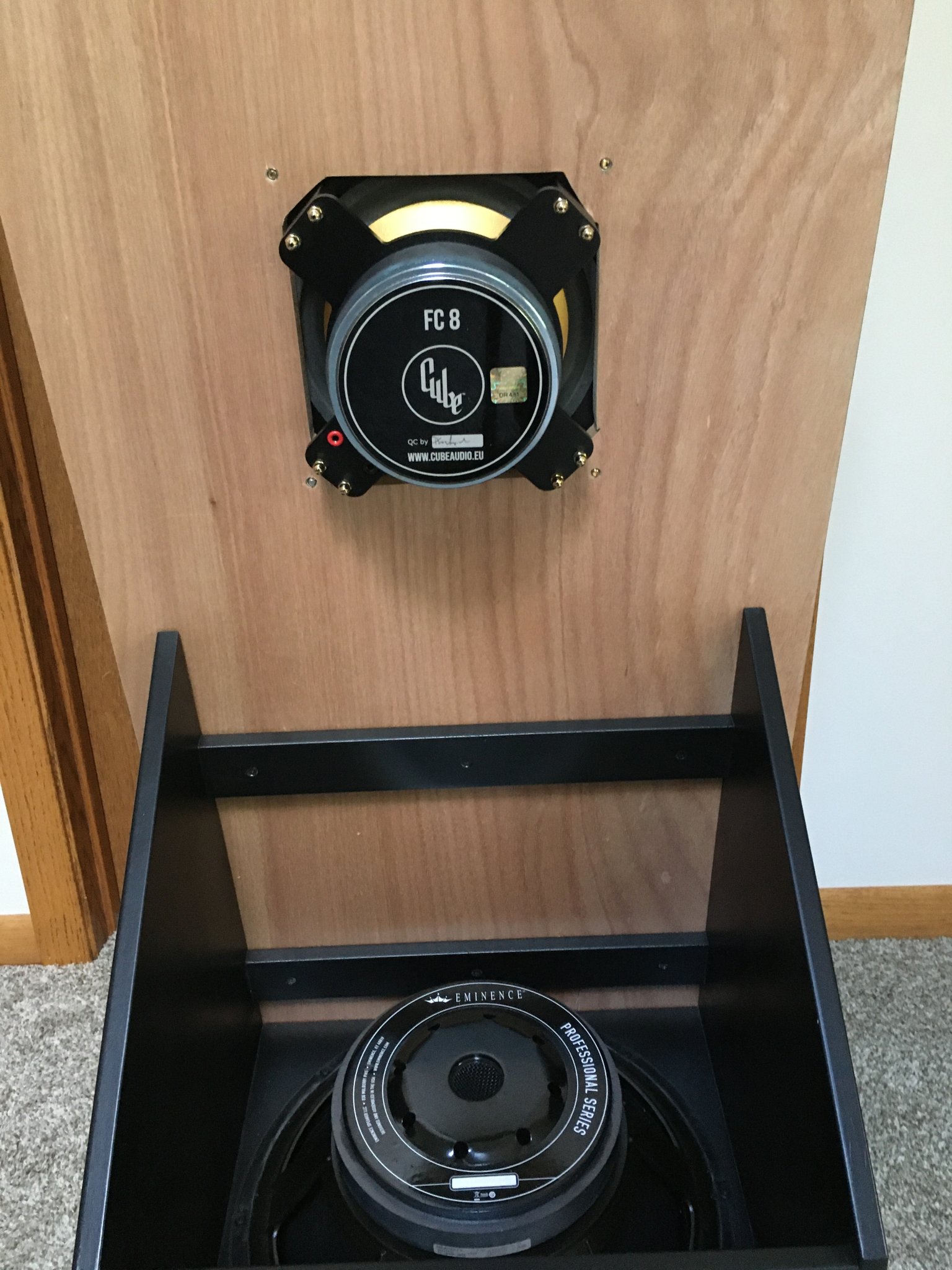

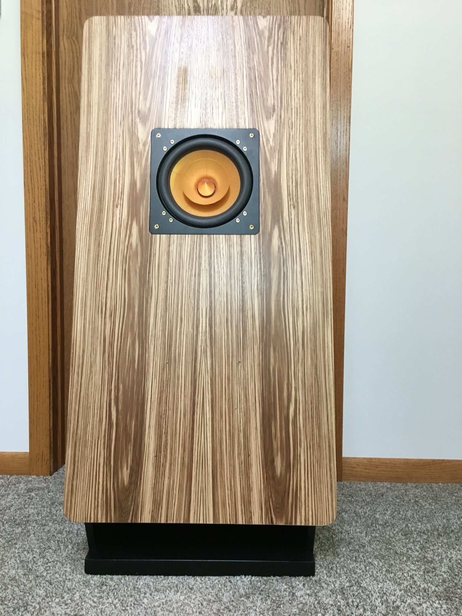

On 5/31/2020 wg45 sent me the info on the SLOB v2.0, my one and only woodworking project was a pair of sealed enclosures for Utah 8" drivers. The plans were included with the drivers, I made them in high school shop class several lifetimes ago. Since I don't own the necessary tools/equipment nor have the skills for this project, a neighbor was kind enough to help (he did all the skilled work, I sanded, glued and cleaned up).
I used Eminence 4015 ULF woofers and Cube FC-8 FR drivers, so here are some pictures.

What is the sound impression of these speakers with Cube FR?
Are high frequencies "good enough"?
What about blending with woofer?
I have not read the thread in details and don't know the data sheet of Cubes to have an idea of optimal crossover frequency?

2 - Sounded good to me the little I listened to them.
3 - I built a 6-24 active crossover for these speakers, could take me most of the winter to "dial" them in.
4 - I'm using 150Hz as the crossover frequency, not sure if anyone else used the Cube's. The Speaker camp used Moth FR drivers, living in Wisconsin limits my participation attending the west coast events.
5 - The thread is called SLOB v2, so that's what I call them.

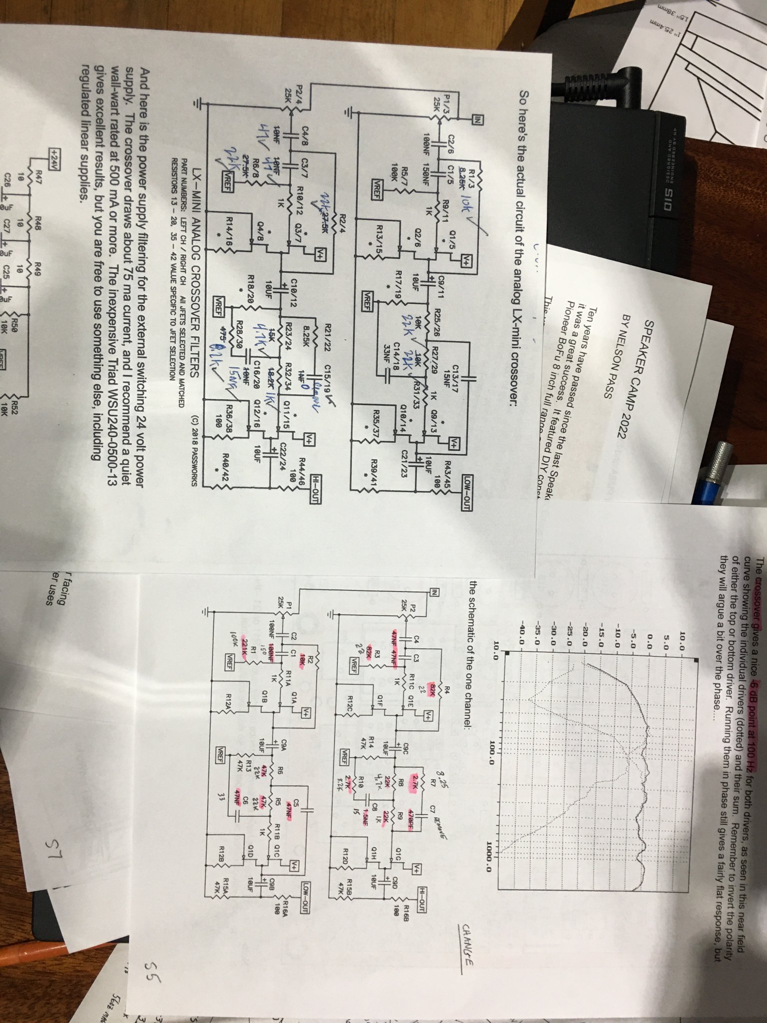

Hello wg45,Here's the info on my ACN/LX Mini set up for Papa's SLOB.
I've attached two documents- (no idea why they are upside down- saved correctly.)
1. The ACN crossover schematic with updated values hand written.
2. The file of the crossover slope with updated values on the right, but it is not a complete schematic. Use the complete schematic with the hand written values.
Schematic changes from original values-
For the low pass-
R1/3 to 10K ohm
R25/26 to 22K ohm
R27/29 to 22K ohm
For the High Pass-
C4/8 to 47NF
C3/7 to 47NF
R2/4 to 22K ohm
R6/8 to 22K ohm
C15/19 removed/left open
C16/20 to 15NF
R23/24 to 4.7K ohm
R28/30 to 8.2K ohm
R32/34 to 1K ohm
here we are a year later…how do you like the sound of the slob2? Also, on your marked up schemo above you are showing the original lx-mini, correct? I was looking at the camp slob2 2022 schemo & the values are a tad different. Just wanted to get my head around your thoughts after time gone by. Thanks for any feedback.
