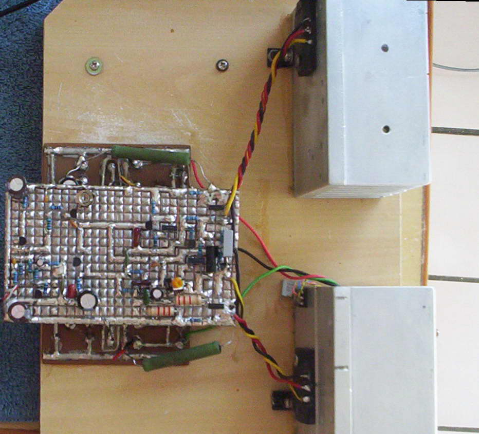

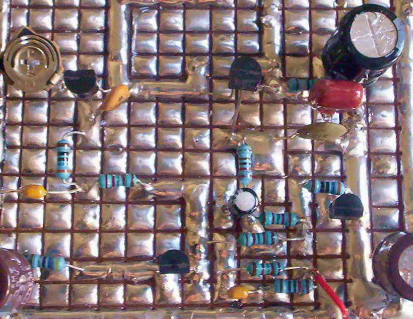

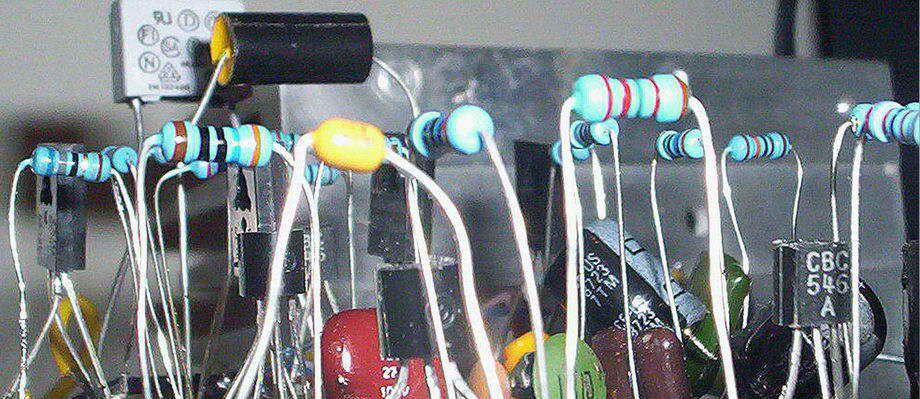

The amplifier is sounding lovely today.... modifications made result excelent...sounding very special.
I have sligthly difference in VBE into the output.. do not like that... despite inside the tollerances....one transistor is 575 and other is 589 milivolts....hehehe...very obsessive...but i know the total VBE matching is possible.
Off set into 2.7 milivolts...not stable...goes to 5 and down..something is wrong!
Bias is fine...38 mA each rail..with differences (normal) between them
All others transistors fine, into 575 milivolts.
Bootstrapp modified, input filter changed, bias system changed... only the start of a long run.
Today, i think can beat HRII...but we never know before we make A to B comparison... and this is for the future... just starting the research.
Today i am shocked, completelly astonished with the sound it is playing... i have problems to understand it is almost the same amplifier...well..topologie is the same... biasing changed, rail regulators inserted after that and increased sonics.... equalization changed into input... i have some reinforce of 3dB above 7 Kilohertz...now i have moved to 9 Kilohertz.

Thank you Line up..... the amplifier is a mutant
everyday it is different... well..... it is a NAD... very appreciated brand...and i am trying to make it even better.
If the main circuit appearance, or schematic, had too much identities, then i will let in in peace...but if needed a lot of work to sound the way i want..then i will call the unit Panzer.
Easy when we start into an advanced point.... NAD made researches... and released wonderfull product, now easy to tweak for my taste... starting in an advanced point... starting into the point they stopped.

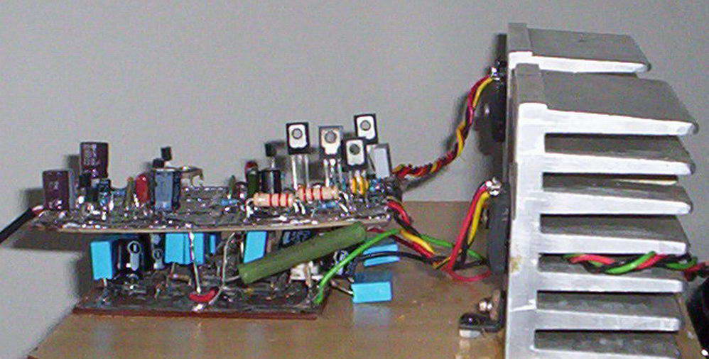

Now it is sounding great once again
A little bit confused...the main supply is already stabilized...electronic stabilization.
Sound is a killer today!
The off set is now stable...ahahahah..bias is floating.
Oh!... this thing will drive Charlie crazy... will give a break to me.
There are things to supress... so long i can understand the mess i have done..
More output pairs will be used...and CCS to drivers not included for a while... a lot of water may flow under this bridge to finish this one.

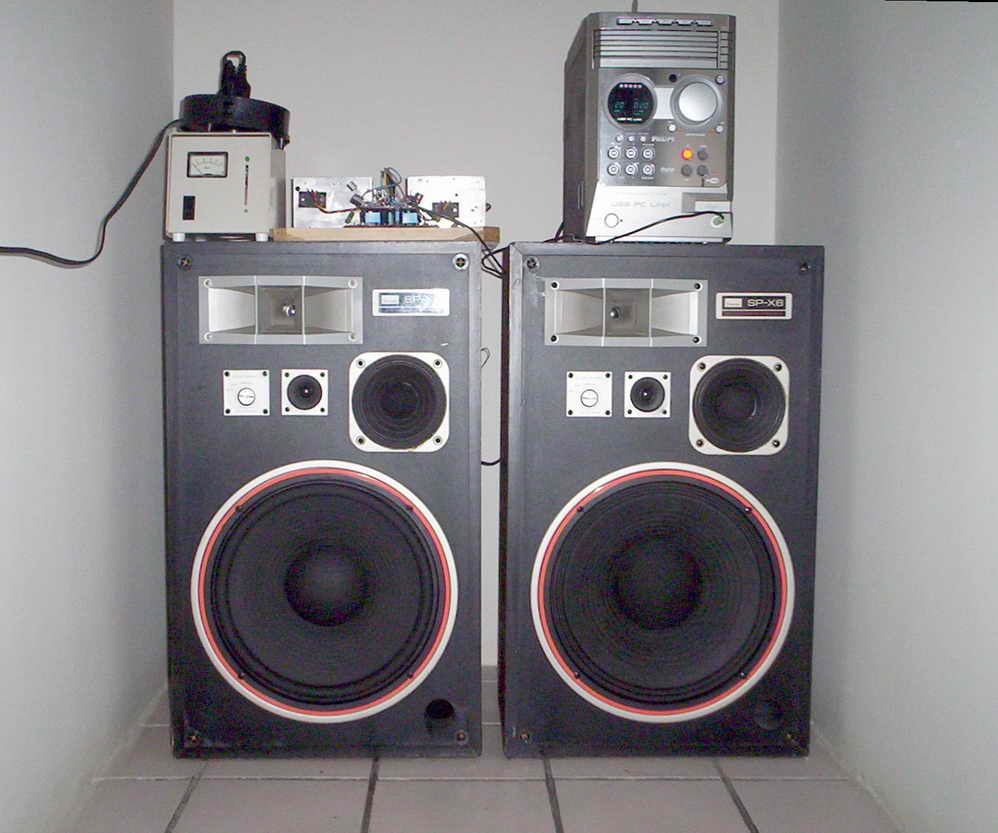

It is playing....i have switched it off
This means it may be distorting, and the result is to turn us tired to listen.
Or maybe the environment noise and the fan i have here.... will listen low volume and early morning...will use also headphones.
Will check this latter.... develop an amplifier, even starting into something already existed produces a lot of work..hard work!
