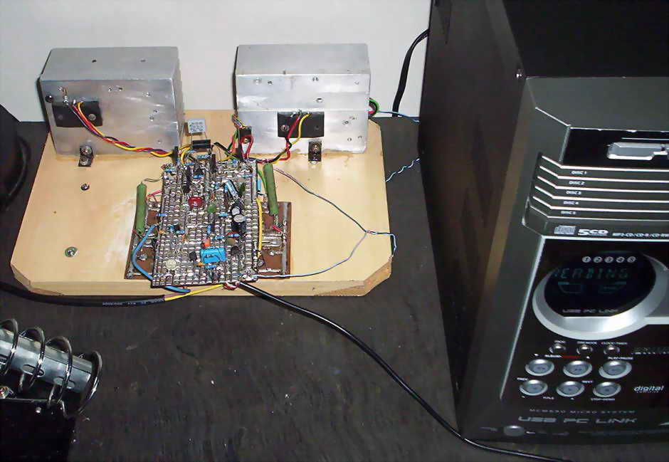

I am already buiding, simulating and tweaking.
I am using NAD3220 as reference... the starting point..the topology to be tweaked, modified and tested to see will be released or not.
As people is trying some nice conversations about into the Precision Thread and into the Dx Amplifier thread, i have opened this one to make people free to talk whatever folks wants to coment about.
I have researched a lot.... about everything published into our forum, into Reviews, Magazines Reviews, Test Reviews, schematics and also into the Google.... everything was readed.
Now i have something built and sounding.... 24 hours playing and already received several modifications..... i am not happy with the sonics i am listening today...will work to make it better.... or, at least will try.
Mufled..strange trebles.... a little bit boomy.
Nice sound stage, focus and reasonable presence of mids.... dinamics interesting but saturates very easy as do not use Differential amplifier into the input.

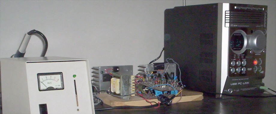

It is not a virtual amplifier, not only simulations
Was assembled, exists in real life.
40 volts for a while, and difference supplies to the input are unders test.... Output is around 125 watts..... well.... this is the start of the whole thing.... the power decision is for the future.

Today it is this way, tomorrow will be different
Maybe will be unrecognizable in a month.
I am trying ideas, and listening to them.
I will not try ALL ideas people is offering, but i may try some....no guarantee to try ideas posted.... so, put them here because your own will...no deal made!

Hi Carlos,
Tudo bem contigo??
For this circuit i suggest use a cfp as input transistor. There is a good criteria on how you should select the two trannies for best linearity but it will be too long for me to explain here. Ill make a copy of a document i have and send it to your mail. There is also other info regarding cfp pairs - regarding transconduction harmonic signiture and comparing their use against single trannies and jfets in ltp stages.
Maybe these things were covered in dr Selfs book, i dont know havent read it. This was by someone else but i cannot recall the name now.
By the way i like the sound of jfets, how about one here on input????
Good luck with this circuit, twenty years ago they sounded ok to me, but very inferior to a JLH amp i bought as a kit to build when i was a teenager..... no not the famous JLH class a Amp, a 100 watt A/AB i think it was. Also built a JLH pre-amp, to think of it it very much miss that preamp, it was glorious. Nordic lives out that way, maybe i should contact him and see if the shop i bought those kits still exists.
Carlos have you tried cascoded current mirror on P1 Ltp. These have two main benefits sound wise :
Two transistor mirrors tend to compress the sound and even using very large hfe trannies doesnt help that much, this does.
Brings the Ltp collector currents closer to balance which not only drops the distortion (2nd but also 3rd and higher harmonics too) but is also essential in obtaining good precise sounstage in this topology.
For all the other EEs here, yes their are other benefits, but lets keep this simple and more related to the sound than the electronic theories.

I have readed all that stuff dear Gaetan.
Thank you by the kindness to help.
Sorry the picture Gaetan.... Canon Camera is broken, now using old Kodak, no zoom, no macro, no resolution.
I have built the 3020 and 3220 circuits in my home....here is the image... already very modified.

The schematic, at least the power amplifier, is almost the same
Andrew.... so, may sound alike.... depends from the pré amplifier of course..but power is almost the same with other supply voltage..have twice the power compared to the 3020 and 3220..both or those old folks around 20 to 30 watts into specifications.
Mine is beeing tested with 42 volts... power is huge...more than 125 watts RMS over 4 ohms.... but just studying...have no conclusion about..now tweaking...when ready will be compared with many others.
I am " on the go " for a while... feeling the sound good but strange...there's something strange on it.

I have tried the regulated supply and different voltages, the way you see into the
schematic, but have not found anything better using them... now i am trying without it...but this is alike today picture, tomorrow the regulator can go to the board once again.
You know, the regulator have not show me sound differences when the amplifier is the way it is now, in this moment...the way the schematic is now....but tomorrow, the schematic will be different and i will check this once again.
I have not that treble focus i have dream...not having the focus, the rail regulation do not appear.... keep hide....... when i found a better treble i will include the regulators, then they will show their qualities.... was the same sound using those rail regulators and the same sound without them,.... but this today.
I do not know if i could communicate what i mean..... now the language is a big barrier.
This is something alike an old car, those ones have a lot of noises when running...not motor noises, but panel noises, door noises and back seat noises... then you replace the muffler by a new one, your old muffler had not a hole on it...just old and have lost some steel foam material has inside to absorb sound, not only the channels and tunnels inside, not only the holes but the absorving and muffling material we can have inside old muffler, Volkswagen style muffler, beetle muffler..... after replacement, noises reduced, but the automobile panels, doors and all stuff continues to produces noises... the advantage can be perceived but not too much... a matter of threshold.... this is the sittuation... the regulators, rail regulators behave alike the substituted muffler into this analogy.
The treble is sounding better, but already alike music playing into the next room, as listening througth a hole... sound is not here...not next to me...not from the speaker... distant...not present.... has not presence.
The level is fair...not loosing into levels.... would be good if was only this way...i have increased and i can increase more, using equalizers, selective filter into the input, resistive attenuator and blending capacitors...but the problem is not level... worse than that.
The unit is starting to loose level into 50 Kilohertz, do not believe this is the problem, but will change it to start to loose into 150 Kilohertz to see if this will change some. (3 decibel point).
The huge perceived bass into 40 hertz may produce this listening effect...will reduce bass level tomorrow to see if this will happens.... phase.... i am having some phase cancelling maybe..do not know exactly where.
