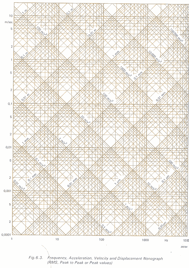

Unfortunately, I really have no idea how much the average panel moves in absolute terms, although I have a wealth of data from magazine reviews on the frequencies at which they tend to resonate. If you could just give me some idea, it would be most appreciated. I just want to know if we are talking 0-10G, 0-2G, or something much smaller.
I guess, I was thinking that 100G sensors are used on subs that have 1" or so of movement at 100Hz. I guess we need almost the same amount of dynamic range if the wall moves 1 mil at 3kHz. A big "if" thouhg since I have no idea. ;)

Below attached a very nice conversion chart of frequency/ acceleration/ velocity/ displacement
scanned from the Brüel & Kjaer book "Piezoelectric Accelerometers and Vibration Preamplifiers"
a note to the graph:
acceleration is not nominated in g but in m/s^2
1g = 9,81 m/s^2
example:
a panel that displace 0,01mm at 1000Hz (I think this would be a more or less realistic value) is accelerated by (about) 400 m/s^2 = 41g

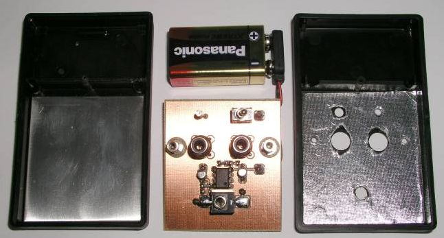

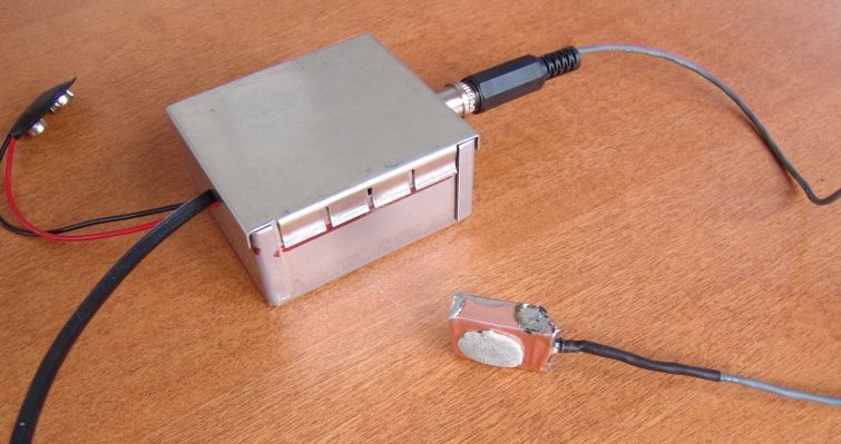

Would a microphone preamp work as the accelerometer amplification?
How do you mount the accelerometer onto the panel without damaging its finish ?
Let's bring this back up!
Do you use an amplifier ?
What voltage do you use for V+?
Can you tell us more about your setup?
I don't know Praxis, I would use it with SE or Arta, connected to my sound card input (through a mic preamp if necessary).
I was thinking that it might be possible to use the phantom power of the mic preamp.
