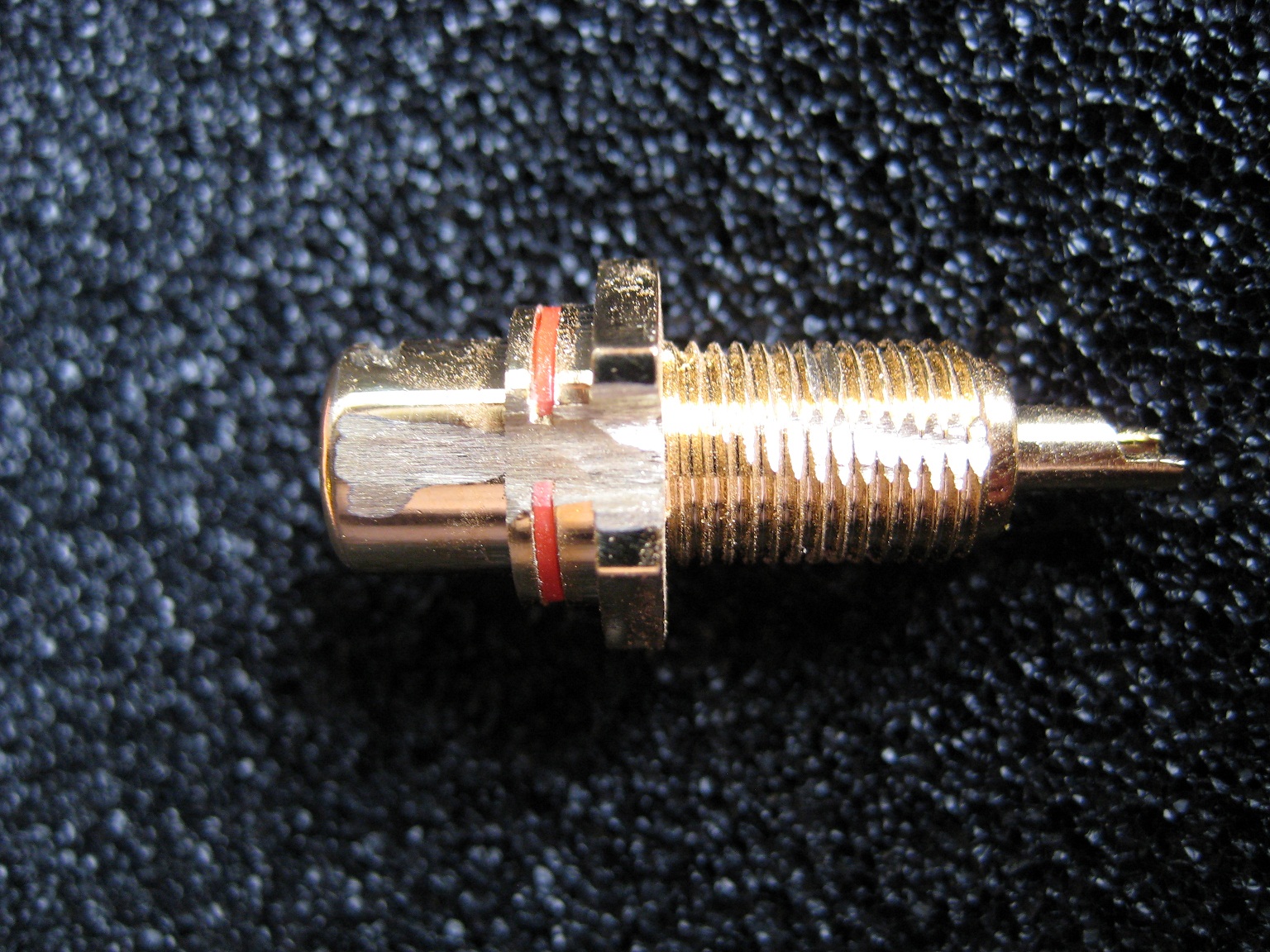

Actually the eBay sockets linked by theAnonymous1 are said to be 24k gold plated pure copper. Achimedes could probably figure this puzzle out.
I have a bunch of the jacks I linked to on the first page. That listing also states that they are "pure copper made".
I just took a dremel to one of them in multiple spots and they look to be made out of aluminum. They aren't magnetic and the metal is clearly silver in color. Definitely not brass or copper.
Aluminum is fine with me though, so whatever.
I'm not a metallurgist (by training I am a biochemist) but gold does not seem to do nice things with alumin(i)um:
Gold-aluminium intermetallic - Wikipedia, the free encyclopedia
Gold plated aluminum is normally zincated and copper plated first.
I'm not certain it is aluminum though. Maybe the brass alloy is just a really light color and contrasted against the gold makes it look silver.

You can put a piece of aluminum screw sanded a bit next to it to decide on the photo. The camera's white balance could be anywhere then, doesn't matter.I'm not certain it is aluminum though. Maybe the brass alloy is just a really light color and contrasted against the gold makes it look silver.
No need, I'm convinced it's brass. It's just a slightly lighter color "yellow" than some brass hardware I have. Maybe a higher percentage of zinc in the alloy? Doesn't matter really.
