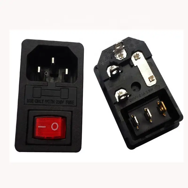

If you can find a module which will fit vertically like this one, that would help.
https://sc04.alicdn.com/kf/HTB10FyCeRCw3KVjSZR0q6zcUpXan.jpg_Q55.jpg
If not, I would make the fuse internal, and stack the switch and IEC outlet next to the right side.
Or better, get rid of the IEC and make the cord captive using a restraint where the fuse is now.

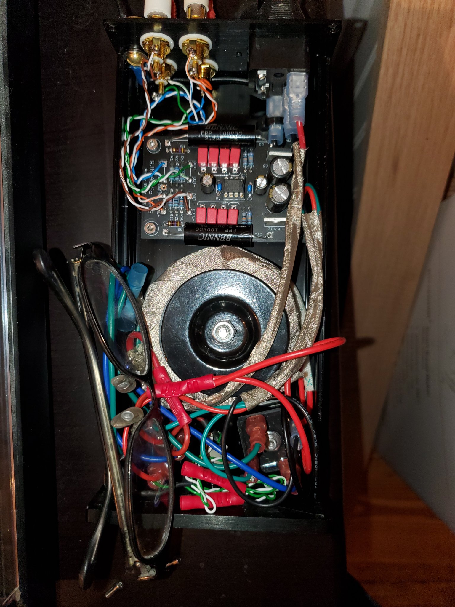

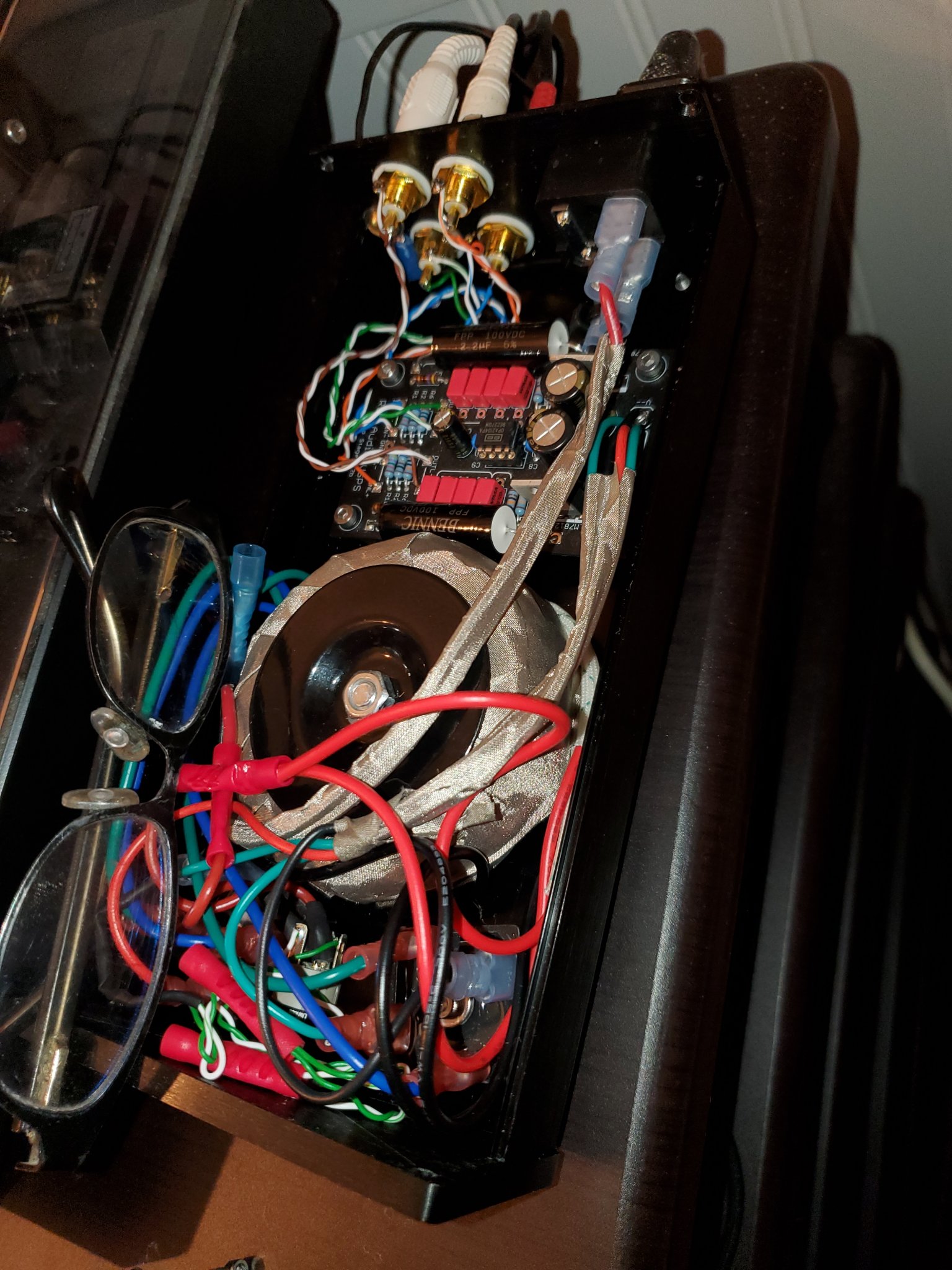

This is built around the VSPS (very simple phono stage) from Phonoclone. I wrapped the Trafo and signal wires with Faraday tape, it's compact, actually tight inside, and has zero hum, dead silent. Chassis is 8x4x2 inches.
So the power transformer is right next to the phono pcb? Don't think I would have made that choice,
no matter what kind of shielding is used. However, depending on the tape and details of how it is used
on the transformer, a shorted turn could have been formed.

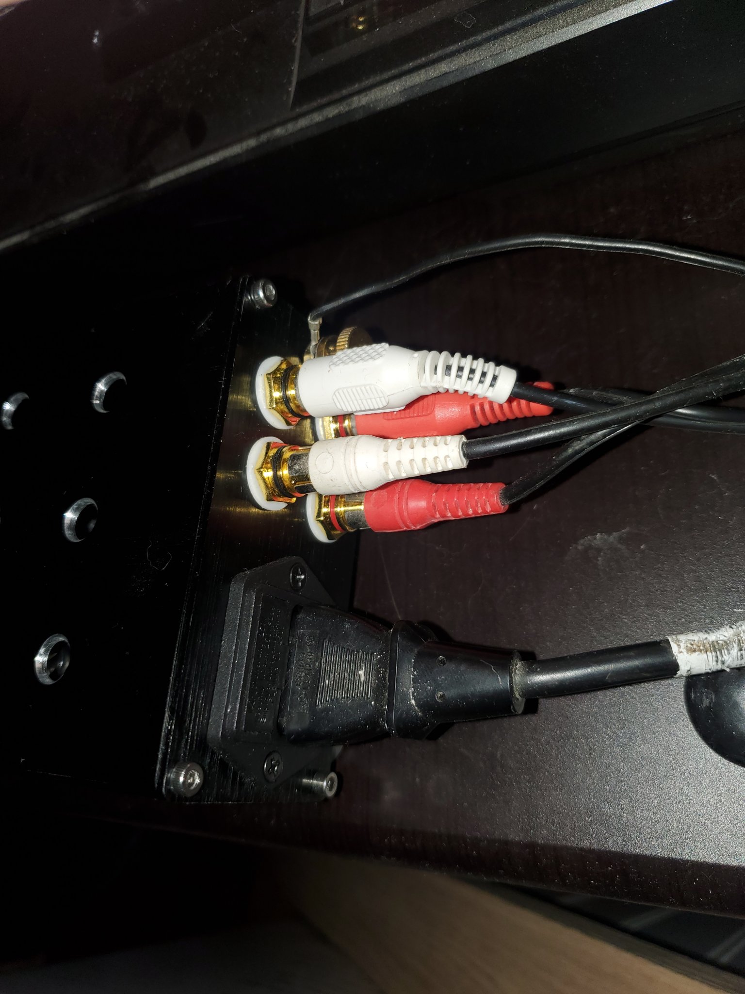

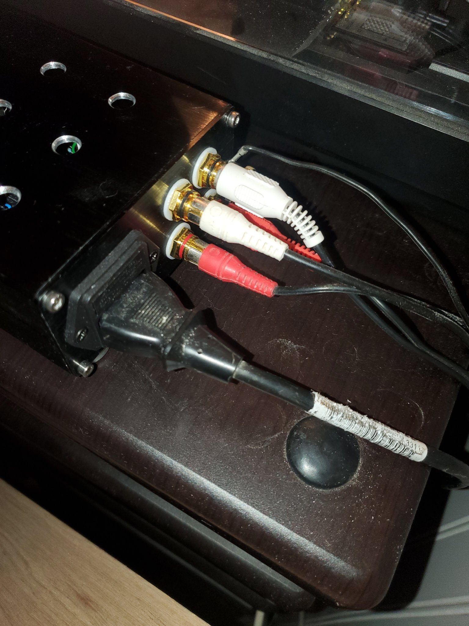

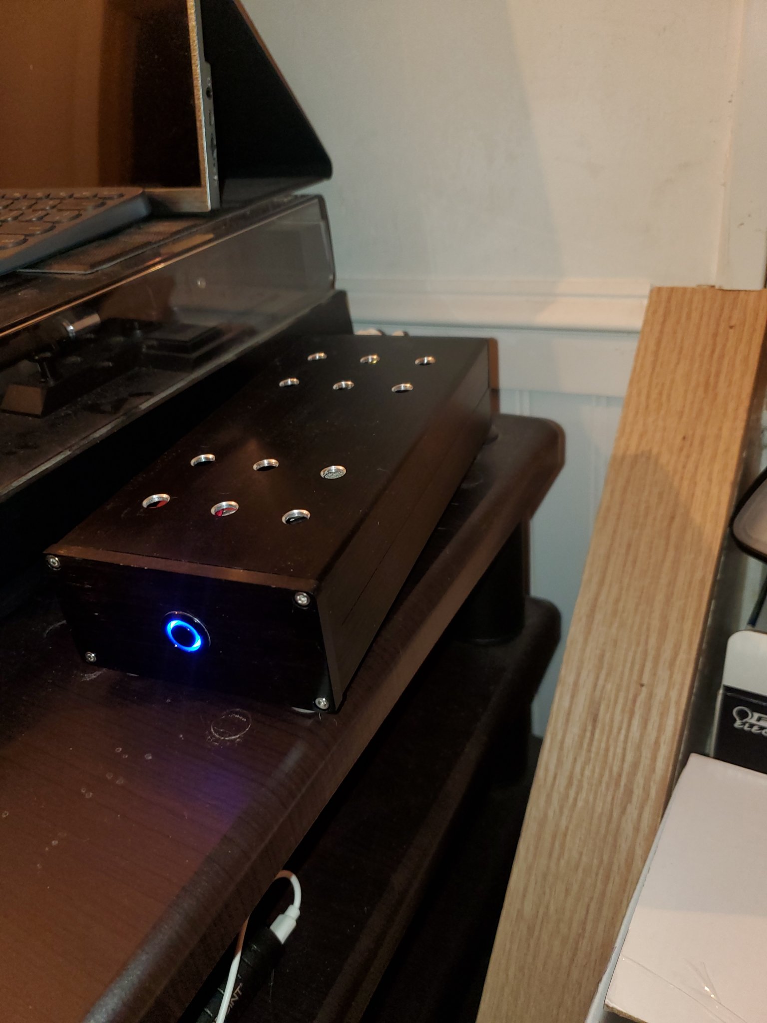

Dead silent, clean and clear. Not the end all of phono stages of course, just an easy, cheap, and quick one! ZERO hum!
More information please! I have 4.5"x2" to play with, and it looks like you have all the plugs on the skinny end, which would give you 1" sq. less room than I'm considering. Photo of the business end? Topside?This is built around the VSPS (very simple phono stage) from Phonoclone. I wrapped the Trafo and signal wires with Faraday tape, it's compact, actually tight inside, and has zero hum, dead silent. Chassis is 8x4x2 inches.
This faraday tape?
Do a search for Faraday tape or mu metal tape, the stuff i bought from Am*z*n is a metal thread woven fabric, with a backing that needs to be peeled off. Not the most fun to work with. Rayma is correct though, cramming the trafo right next to the board wasn't the wisest choice, but it's the one I made, because I wanted it compact, and I got away with it. Of course it may be that the VSPS is pretty stable and forgiving. Many will build the psu in a separate chassis with an umbilical cord, more work, another chassis, but it elevates your chances of success (no hums). Be careful, good luck, and have fun.
