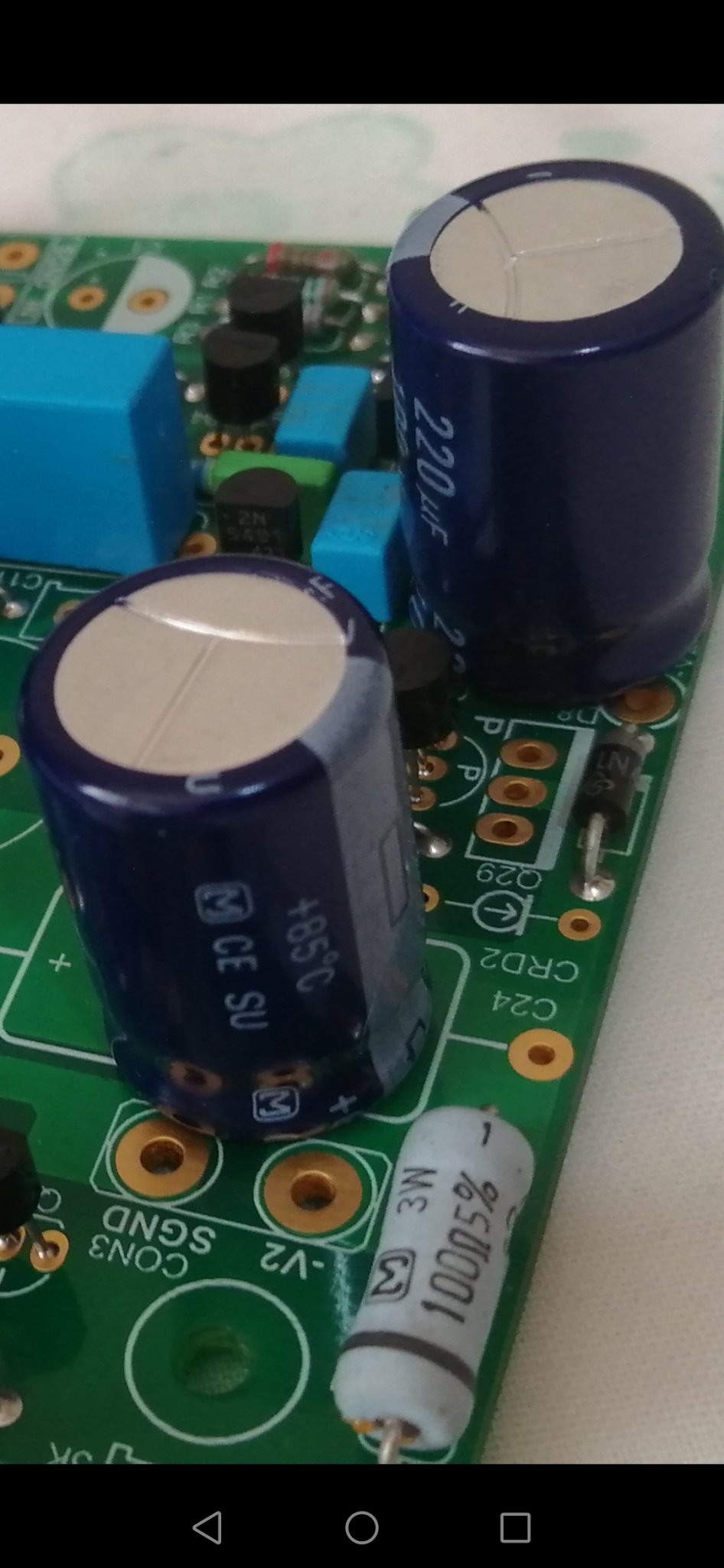

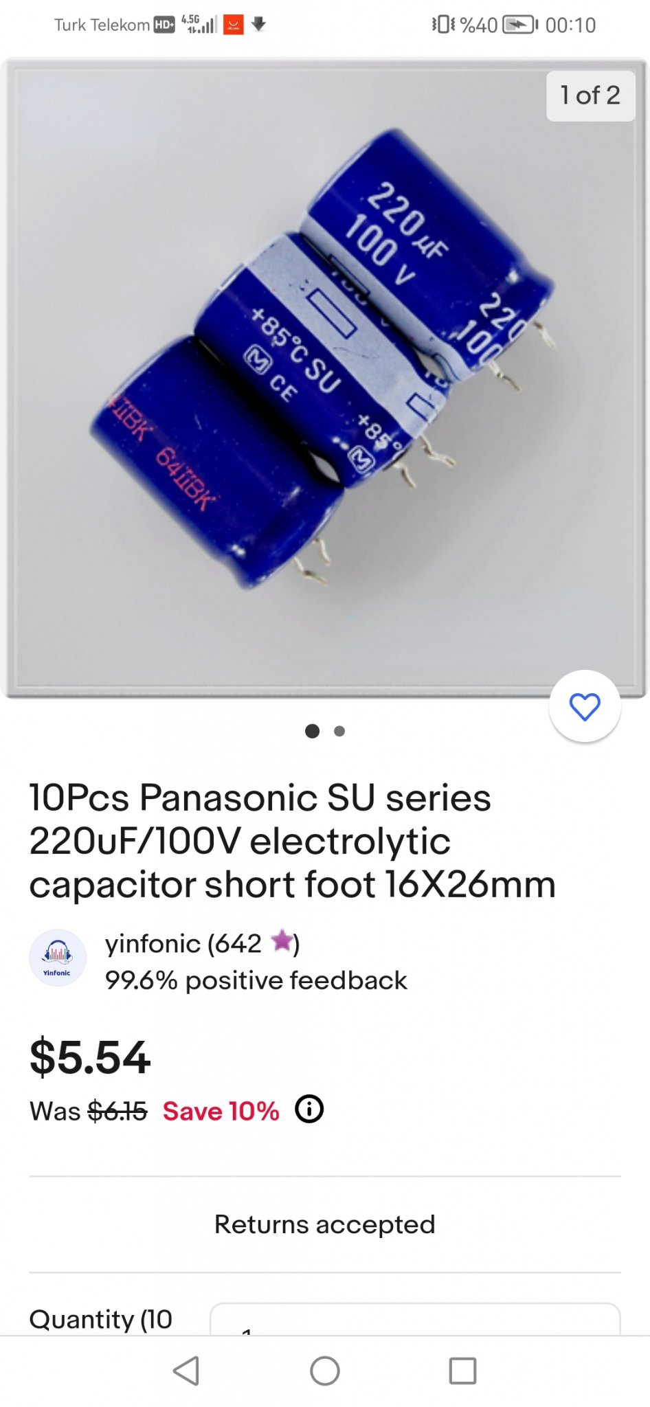

I searched a lot and couldn't find any information. Can it be custom made?Panasonic SU capacitors are Bi-polar but the capacitors in the pictures are clearly polar. The max. voltage in the current SU range is only 50V. So are these 100V SUs fake?

I found this on ebayWondered the same thing myself, but everything that I could find had the polarity markings. Could not find anything from Panasonic that showed one way or another.

100v 22uf Panasonic su

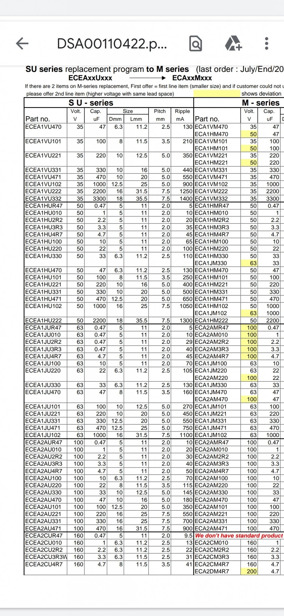

I found the manualI think the tell might be that the part is marked with the series number of a bipolar part, but the polarity markings are still there. The cap is also suspiciously small for a bipolar cap of that value and voltage rating.
Su series manualPanasonic SU capacitors are Bi-polar but the capacitors in the pictures are clearly polar. The max. voltage in the current SU range is only 50V. So are these 100V SUs fake?

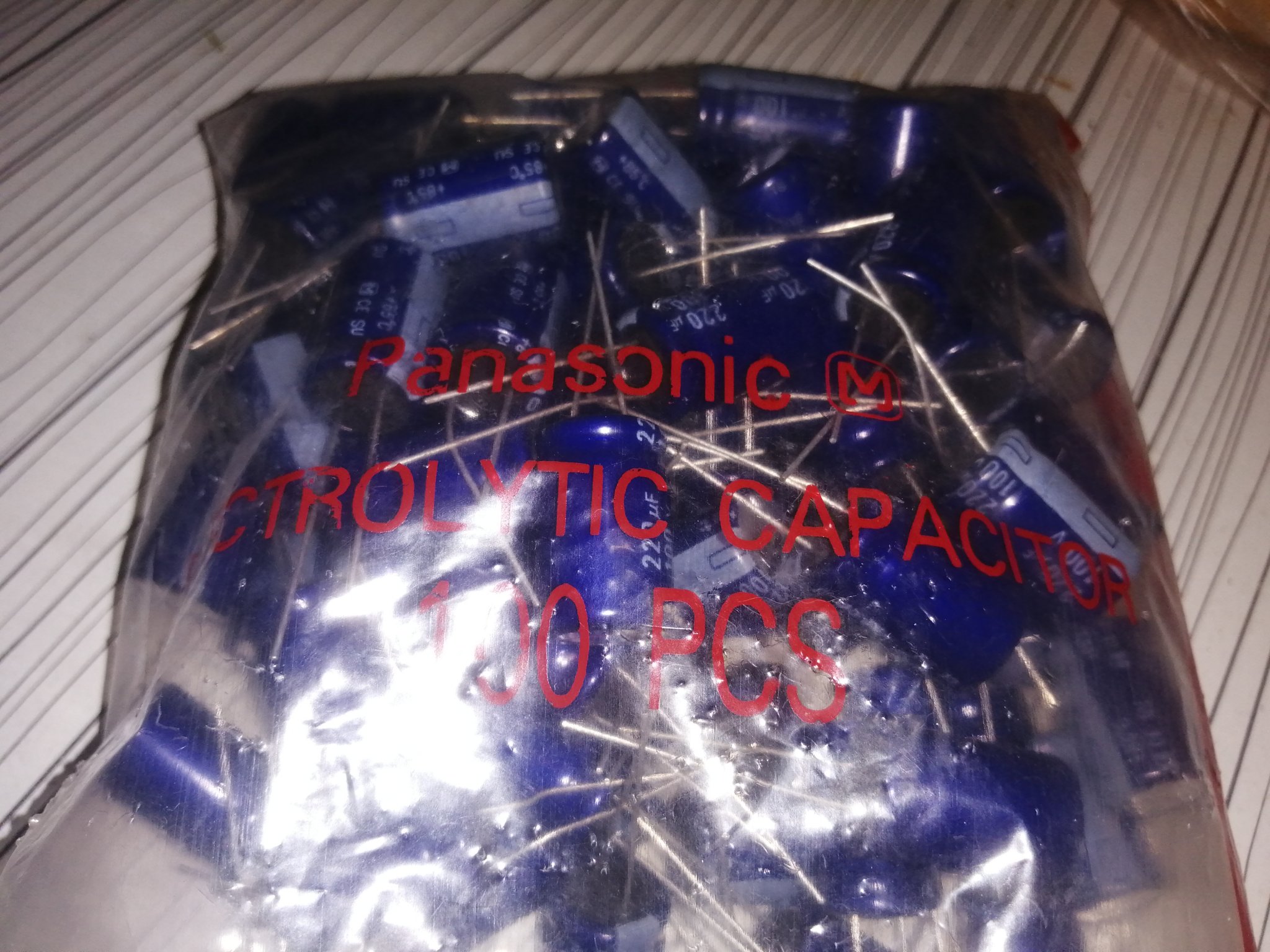

They were likely on E-bay because they were old. Last time buy in 2000. This type of capacitor can degrade if it sits unused for 20+ years. Not always, many times they are quite useable but you do take your chances. OEMs usually will NOT. I’ve bought plenty of old Panasonics and Nichicons surplus over the years and they have always worked. Even as old as 1979 - the only way I could get 470uF/50V axials. Still good as new. I’ve bought old Philips, CDE, and Illinois and had a mess of goo leaking out in the bin after a couple years and had to throw the entire lots out.
Even regular distributors will lower the price on old lots. I ran into 22000uF 50V Panasonics that were on the shelf for 6 years at Digikey, they marked them down accordingly, and I bought up a bunch. Nothin wrong with ‘em. Probably be 20 years before I use them all up, too. I do store all of my components at controlled temps - in the air conditioned portion of the shop rather than up in the rafters where it gets to be 110 or 120 in the summer.
