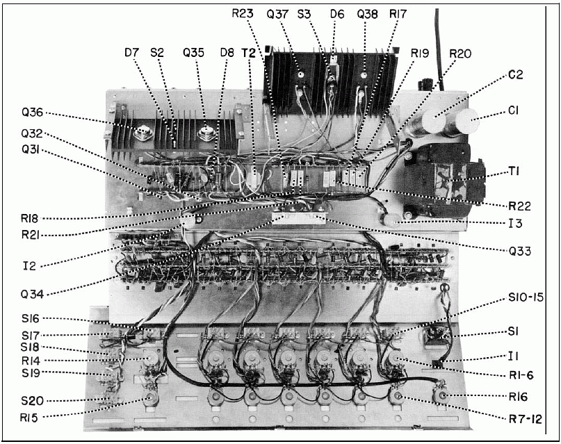

Nice to know for those who are iron intolerant so they can take adequate precautions, but practical fact is that iron path goes from a lot of aluminum foil wound inside the cap to nice wide copper tracks on the PCB or nice copper wire and net iron path length ends up being a couple mm.
At least for radial cap, the overwhelming type in use.
Unless it´s a true terminal strip PTP construction (haven´t seen many since the early 60´s) or an eyeletted board Fender amp, not really representative of amp construction for a few decades now.
Can´t believe such a tiny iron path can have any influence on sound.
Ok, an axial cap (not that popular these days) can add up to 5/10mm on each leg?
No big deal, I bet even Lab instruments can´t find any significant difference in amp performance and an impossible task for any ear involved.
On a double blind test at least.
Shure Vocal Master 1968, PTP built on terminal strips, a technique where parts lead length (and maybe material) is at least visible.
Not so sure about performance damaging.
Recommended period correct fashion for those who insist on PTP building on terminal strips.
