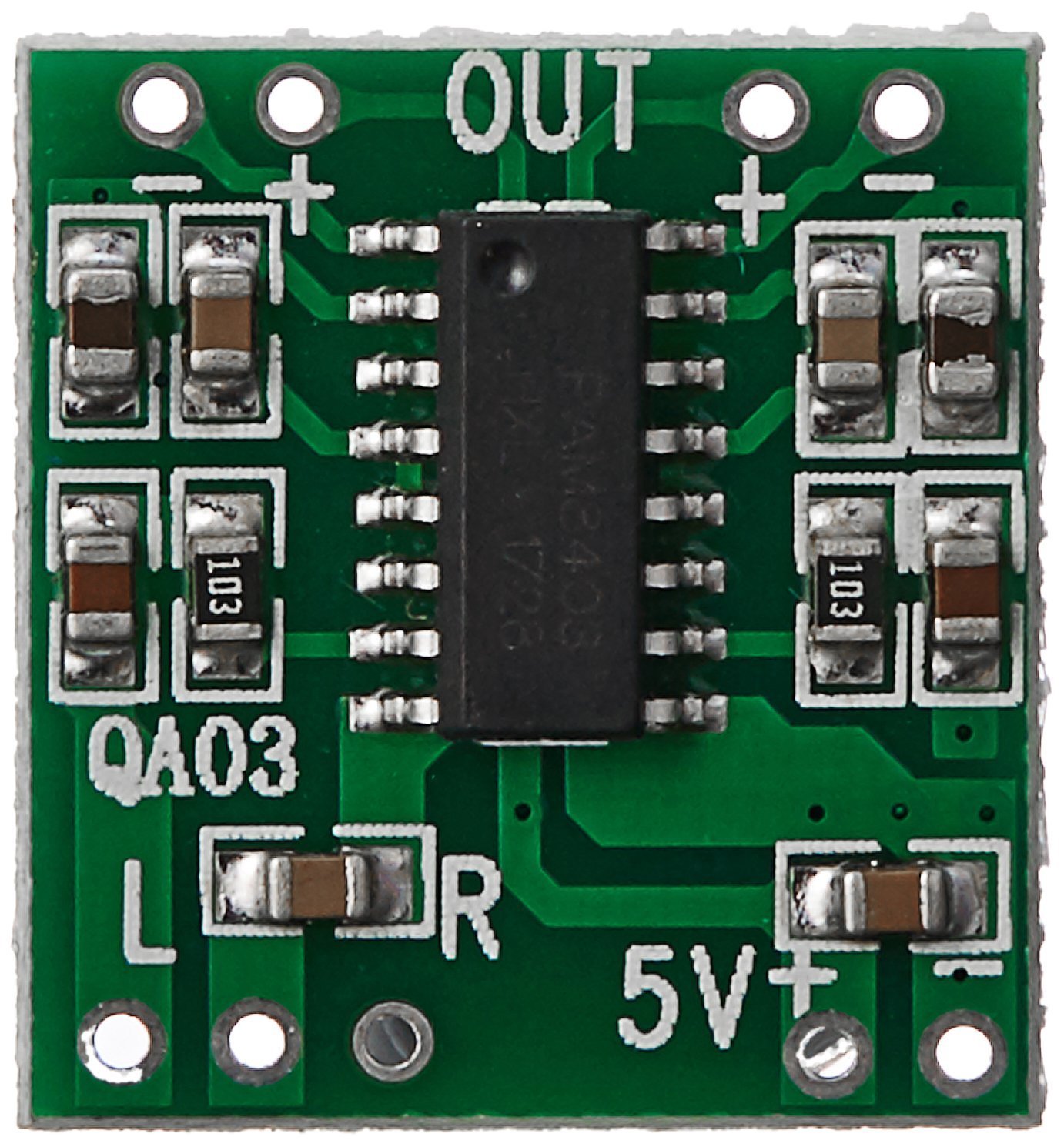

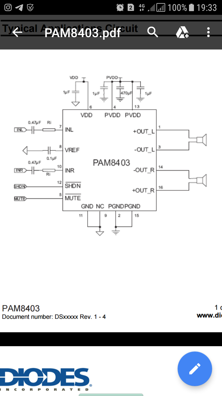

Is anyone knows how is the pam8403 output waveform?
Can we get spwm wave of this module when we don't connect lc low pass filter?
My idea is get spwm from this module and send that wave to another half/full bridge to get high power.
What do you think about it?
I attached pam8403 datasheet.

Regardless if your idea will be fruitful or not: you better use PAM8406 as it simply is a better version.
You'll inherit the poor distortion figures of the PAM8403/6 doing that and lose the protection features, but its perfectly possible and you don't need to know what the waveform is, just pass each wire to a half-bridge to buffer it, so 4 half-bridges are needed for stereo bridged topology.

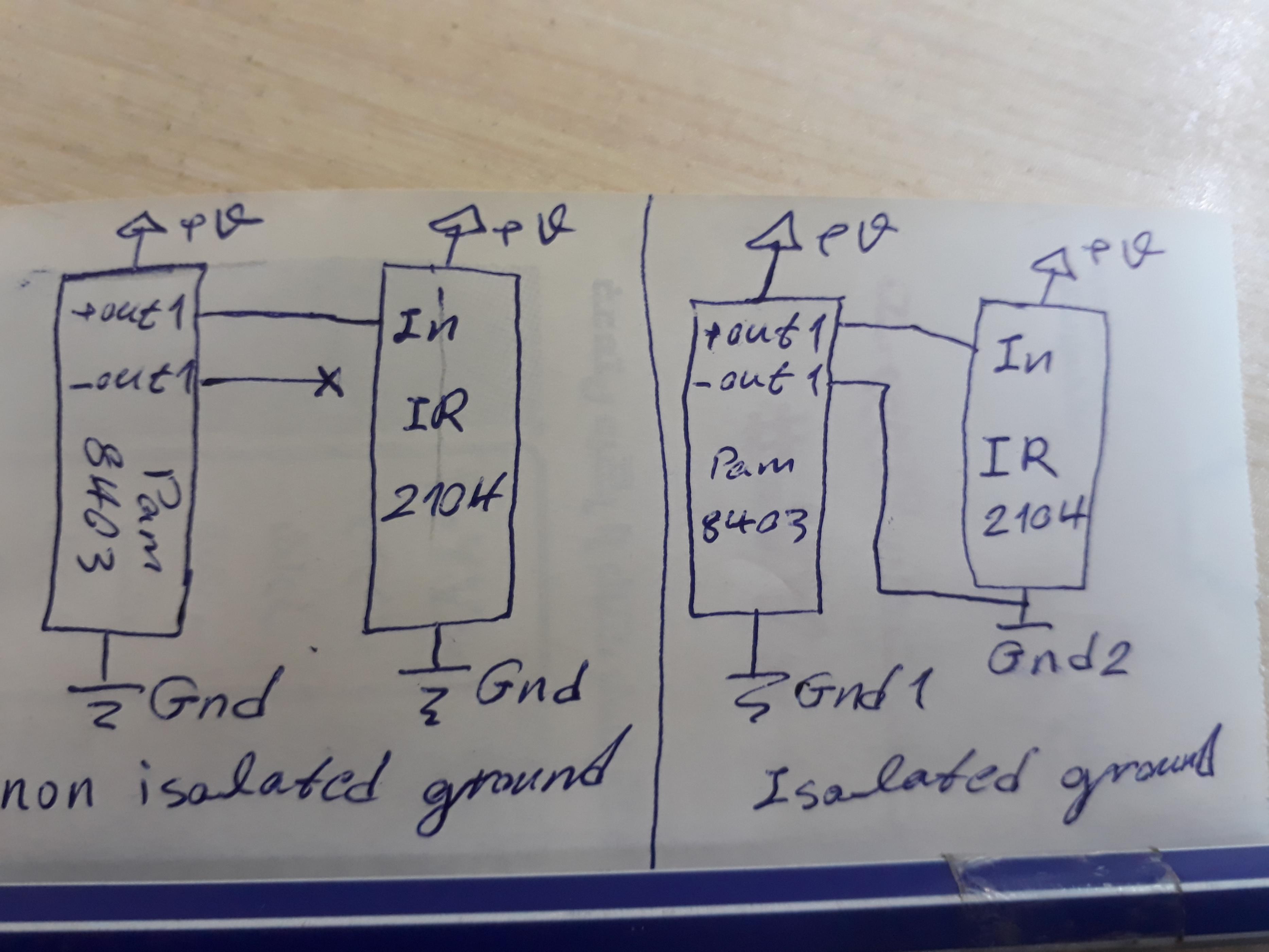

The problem is sound output's ground connecting.
I think Pam8403 have isolated ground for outputs
In this type how connect pam8403's output to halfbridge's input?
Driver of halfbridge need ground and input signal
I attached two diagram for connecting pam8403's output to (ir2104+irf540)halfbridge driver.
And
If the pam8403's output wave is any wave except spwm,my halfbridge don't work.
If the output wave is sine, my amp will change to class ab!
If anyone have this modules please test output wave in oscilloscope to i see(with 0% and 50% of volume to see changing dutycycle)
