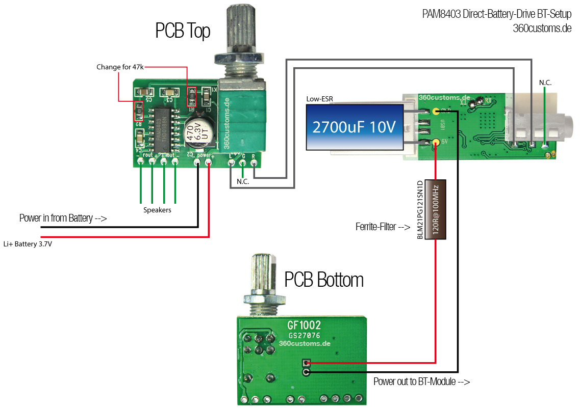

This little amplifier has a great sound until you get about halfway up on the input gain coming from your device. whether it is a phone or ipod, etc. It seems that the more dynamic passages of some types of music that are not highly compressed yield square waves and distortion to the output. given the nature of how this is somewhat predictable, would it be possible to put a resistor at the analog input of some value to decrease the input gain across the board no matter what the input is from?
if so, what value do you suggest?
I remember that i changed the input gain resistors to 47k, as the amp where running to loud with this BT-module.
See attached image for reference.

wow! thank you very much for the help. i can see by your picture that the board you were using is labeled properly also. the one i have right now is not.
i had not seen a ferrite placed there before. interesting.
also i was planning on using a 1uF and 470uF and 1000uF in a stack where you have just one 2700uF filter on the input Voltage. I was basing that on the PAM8403 datasheet and also some reading of hifi preferences for a grouping of 3 caps for this filtering. Do you think that would pose any problems? totally unnecessary?
I see. thank you, Dr.
