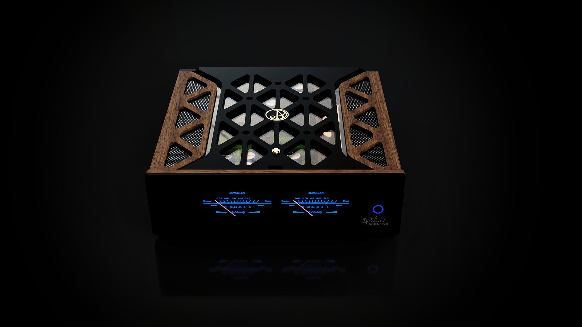

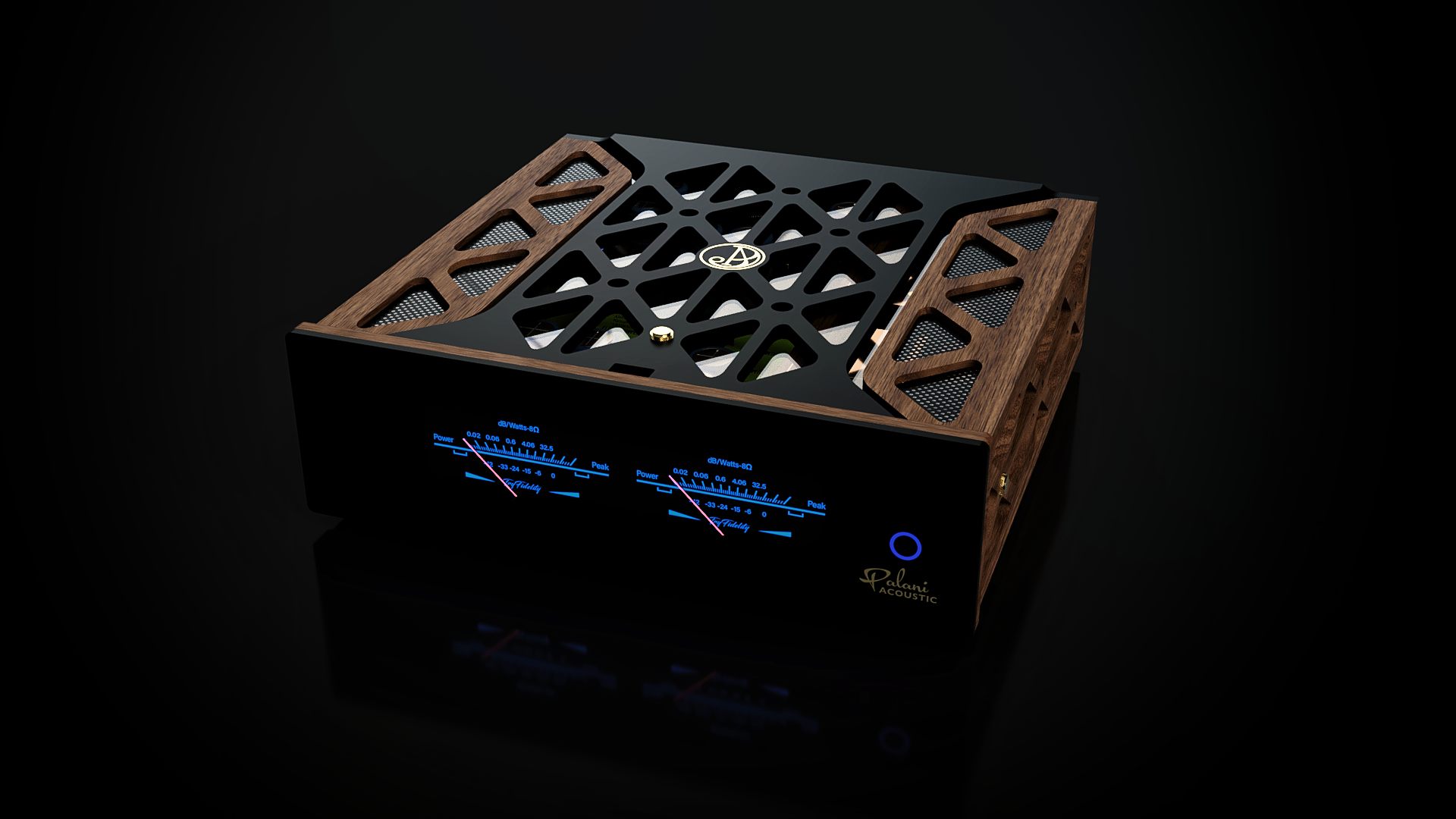

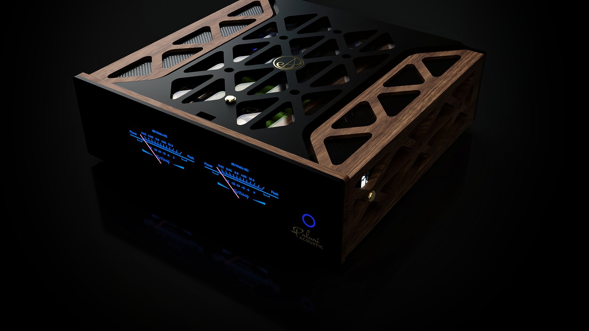

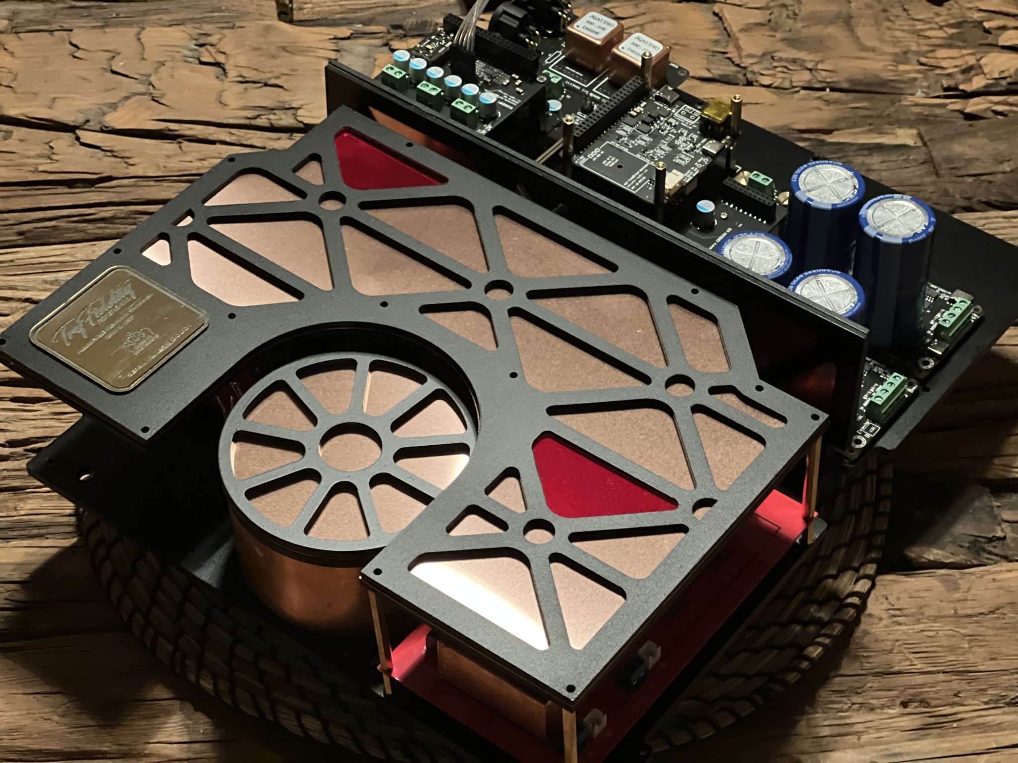

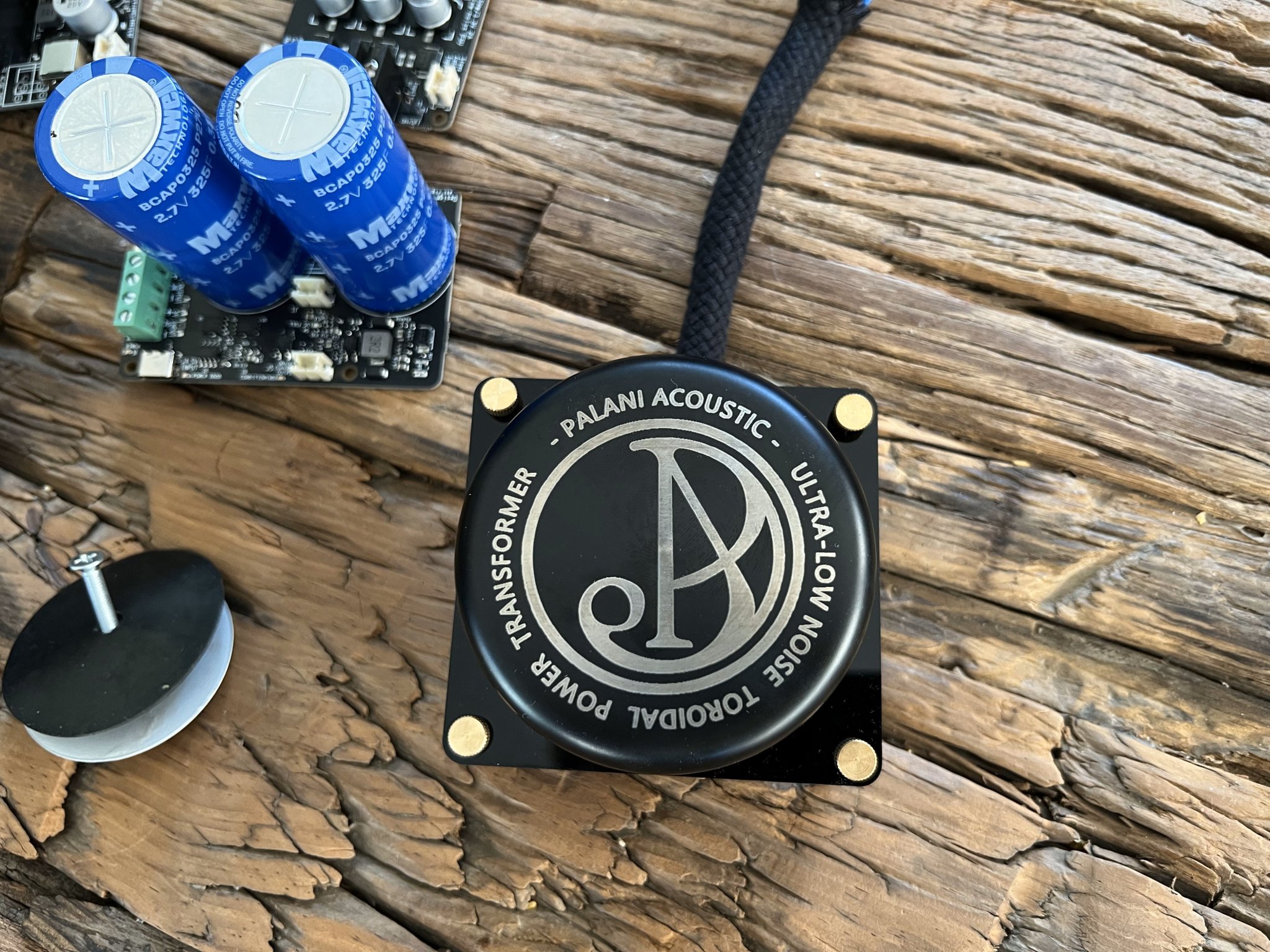

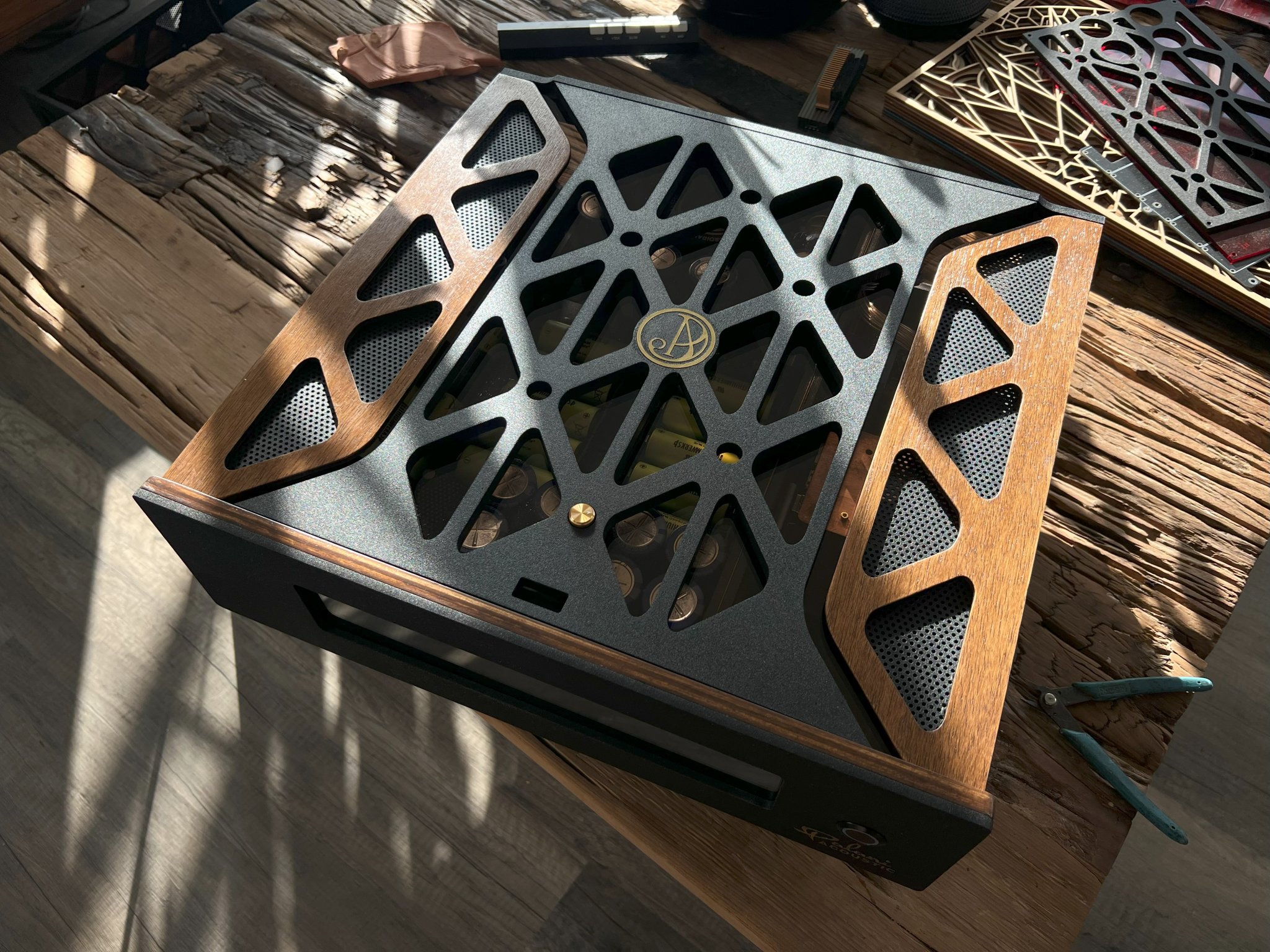

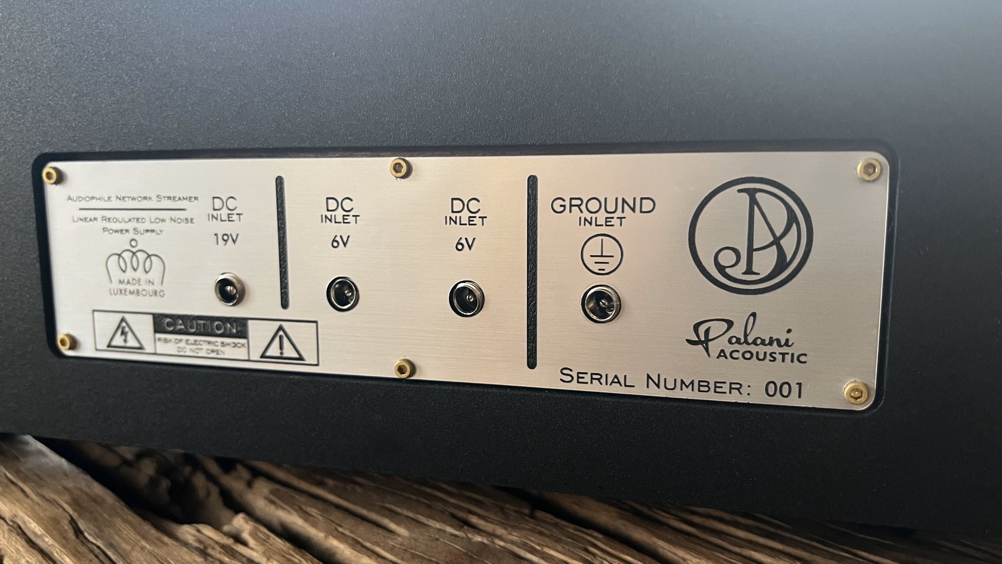

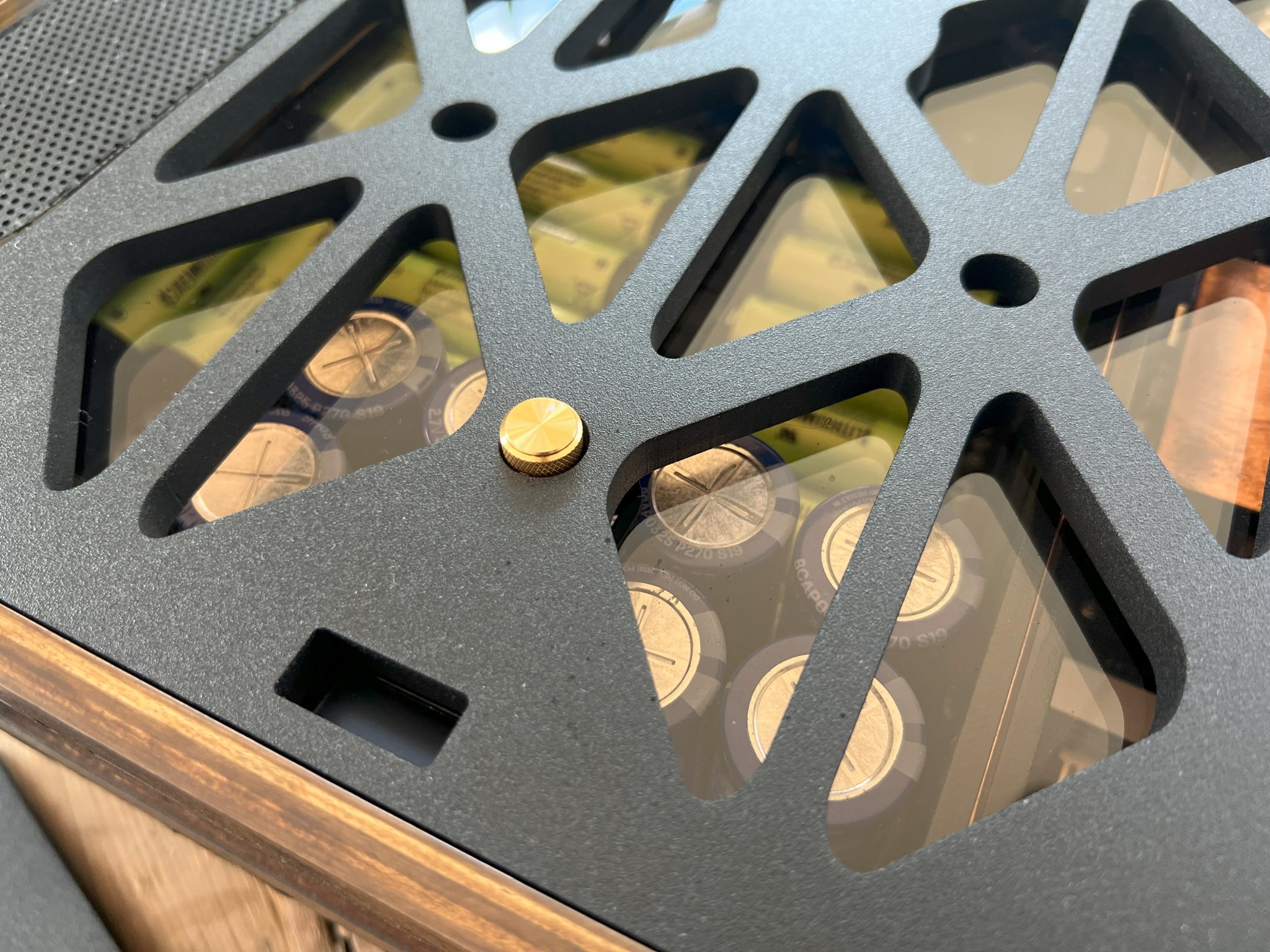

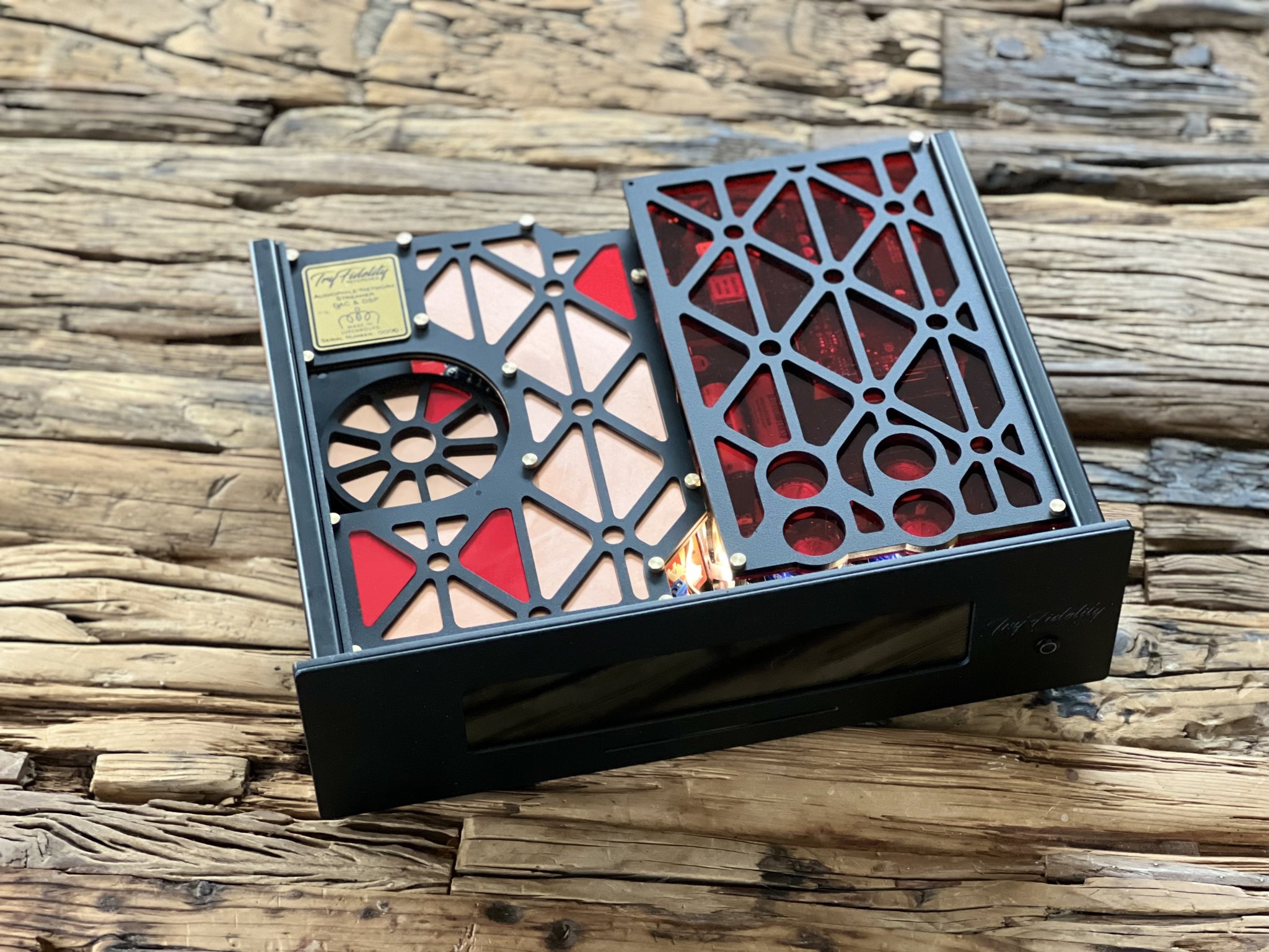

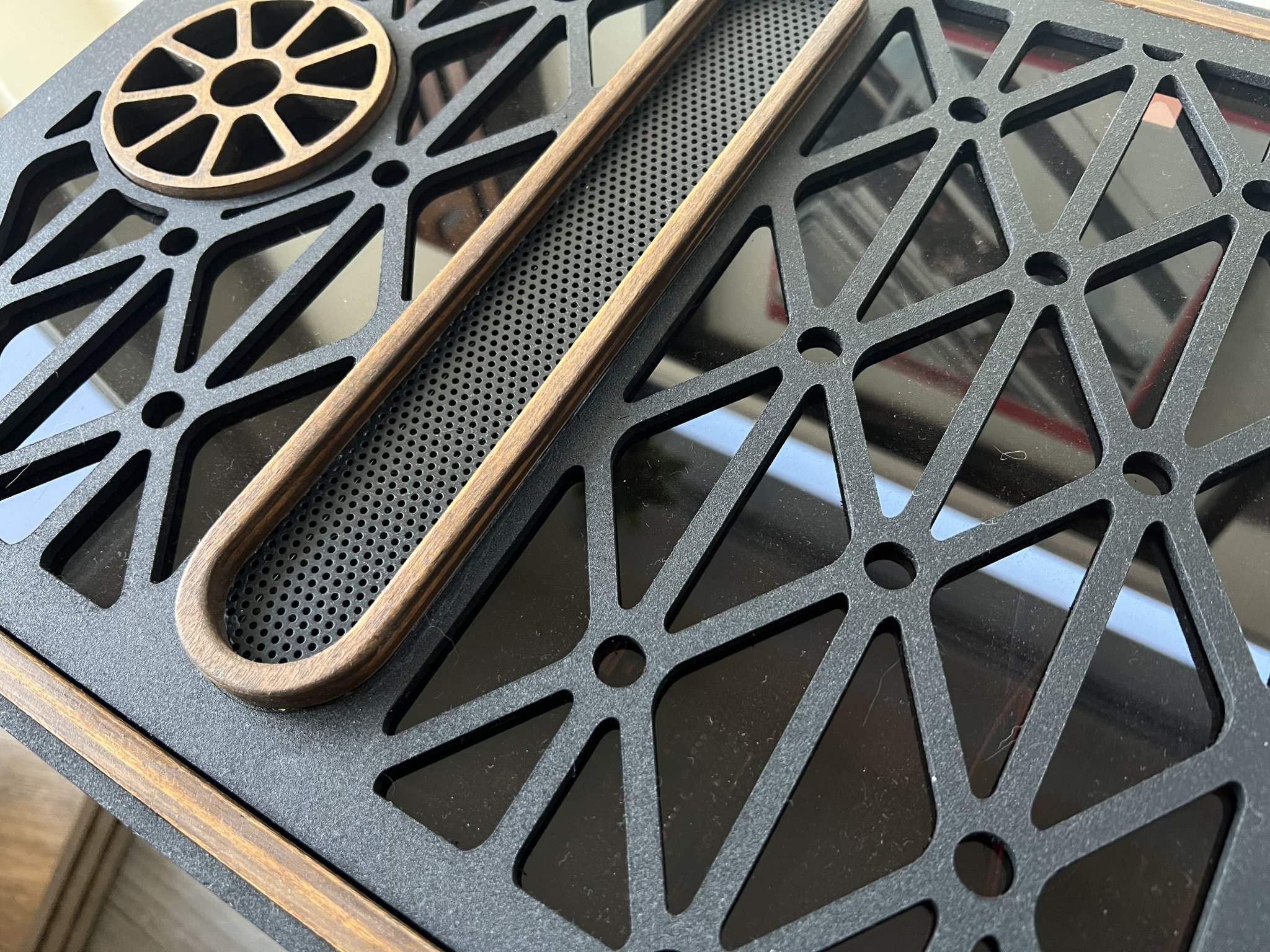

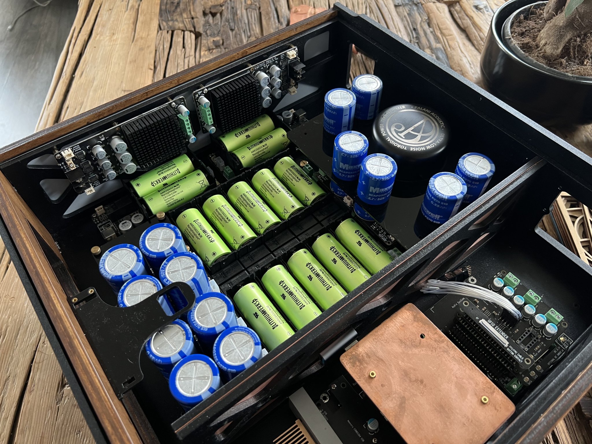

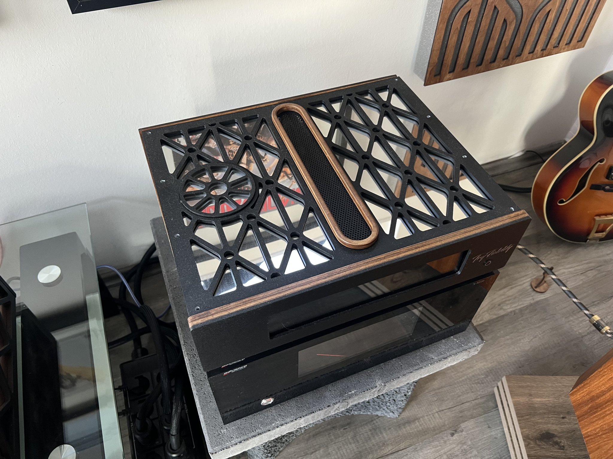

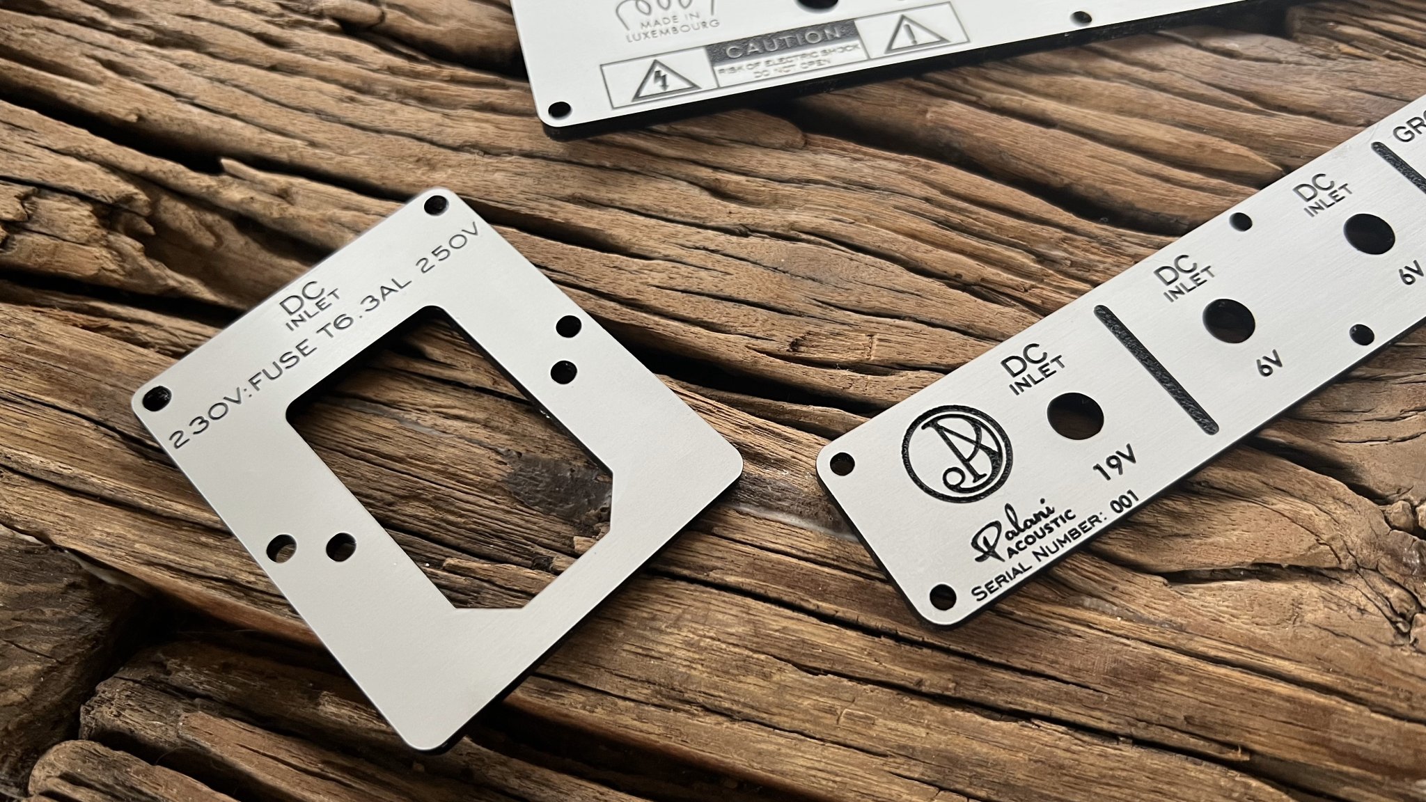

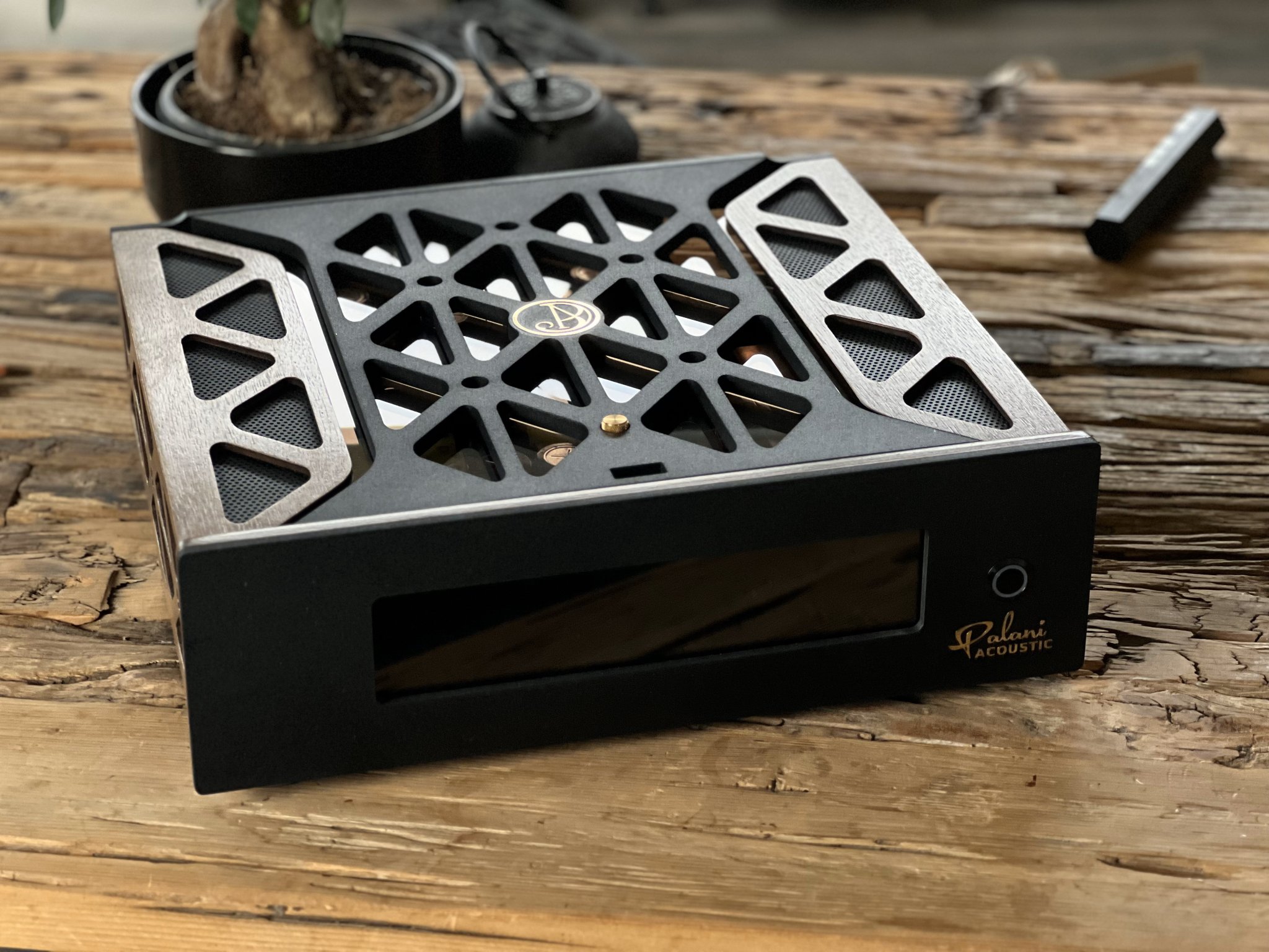

I wanted to show you my self-made streamer and DAC, which is built with Ian Canada components, and a few other things that I have developed myself.

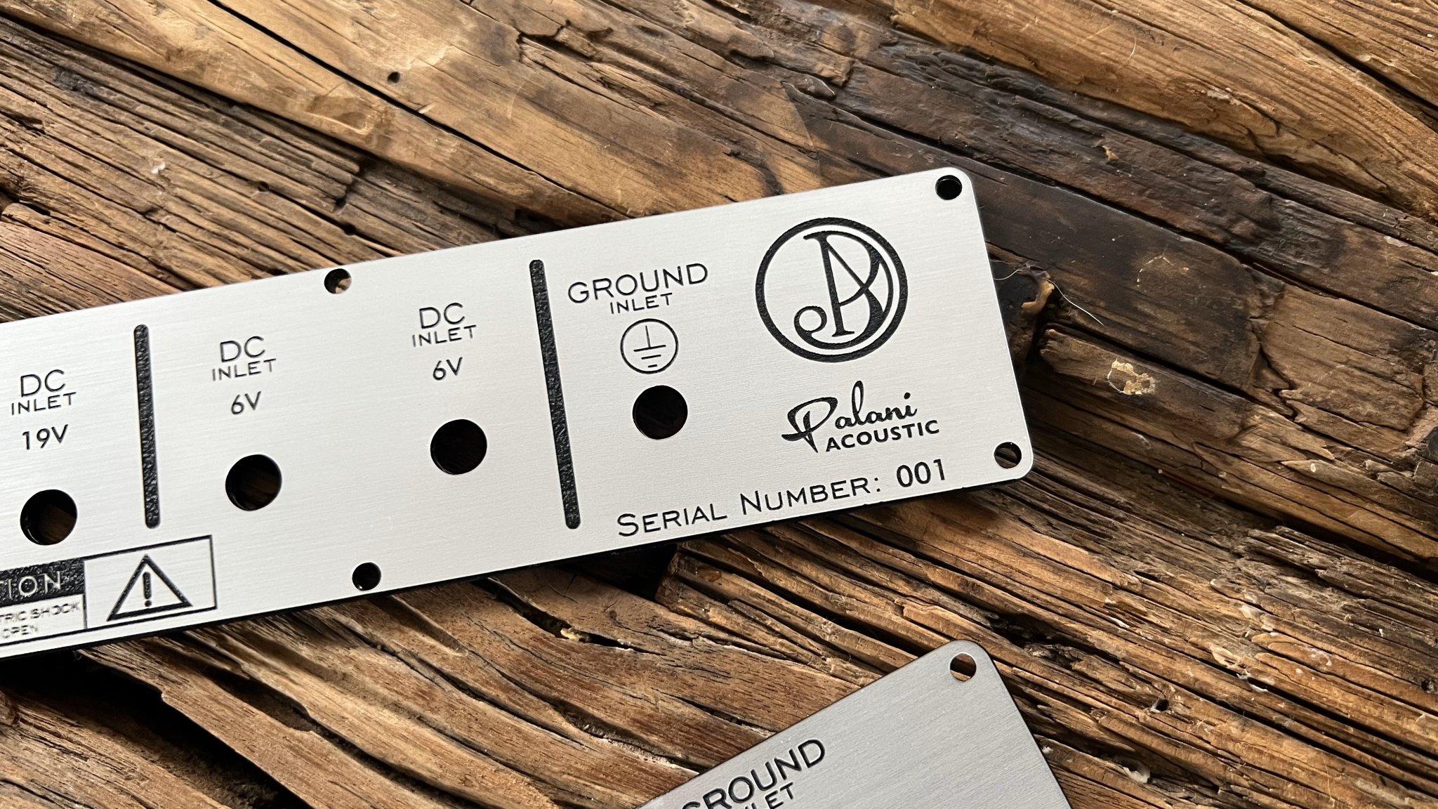

above all i have been working on the cabinets, which are completely designed and manufactured by myself
This is now my fifth version, and has now been split into two cases, one case with the dirty power supply, a display is also built in, with which the actual streamer can then be controlled.

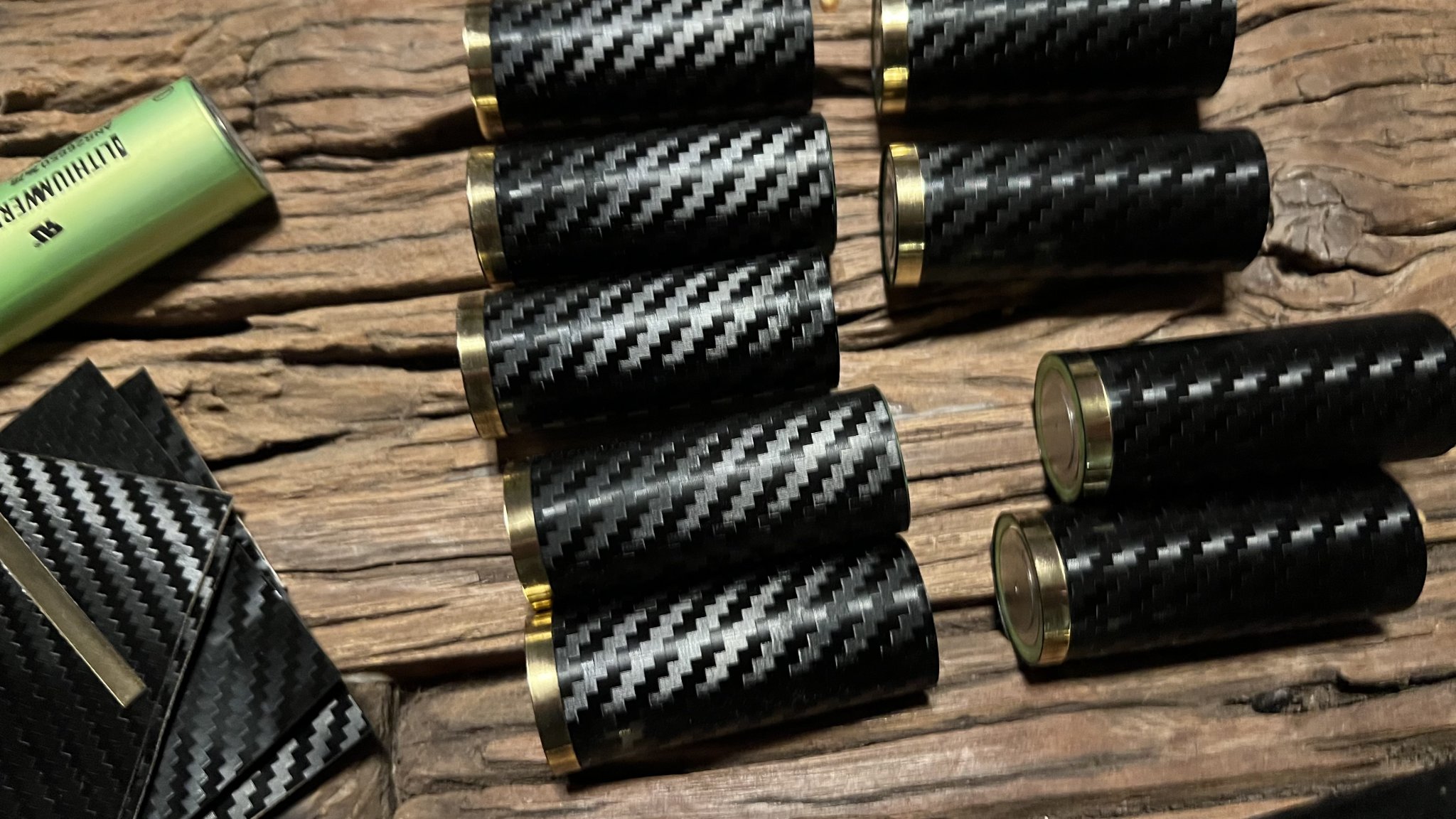

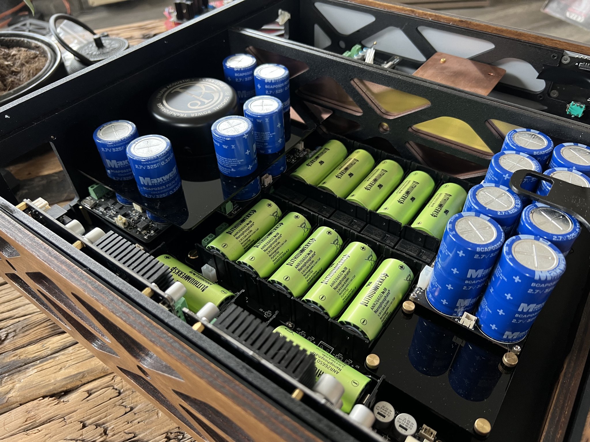

Everything is built like a power tank, the audio part runs completely on LifePo4 batteries with Superccaps, and can listen to music for a few hours with the best ESR values...
The complete structure is in dual mono, from dac 038Q2M dual mono DAC HAT is a very high quality DAC for Raspberry Pi. It uses two ES9038Q2M SABRE 32-bit chips, each operating in mono. The entire power supply is also dual mono. Each part has its own power supply, via LifePo4 like 325 Farad supercaps.
Still under construction; and I still have to finalise a few things

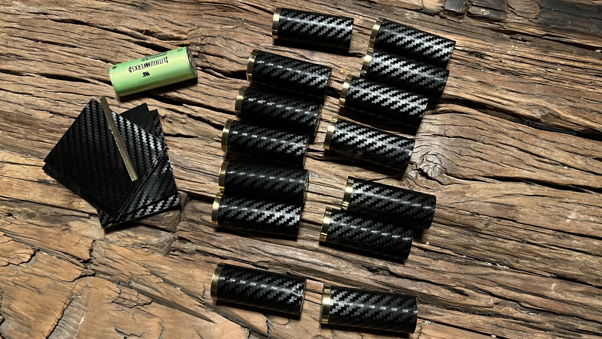

carbon and gold strip as plus indicator
Just curious: is this fpor optical reasons or is this funcional
